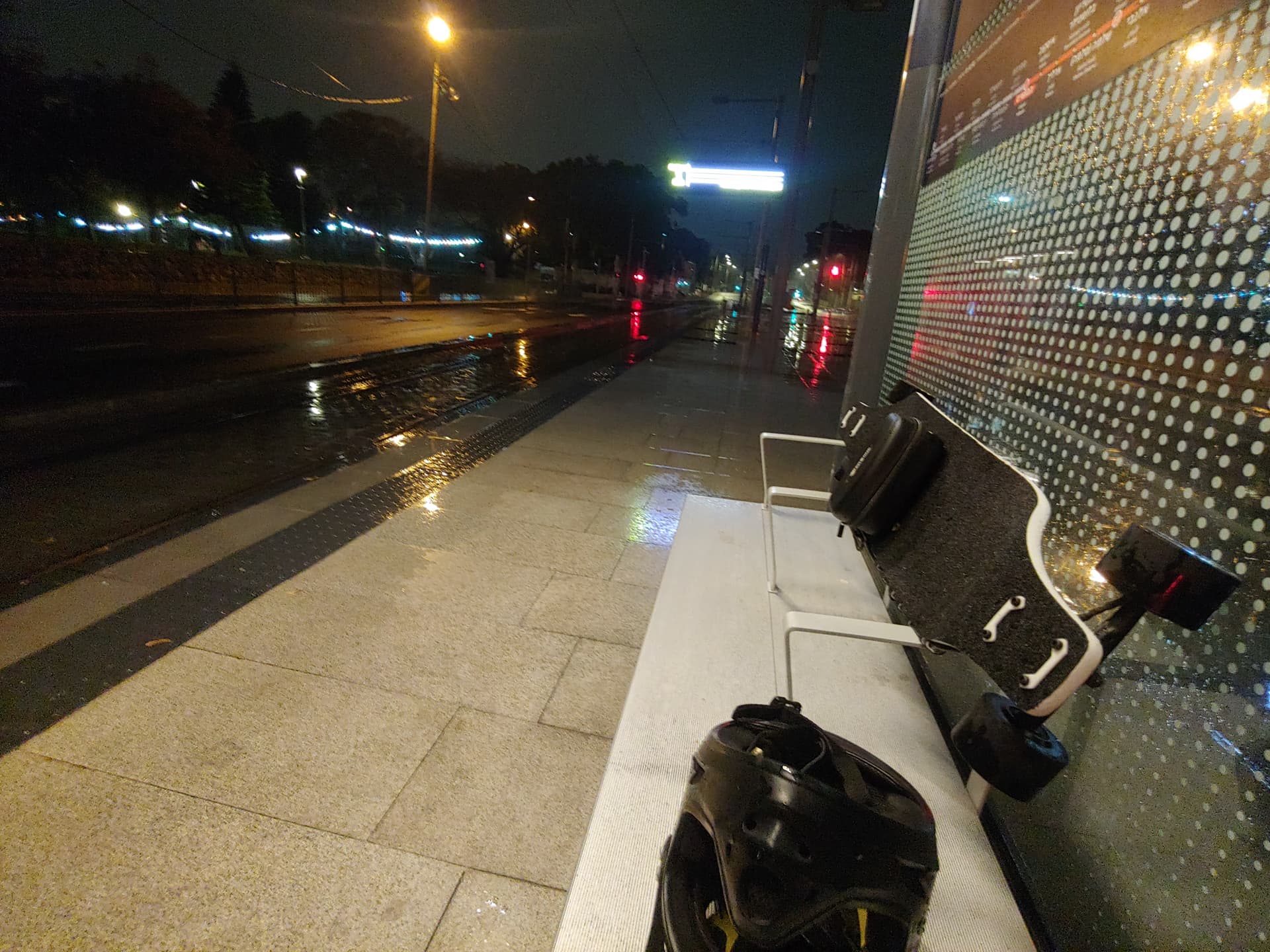

I saw the roads dry so i went for the first test ride.
Works perfect, smooth, silent, torques for days, 8wh/km average consumation.
Well, started raining out of nowhere and now I’m stuck under a bus stop x)
start hydroplaning on the water and you’ll really be esk8 jesus
I’m working on a miracle right now
Back home in one piece and the board too, it stopped raining the same way it started, and I walked back home carrying the board like I would an analog one.
Was a bit scared the cable attaches wont hold, but they did, everything seems fine.
Made me realize the board is pretty lightweight, the only scale I got is a kitchen one and won’t go over 5 kg, but I think the whole thing is under 8kg
I’m pretty happy with the few km I had before it started raining, was realy smooth, was expeting the worst out of hub motors, siper silent, and lack nor speed nor traction
Just went for a 11km ride, the battery wasn’t at 100% to start with and it’s still arround 3.65V/cell which is quite satisfactory on a 12s1p I think, didn’t expect to get that much out of it.
The hubs and rigide deck makes the ride a bit more bumpy that what I’m used to on my analog board, but it could be way worth
I’m happy overall
