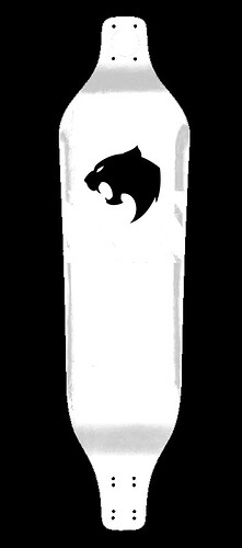

Deck degripped and cleaned !

Filling underway, took me a good quarter of the board to get the gnak of it, I guess I will have a fair amount of sanding to do whatsoever
While I’m waiting for it to dry, let me find out some nice graphics
1
2
3
4
  • 1
  • 2
  • 3
  • 4
0 voters
shit, didn’t mean the poll to be private, now I’ll never now who voted for what xD
I voted for the cat one. :stuck_out_tongue_winking_eye:
@longhairedboy where is the cat emoji, lebowski ?
Now u will never know what I vote for
2 looks too similar to the Roccat logo
