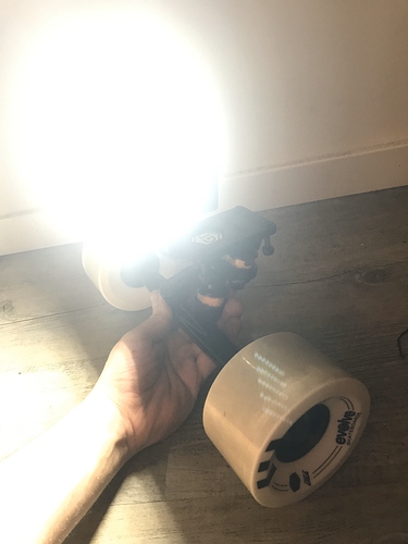

Headlights: DSLR flashlight mounted with a 3D printed GoPro mount

My plan was to mount the light with the gopro mount but it didnt hold as u see so i downloaded 3d model and ill get it printed but i have to tell u, the light is BRIGHT

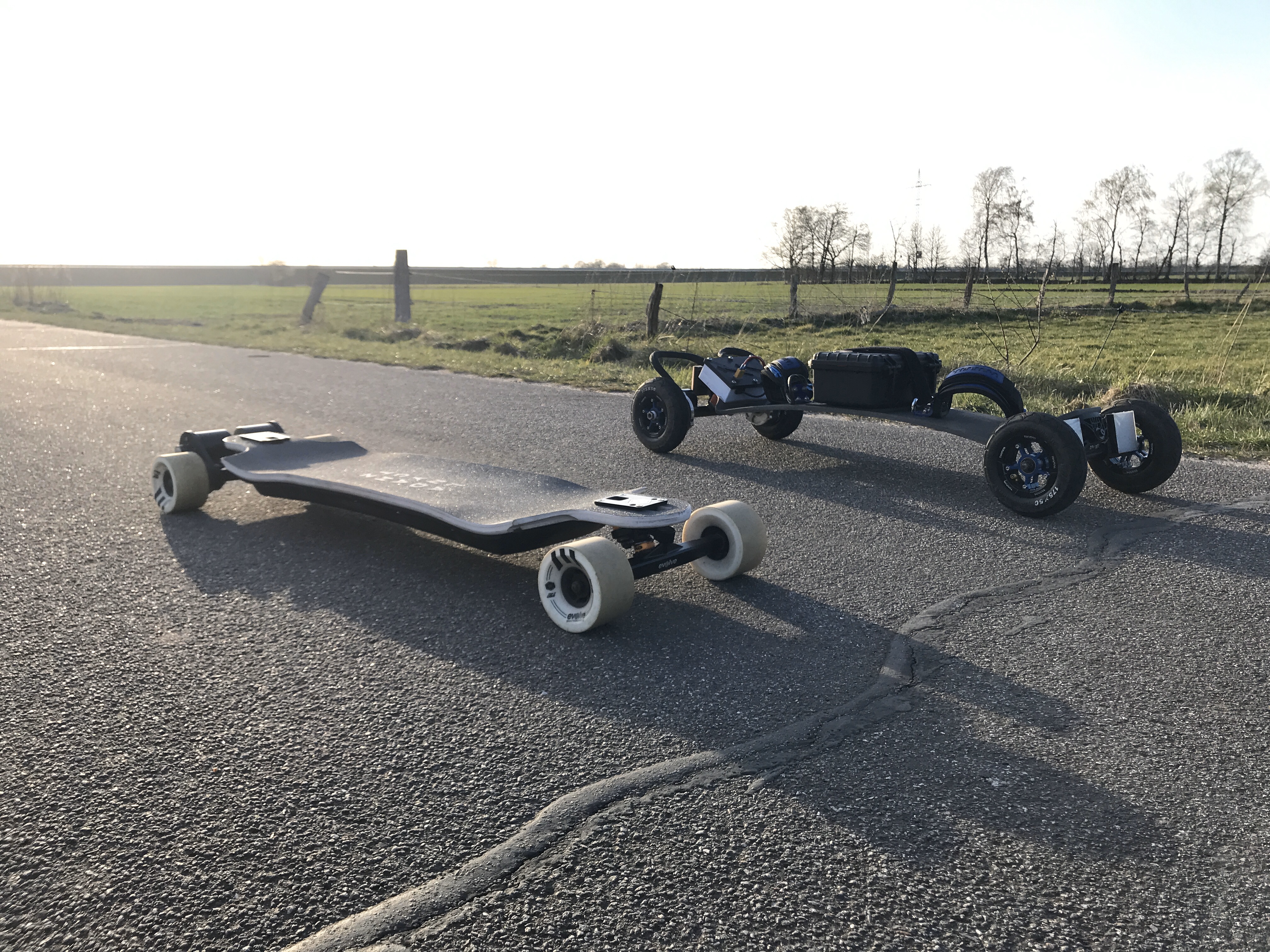

And the board was finally done so i immediately took it out for a spin with my friend so enjoy the pics…
I have to tell you, in comparison to evolve, boosted or any mass produced board, this thing is a ROCKET, it is so responsive and has more torque than i thought (i was scared that 14/32 2.28 gear ratio was not enough) and the speed is astonishing, and the deck is just on another level i have no idea why almost no one uses it

I just finished a ride with some friends, we rode about 15km, I started out with 3/4 full and now it’s only 1/2 full so round about 50-60 km
and the power is just unimaginable to the point that till now I didn’t have the balls to give it full throttle or came close to it’s full speed
