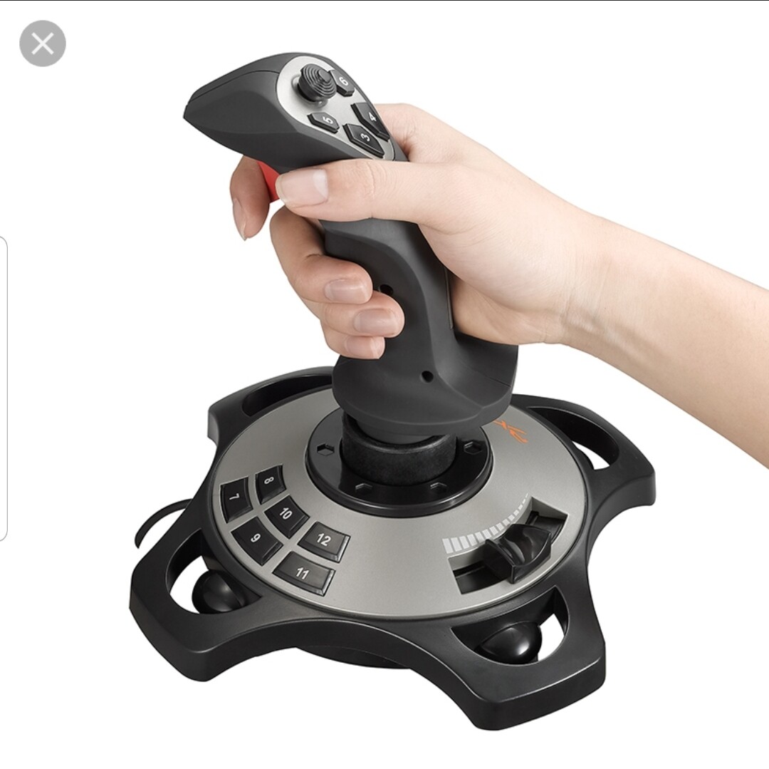

Most ergonomic shape would be a large 2 finger throttle trigger centered towards the start of the last finger pad (not the tip), long brake trigger at ~45 degrees off vertical.
Relax your hand in midair. Your thumb isn’t in line with the rest of your fingers (on top). The hand default position is with the fingers in a generally circular shape, with the thumb off to the side. It pivots most strongly from the base of the hand, not the individual finger joints.
We basically need a truncated flight stick. Aircraft cockpits and ergonomic computer mice are a great inspiration for this sort of thing.
I enjoy thumb wheels, but i don’t think that motion is ergonomic at all.
I was thinking something more like this (obviously not this, but in general shape). You would hold it and the wheel would be perpendicular instead of forward/back, thus using the natural rolling motion rather than pushing/pulling.
I wonder if I can find some already modeled joysticks and just bastardize them enough.
A side rotation wheel is better than a traditional puck-style wheel, but a down-press trigger is the ideal that matches your normal hand grasp movement.
Our most used movement is grasping things to pick them up. Moving your fingers side to side is more rare.

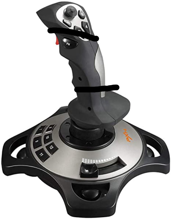

Using that same flight stick as inspiration;

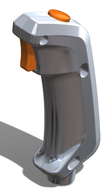

So, what if we staggered the thumb trigger to the inside of your grip, where the 2 button is on that joystick? Would that solve the issues while also possibly being even more comfortable?
I’ve had this thought in mind for a long time now, wanted to design it for a dual trigger remote but haven’t found one good enough to design it for
This one might be my opportunity, I had the concept in my brain already
I’m still waiting for the electronics and everything to be solidified though
Now that I’m actually thinking about the internals, it makes a lot of sense even without looking at the ergonomics(which are also good)

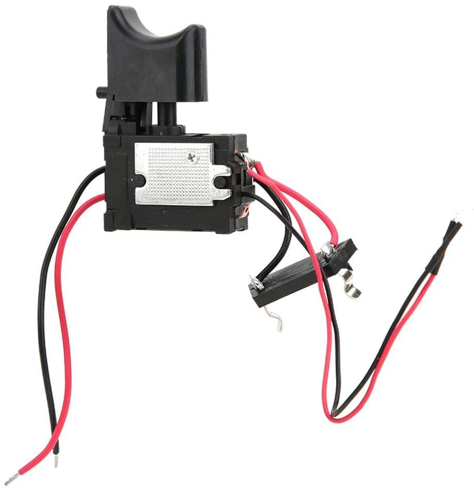

Which looks like it might work. The limiting factor in these tends to be the pcb, and the kinematics for the triggers. If there is an off the shelf trigger that can be bought, or even a linear switch, it would make life a lot easier. I don’t know what switch is used in handheld cordless drills, but that is pretty much exactly what I’m looking for.
Something like this. It’s cheap enough, but I don’t think it will play nice with the voltages we are dealing with.

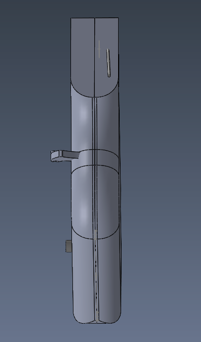

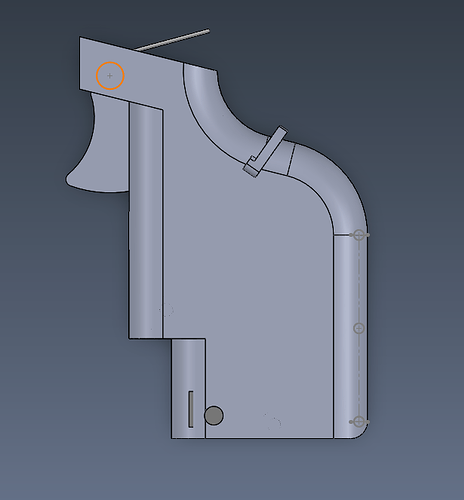

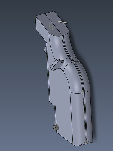

Slimmed it up, fixed the trigger. Is this what y’all were thinking about for a thumb brake? It’s obv not finished, but positioning and such.
if you ask me its done when the electric would fit just into the grip of this joystick. That would be awesome. I wouldnt change anything, even the knob like botom part could be a slide puck, and the upper front could get a flashlight. Button break with thumb. One button and or two button power brake
yeah, awesome.
This is EPIC!
Yet again another Champ taking things to a new level!
Said it before but have to say it again! ^ ^ ^
