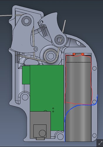

Thing is an 18350 would allow for a shorter remote. The cells are slim enough, but an 18650 is pretty tall compared to the PCBs.
18350 cells are also pretty cheap, I recommend getting a couple to work with.

Have you not looked at any of the screenshots I’ve posted? There’s is a negligible amount of length added by using a 18650 tube vs 18350. Feel free to design a shell that uses 18350 if you are that passionate about it.
I wouldn’t say negligible, it’s 30mm
If you look at this picture, yo can see that this
Doesn’t make any difference as the PCB it’s almost the same size as the 18650 cell. A shorter cell would not make the remote any shorter as you would also have to fit the trigger mechanism.
Edit: drawing of how awkward the shape of the remote would be if the cell was shorter:
You could make the corners a lot more rounded though. I still think a 14500 is ideal, but whatevs
Thank you for that. That’s what I was saying.
I also think a smaller cell would be better, i was just pointing out how a shorter cell wouldn’t make that much of a difference in size…
A smaller diameter AND smaller length cell does impact a lot more in total volume and confortableness (is that even a word?)

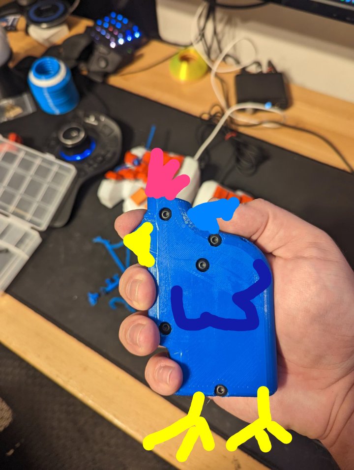

My concern is the brake trigger doesn’t look ergonomic; it looks like it involves the same unergonomic digit movement as a thumbwheel. The thumb pivots on joints and it appears this control might not be moving in that same way. Is this operated by “sliding the thumb forward” instead of pivoting the thumb joint? I haven’t held one yet, so I am only brainstorming here. But this is a big reason why thumb wheels suck IMHO.
I think extending the thumb trigger could make it more comfortable. Napkin doodle:
The bird feet make it go faster
This is actually interesting - are there any remotes period that have the wheel sideways? It would make ergonomic sense to, but I don’t think it makes intuitive sense.
