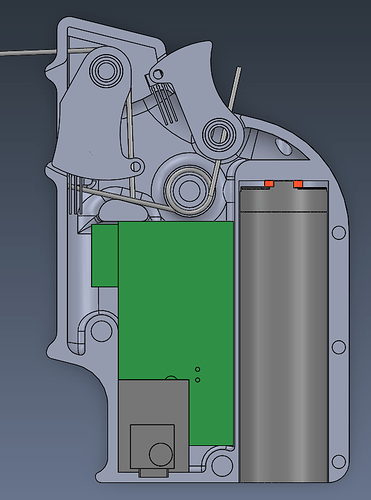

From this model, it looks like you designed it for a botton-top cell. Speaking as someone who has a shitload of flat-top cells and exactly zero button tops, I would strongly prefer support for flat-top cells :joy: and my guess is that a lot of DIY folks would too.
In my experience, button top cells are generally more expensive and less available than flat-top cells, as well as having a much more limited selection. Vape people might like their button tops, but I think PEV people are more likely to own/prefer flat-tops.
Plus, depending on the contact you use, it could easily support button AND flat cells. Just something to think about :slightly_smiling_face:

This is a commercial battery tube in the model. MM Battery Tube V2 (SS304/18650).
I’m guessing it supports both button tops and flat tops.

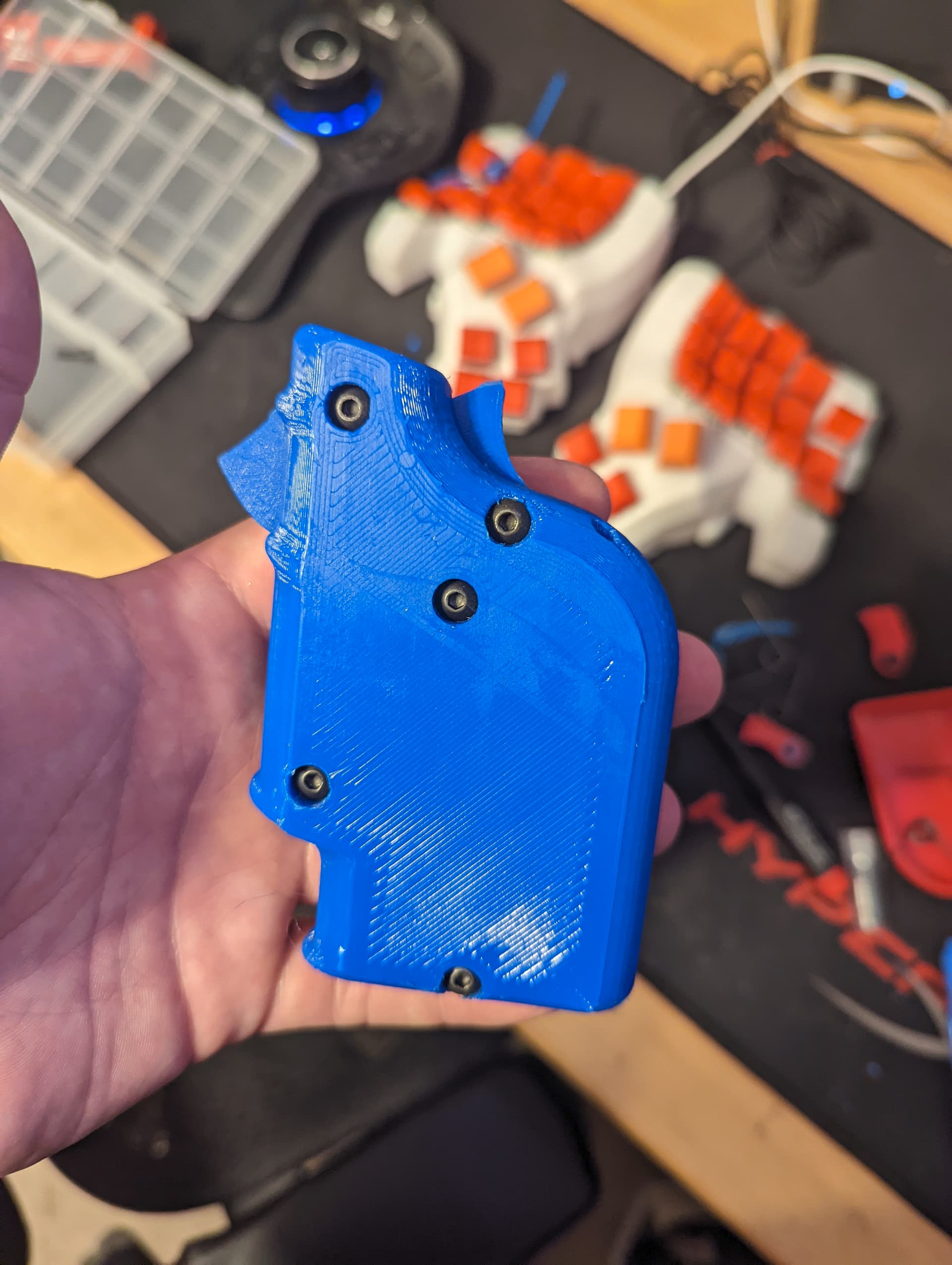

On the subject of selling remotes/files. Yes, my files will be free, but I’m also considering selling shells or full remotes/kits, depending on what happens with the pcb and such. I would really like to make the remote resin printed, so no sharp edges and tighter tolerances. I just have to test the durability first.
Regarding wireless charging, if I can fit a coil in there, then I’ll put one in. If I can’t, oh well. Feel free to design your own shell with wireless charging.
I’m still conflicted on using a battery tube. It takes up a lot more space, and adds quite a bit of cost to the final product. I’d like to make it work without a battery tube if possible.

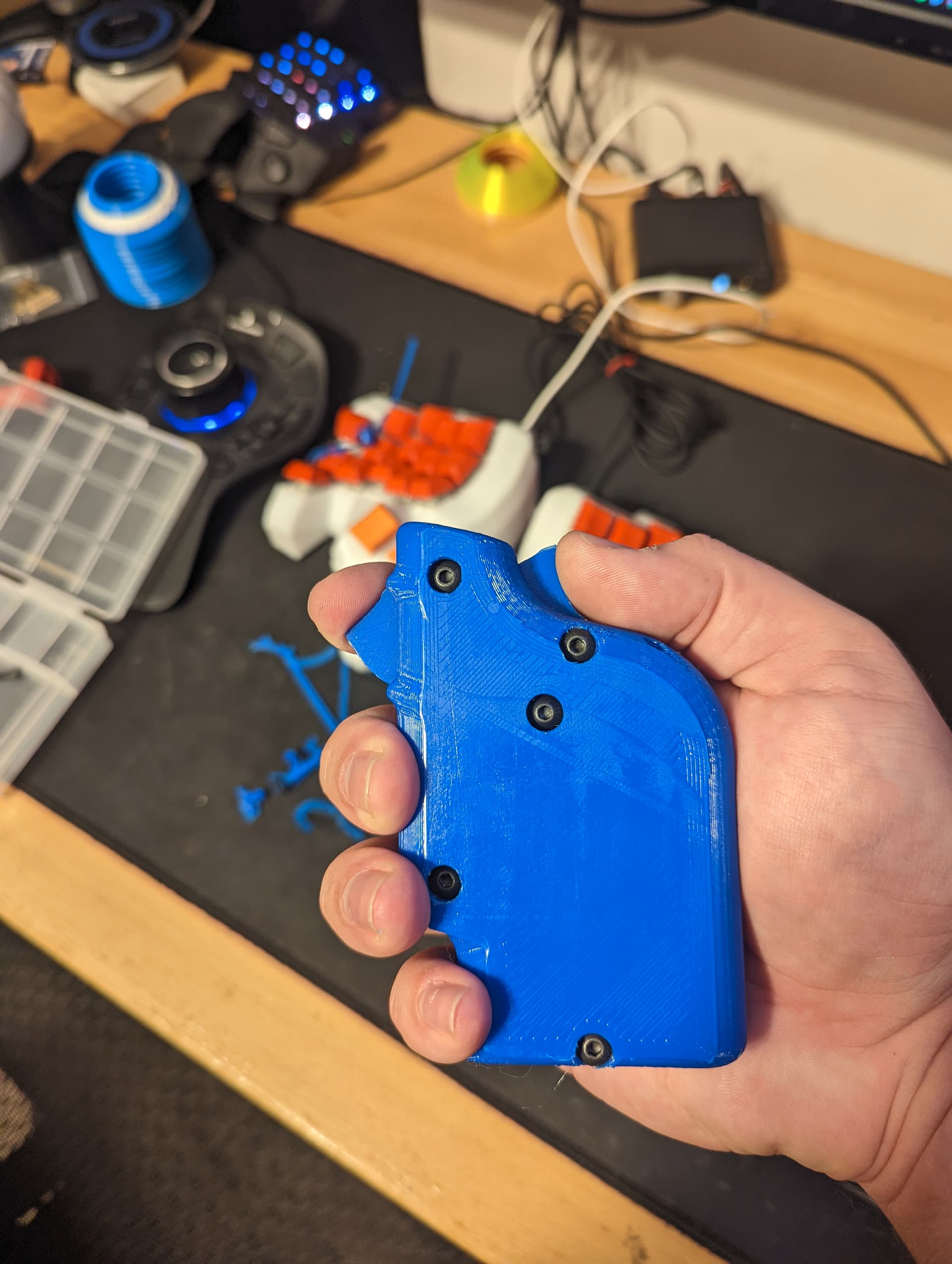

The springs also came in today. Impressed with McMaster Carr, I ordered them on Saturday night. They’re pretty stiff, so they can be swapped out with weaker springs pretty easily. I’m going to print up two shell halves and put it together and see if everything works as intended.
Every time I’ve looked into resin printing, SLS Nylon PA12 was the better option. Does resin have the strength and durability ?
(I assume cost would be better if you’re printing at home)
If you use the right resins, in the right ratio, it can be incredibly strong. I won’t get into detail here, but I’ve printed items that experience stresses orders of magnitude higher than this remote would experience, and they perform fine.

I have 18650’s sitting here beside me, not 18350’s. The size of the remote won’t change whether it’s a 350 or 650, because the size of the pcb dictates the size of the remote, hence 18650’s are going in the remote.
You wanted a removable battery, you got one.

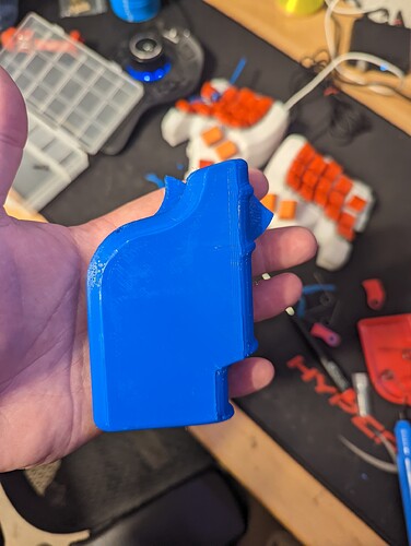

Shell is made up with springs. The trigger spring is way too heavy, so I need to go a bit lighter. Thumb spring is pretty good. It feels a bit thick, so might try to slim it down. If I go much slimmer though, 18XXX batteries won’t work, so I’d have to look at 14500 or something else. There needs to be some reinforcement in certain areas too. If you pull the trigger back and let go, it breaks some pieces of plastic off, no bueno.
