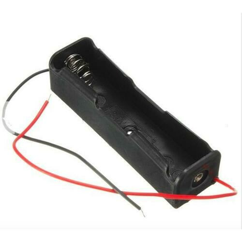

Electrically I can’t think of any problems with that but asking users to remove some of the wrap is a potential safety and liability issue. What if that cell gets used somewhere else?
How about a screw-in cap with the contact in it and a tab sticking out to touch something in the grip?
What about incorporating a premade 18650 holder into your design?
Like this:

I was thinking of that, just a potential point of failure. Last thing we want is the battery losing contact at 25mph. Those battery tubes might work, just not sure on room and ease of use.
@Baxter No room, and then we need a door to access the battery instead of a screw on cap. I’m not confident in the ability of the door to hold the battery in securely enough so it doesn’t come loose while riding.

Would it be difficult to add a spring onto the screw on cap to push into the cell when screwed into the case, similar to an AA battery compartment?
@thunkar check out single battery vape mods for inspiration, a lot of them are very hold-able with an easily-replacable 21700 inside.
I was thinking of doing that, but would still need contact for the negative side of the battery.
