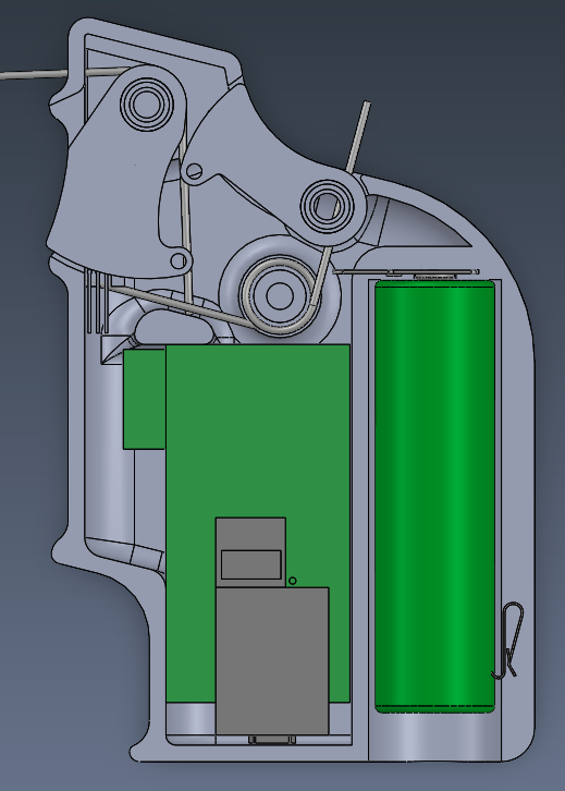

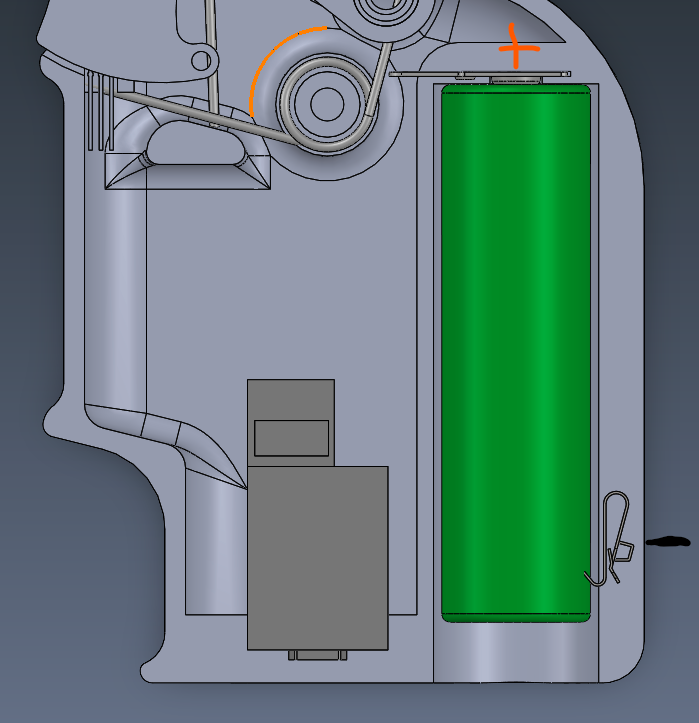

Here’s the files of each shell for what I have right now. Battery holder is sized for 18650 currently. If the PCB gets smaller then it’s easy to fit a 21700, but might be tight right now.
Hall sensor mounts are in there, USB port is in. The ergonomics most likely will not be changing as I continue to work on the inside, so if you want to test the feel of it I’ve attached the LHS and RHS shell.

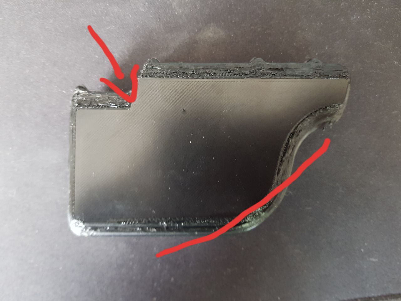

I’ve come with some feedback. Quick’n’dirty printjob without supports, so sorry for the bad quality.

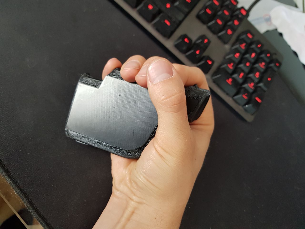

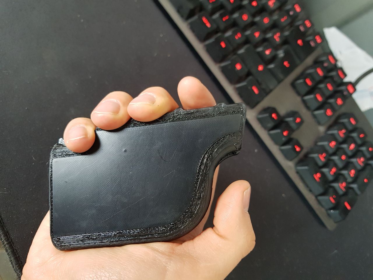

The corner with the arrow is very sharp and digs into the pinky finger, very uncomfortable. The big red line represents a cut I’d make, because for even my not so small hands this is too big and it feels like the remote wants to slip out of the bottom of my hand, pictured below.
Now I know that this is due the fact that there is supposed to me a 21700 in there, but maybe cutting that down to a 18650 would help.
Also I can’t help like feeling that the triggers are too narrow, like they would be digging into your fingers after a while. This depends on the choice of springs though. But this being a DIY product and not everyone buying the same springs, I’d definitely make them wider.
Triggers are going to be padded out so there is a flat surface for you to work with, those are just the parts that go through the shell. I want to keep those as thin as I can to reduce the amount of debris that makes its way inside. Not sure how you are holding it in the second picture, but that’s definitely not the way it should be held. That cut can’t be made, it’s going to make it want to slip out of your hand more anyway.
How is it digging into your pinky? Do you have a picture from the bottom or the other side? My pinky doesn’t even contact that edge.

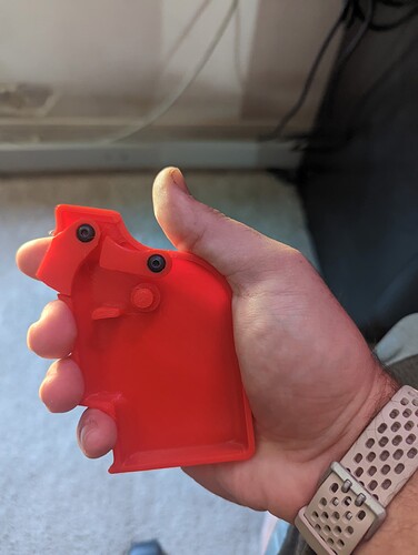

It looks like you are trying to use the tip of your thumb to activate the brake. It’s setup more to use the pad of your thumb, so it needs to be a bit higher up in your hand. The curve at the back should be on your thumb, like this.
Ah okay, no complains then.
I know, that picture was just to emphasise the feeling it gives me. :smiley: I guess I have smaller hands than you.

Yeah it feels way better like this, I guess I was holding it wrong. :smiley:

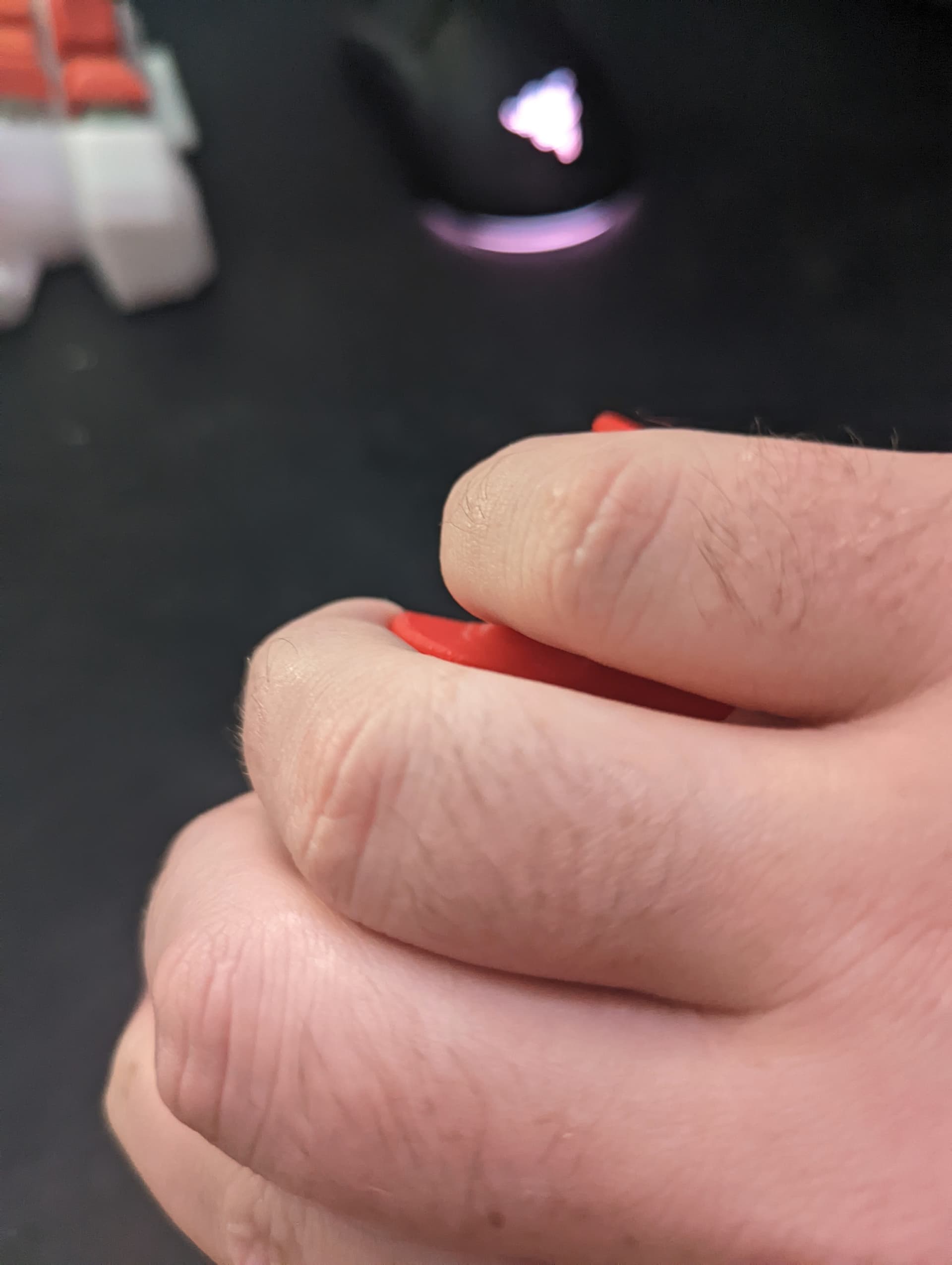

You need both shells for the effect. When I wrap my pinky around it it kinda lands on this sharp edge. I made a video to convey it properly.

@Battery_Mooch Any feedback on using the negative terminal for the battery holder along the barrel of the battery? Some of the protective wrap would have to be removed on the barrel. Not a huge fan of it, but seems to be the simplest solution at the moment.
