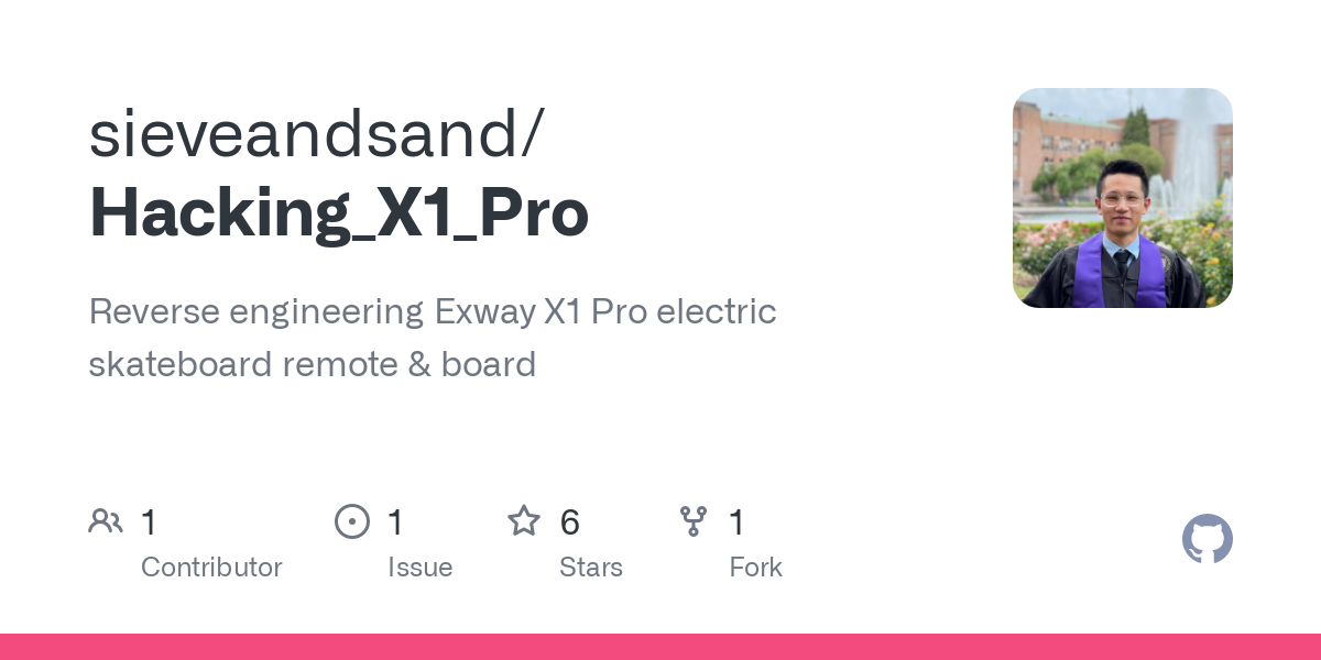

You only need one person pissed off enough sitting on a bench next to the road waiting for you. Here is one example exploiting Exway boards.
