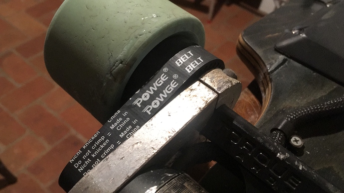

New pulleys and general maintenance that was long overdue, board has been flawless apart of belt skipping due to really worn out wheel pulley
Also one of the wheels always made a clicking noise, I suspect it was the bearings inside the 3D printed pulley that never gets the right tolerance, but this time I used a high temperature rubber superglue to lock it in place, let’s see if it solves
The cracked Hummie deck has been holding fine. To be sure I chiseled the external superglue layer that I’ve used to repair and was surprised to see that neither crack has opened again
The enclosure has a few more cracks that I put superglue from time to time
Also this time I’m using the pulleys just as press fit, without the retaining screws, this rubber superglue holds way better to the smooth steel of the pins
Supergluing the bearings worked, back to a silent ride :hugs:

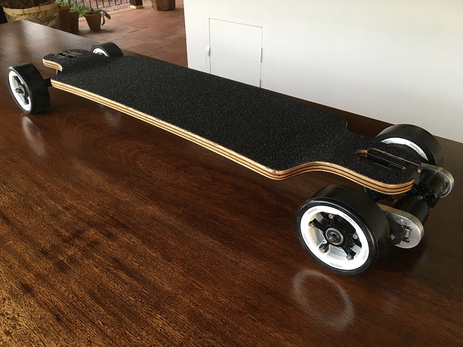

Photo dump
What grip-tape do you use? Idk how or why but it looks super good on the board; thinking I might just do that instead of glass fritting my Neo :stuck_out_tongue:
I really like it, looks like glass fritt with black epoxy
Unfortunately it’s sold here with no brand, it’s cheap and comes as a roll instead of individual sheets
Don’t know it this helps
