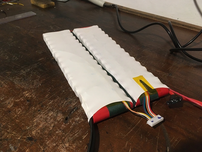

Now to the battery pack, have to disassemble my ebike one
Now I’m thinking if I do a top mounted external pack that can also be used as range extender for the mountainboard or inside the enclosure. I still have an old 10S3P that I can use as the extender, one cell is badly corroded so I’m a bit afraid of messing with it, could make a 10S2P with it, but then I don’t have how to charge it
Keeping the build theme, the battery is done, capable of massive 30 A discharge, so I had to take precautions and use a 10 AWG wire, but only outside, connecting the P groups is a 16 AWG, and off course a 30 A fuse
Also in one half the P groups are held to each other using double sided tape as a test, it isn’t strong but provides good isolation, the heat shrink holds it together
And after quite a while of chiseling and sanding all the silicone that held the old battery is removed so the double sided tape can stick to the wood, could have used silicone again but that takes too long to cure and I want to test ride tomorrow, still need to do a pice that will house the switch and the charge port on the top of the rear truck
The BMS is one that I bought at least 3 years ago and never used, hope of works, the battery is quite unbalanced since it was split in one 6S in my ebike and one 4S for a test board, so they are 3.83 V and 3.72 V respectively, I could have balanced manually but would take too much time

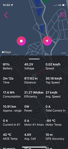

Some testing for the Iron Foot challenge, looks like the sweet spot is around 20 km/h, quite windy today so it might skewed the results a bit, and also the ESC measurements not being that reliable
I known can do 38 km with chill riding on this board, so maybe 65 to 70 km with the range extender
