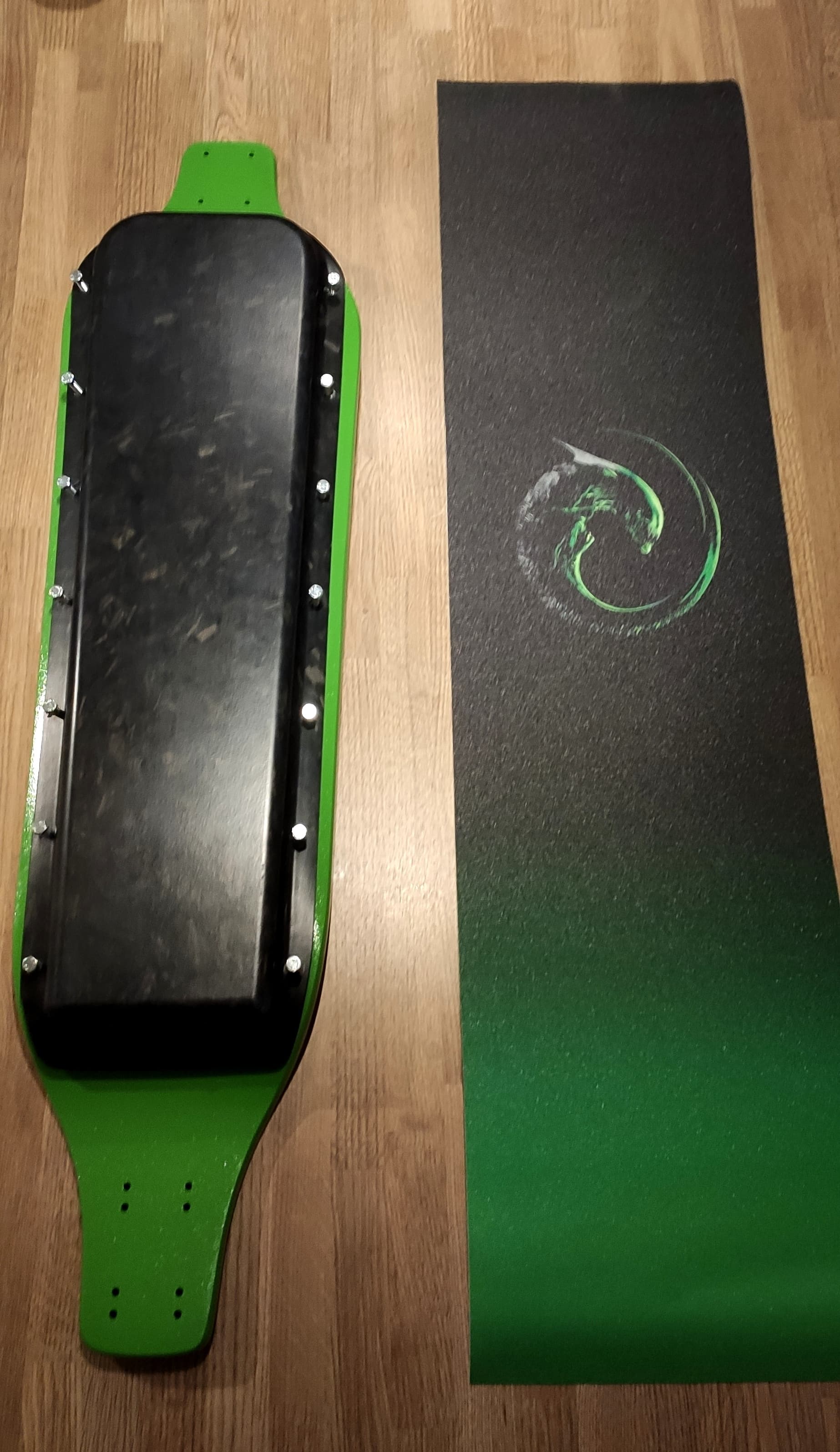

While waiting for the next season, I decided to rebuild a bit. I’m going for BN’s new AT kit, wheels and motors, and some new exiting tyres. I painted the deck, and got a self designed griptape from splattergoat. I think it will look awesome! :smiley:
The bolts are just a testfit after i changed out the threaded inserts for a more solid and permanent insert option.
After photo is taken I filled in with more epoxy. Now i can even threadlock the bolts to the enclosure without fear of pulling inserts out. These won’t move.

I finished filling the holes after the t-nut inserts, sanded like a maniac, and finished the paint.
Finally got all the enclosure bolts to fit.
Now i’m just waiting for the last parts and griptape applied and it will be done.
