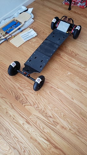

The Smörğasbord |trampa HS11|TB6|Kaly Drive|APS 6380 170kv| 12s5p QB26800
I am thinking I’m still going to take it out on a quick spin :crazy_face::crazy_face::crazy_face:

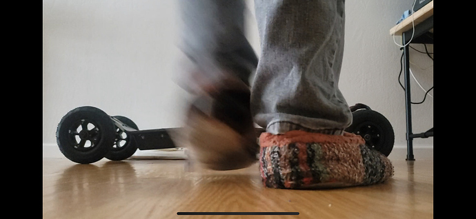

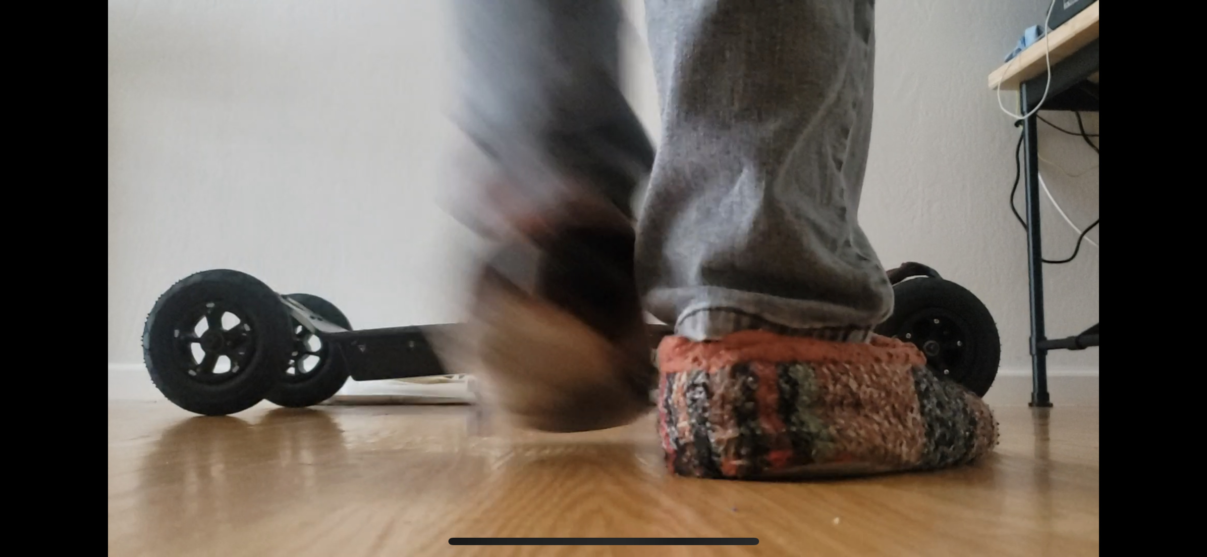

Update on the smorg…waaaaay to low! Going to rearrange the bms to the middle enclosure AND get risers…now does anyone know where I can get risers? Also how flexi is too flexi? Cause I think I might be fatter then I thought
got a pic of you standing on it, or a video of you getting on and off?
I weigh 200lbs :sob::sob::sob:
I guess it doesnt look that bad? Maybe a small riser and moving that bms will fix the issue
that would look nice with nine inch tires wouldn’t it!
Hell yes!!! Now I need to find some of those
I think this was addressed in another thread but did we ever figure out if these 9" tires from MBS are compatible with rockstar 2 hubs?
Woah. Sweet kicks bro :heart:
That’s super low. I wouldn’t even dare riding it like that haha.
Looks good btw :ok_hand:t3:
To low, even with risers…Flex too much for your weight…You can add carbon fiber (in patches) to make it stiffer…But maybe you could sell de board and buy the new BigBoi from Trampa…If you just run over a bump or you are turning and hit a small bump, it could be bad…Other than that…amazing and super nice build…
Dang man, yeah that is what I am thinking, might be better of selling this to a light weight rider
And move the bms and add risers lol
Yes, I think thats the better solution…That board should sale fast…
What about something like Hearo board?
It is a nice but low board too…I really like the Bigboi from Trampa…Wider, less curve, more clearance…But I do not have any of them…I have a HolyPro 16 ply, which it is a sweet board, tons of fun; and a everyday ridding 14 ply Trampa street carver with eboosted enclosure, I love the ride and feel, but I hit the ground al the time with the enclosure…too flexy…I weight 80 kilos…
