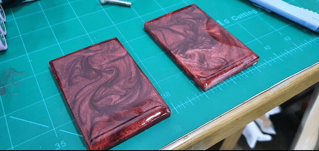

My original thought was to use some resin blocks to strengthen the area, but this was quickly exposed by some esk8 frens to be a terrible idea that made no sense. Shame, because I loved the look of the red resin blocks Linny crafted for it:
Test fit:

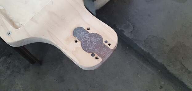

After consulting with Linny on a better solution that will hold up in the long run, we determined that the drop through couldn’t be saved, so we committed to top mounting and filling in the gap. (We also filled in your mom’s gap. Burn.)

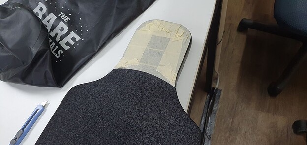

To accomplish this, Linny cut up a bunch of fiberglass and mixed it with resin to create a permanent fill that should last the 5-6 years I have left on this earth:
Prep photos:
Cloth cut:
Linny even found a way to incorporate the resin blocks I still loved like so:
The fill looks to have done the trick, and there’s even a cool swirl that resulted:

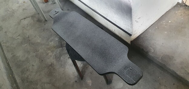

Then it was time to tackle the enclosure. First, Linny sprayed it with some fine bedliner, which in addition to looking great, added a little firmness to the borderline flimsy stock enclosure.
Stock:
Linnified:

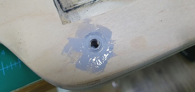

Mounting the enclosure was also a bit trickier than we thought originally. The V1 TB40 came with the inserts already in the deck, but the sizing relationship between the hole and insert (I have the same problem with @glyphiks) was not ideal. So a few of them spun and one fell out completely.
So Linny broke out the JB Weld and got that shit sorted once and for all:

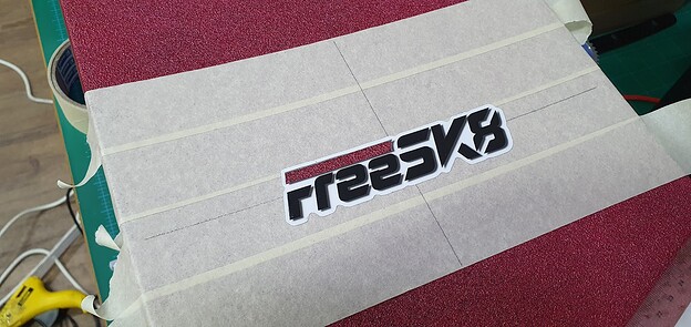

Then it was time to get the FreeSK8 logo laid down:

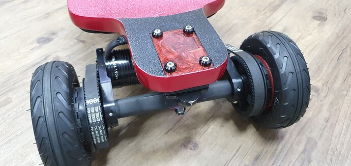

From this point, it was a simple matter of bolting on the already-intact drivetrain and setting up the pair of TB6 @wandagoner hooked me up with, and this baby is ready to ride on over to your sister’s place!
So a huge fucking round of applause goes to @Linny for all his excellent craftsmanship and hard work! I’m pretty happy with how it turned out:

One change has already taken place:
After the world’s shittiest Clever tubes held as much air as an asthmatic lifeguard, new wheels and tires have taken the place of the Bergmeisters:
