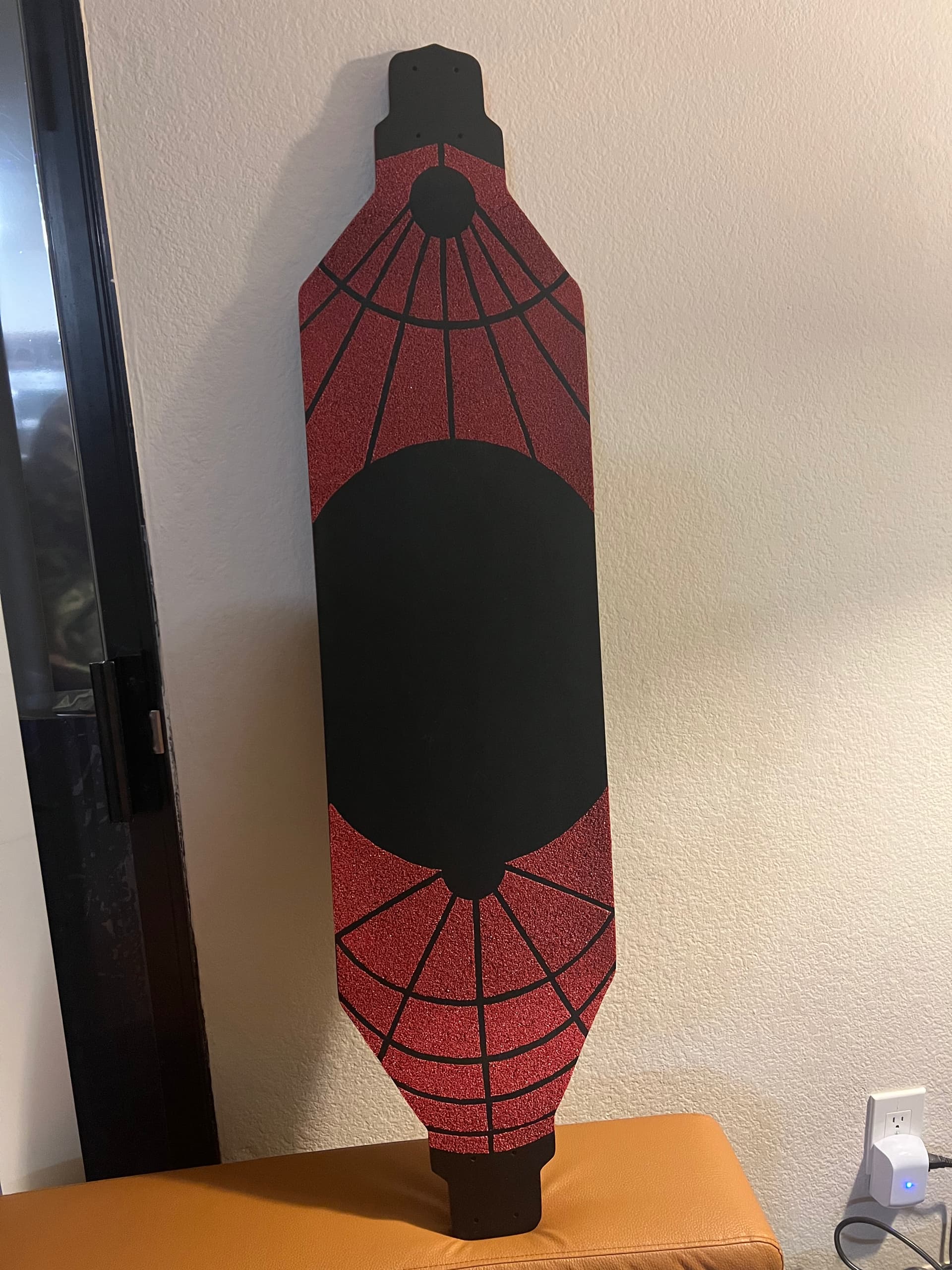

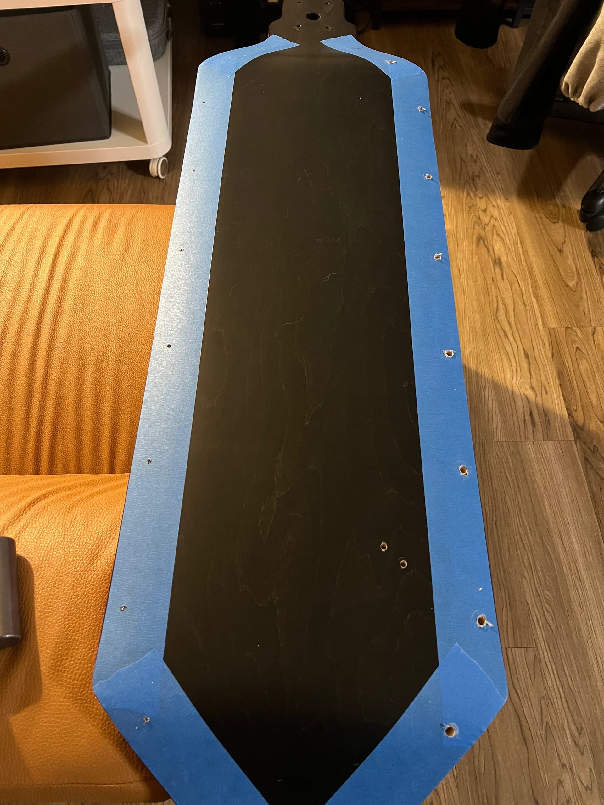

Alright party people made some cosmetic updates that can be seen above, and I guess @Shadowfax already revealed it in his thread so updating the title to reflect that bit.

Just finished the grip and you can read the details above, otherwise here’s where I landed:

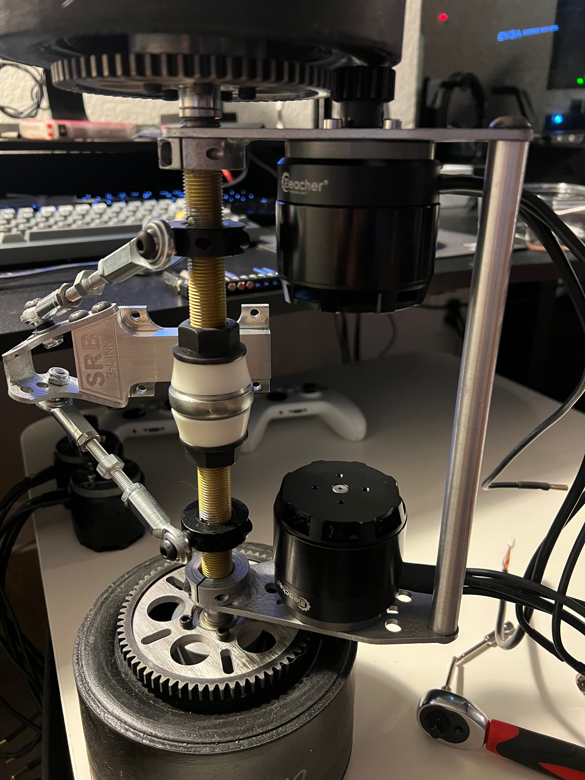

Next up I got some @Tony_Stark Radium adapters that came in so I can start cutting some motor shafts and mock those up. Otherwise, it’s time for the battery :partying_face::grimacing: all 21s6p of it.

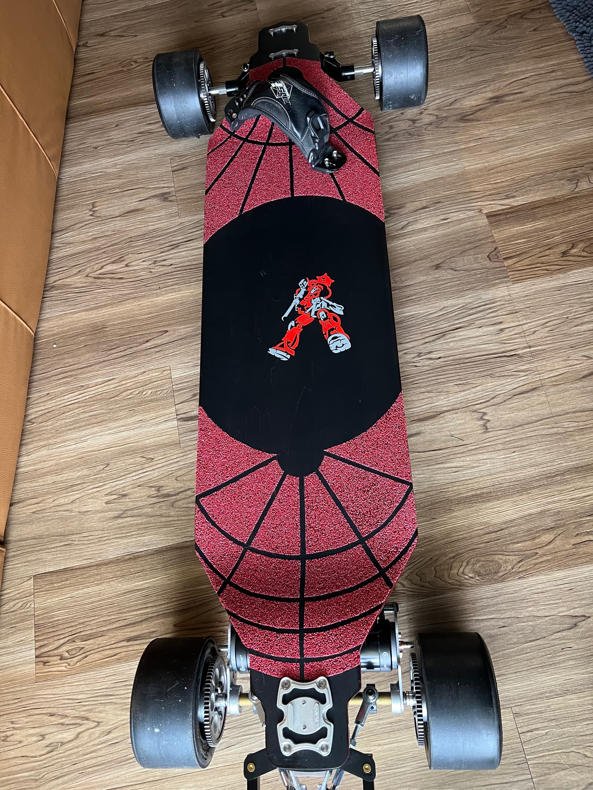

That is real nice! This thing is going to be insane at 21s too!!
Ty Ty. Too bad most of that front is going to be covered by a binding lol. Needed a pic before that happens. :laughing:
Preview:
This is so good dude!!!

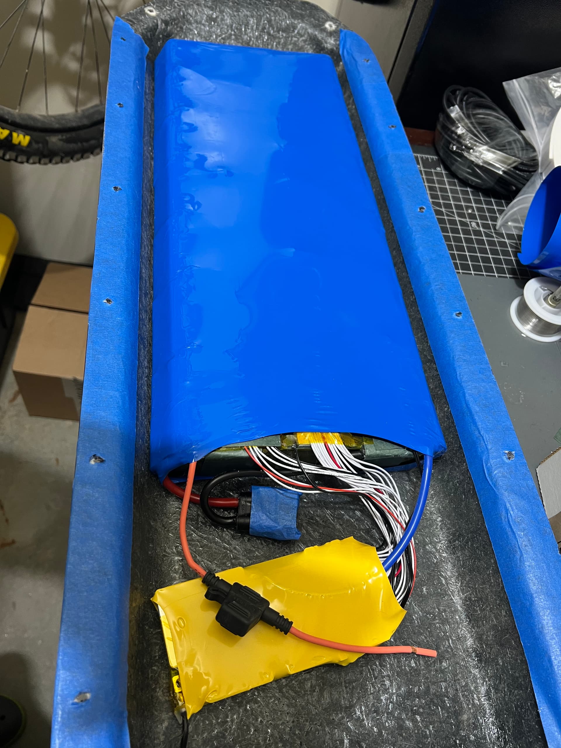

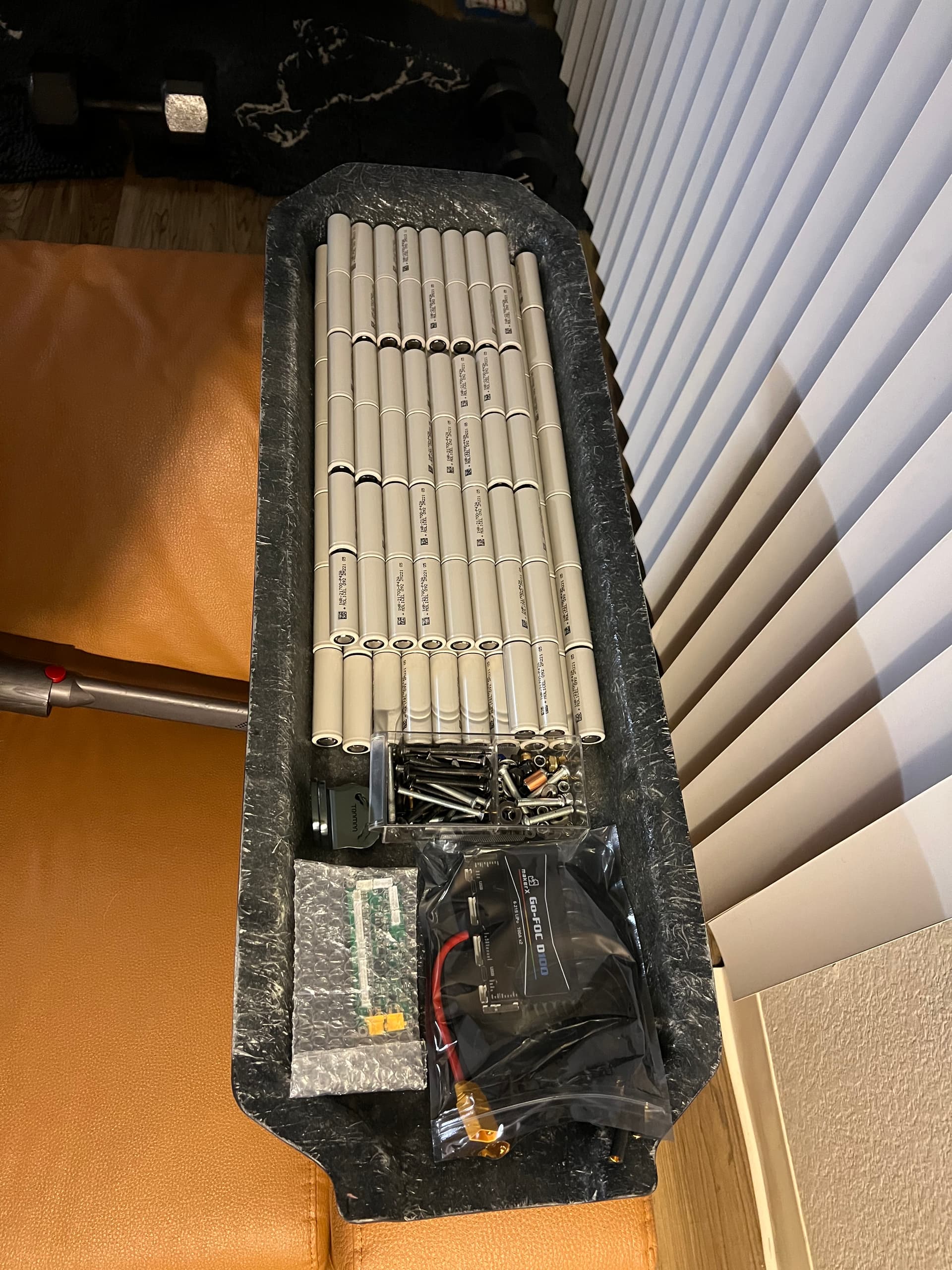

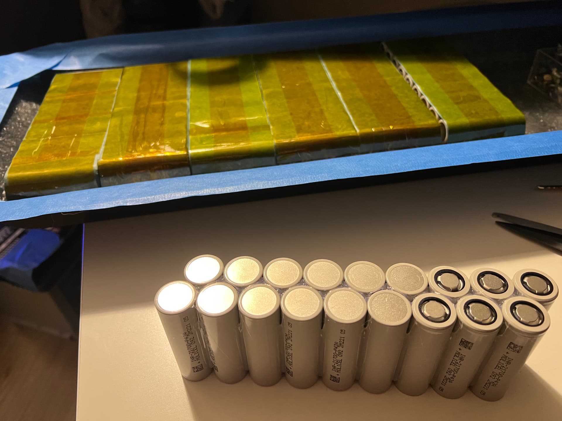

Greetings :vulcan_salute:, man work has been super stressful so not a whole lotta progress. Welded up the battery a while ago but haven’t made the connections. Going LLT BMS as it’s familiar and I have room, but it hasn’t arrived yet anyways so, that’s been partially my excuse waiting on @Skyart. Once it arrives and is all done will give the battery a proper section above, but for now a couple pics:

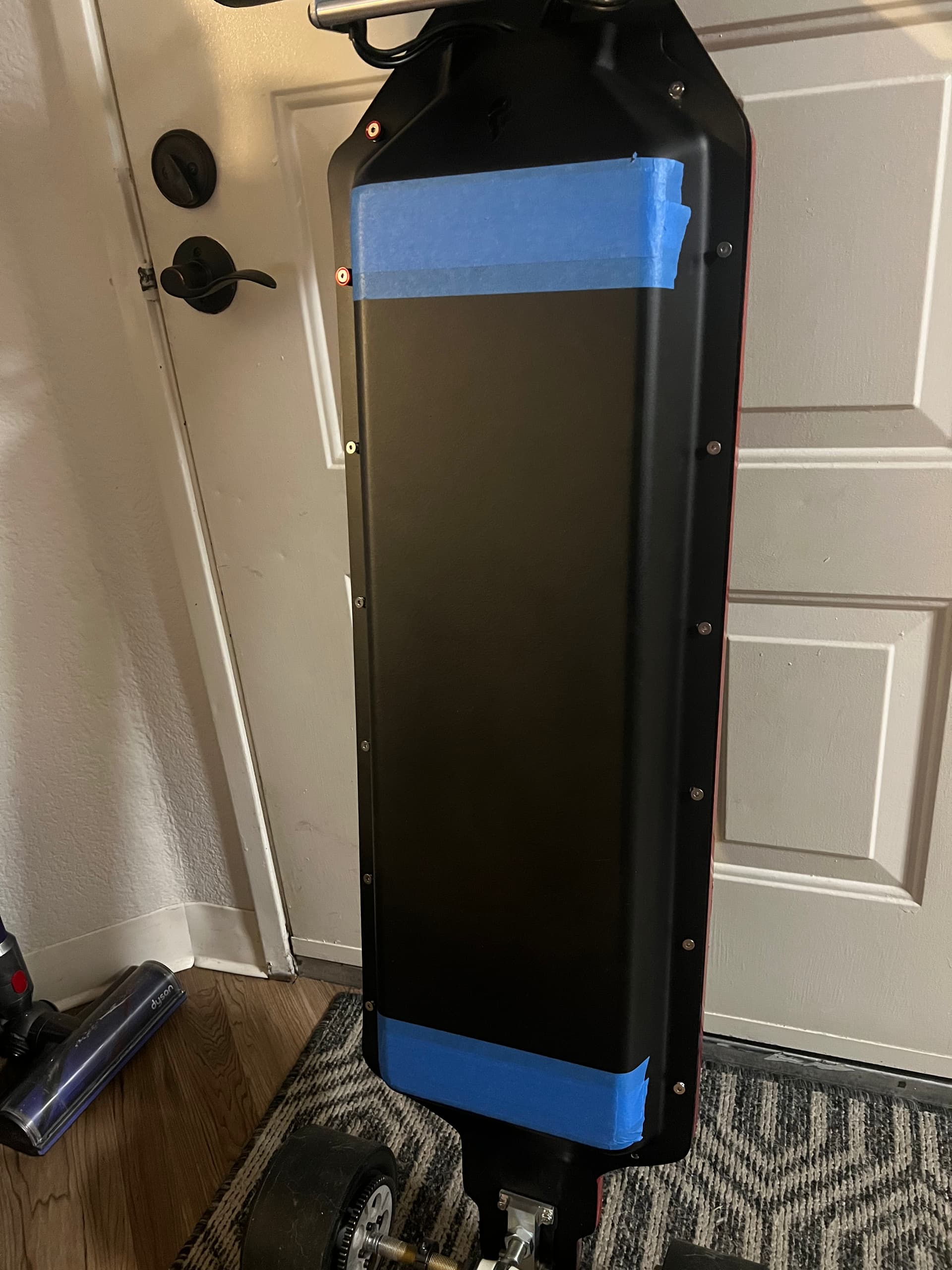

Did get the enclosure on using the @Linny method (guess that’s what we dubbed it) as suggested by Dremel Evan (@Shadowfax). Yay small wins.

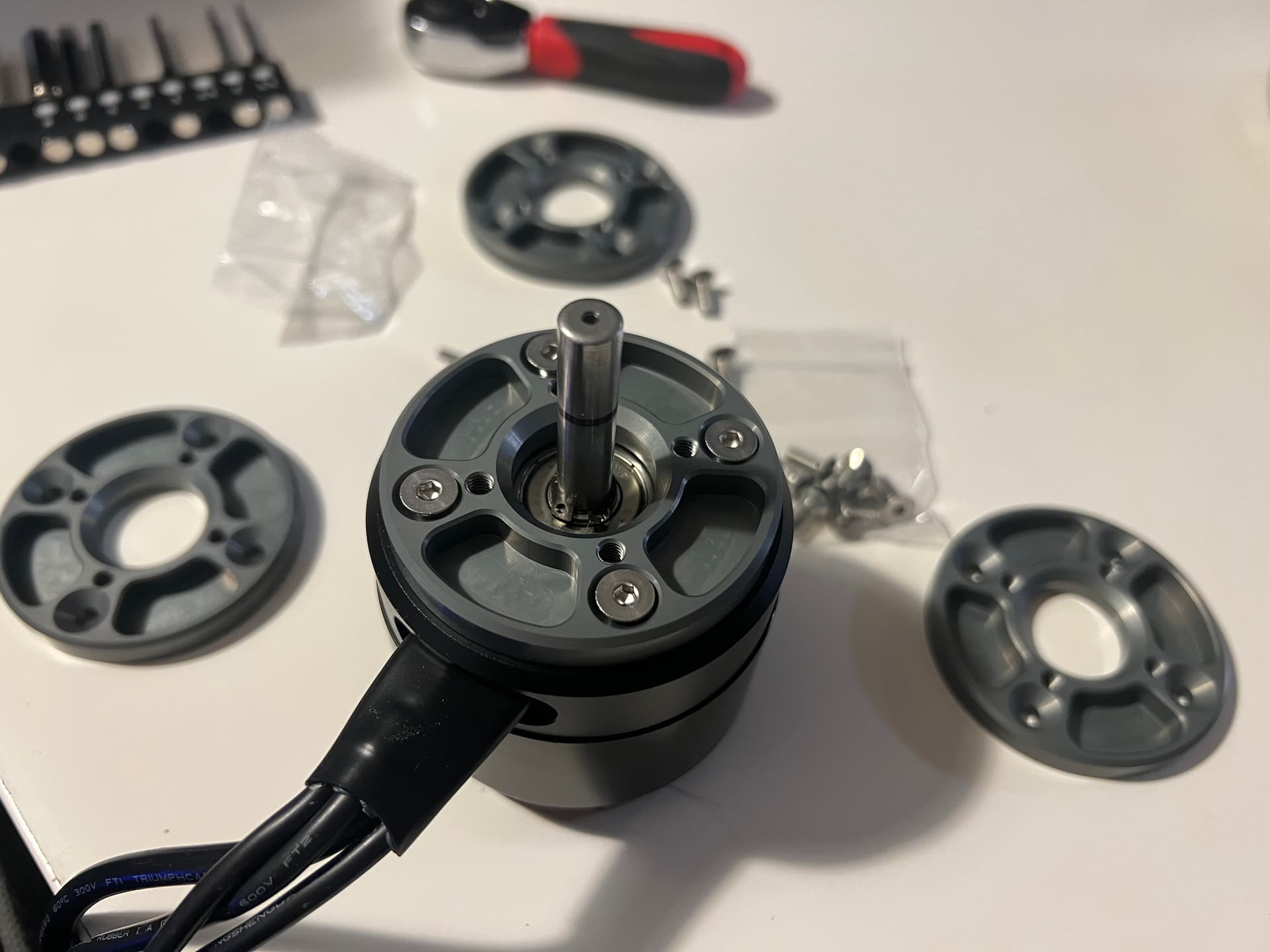

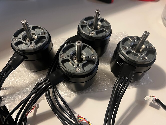

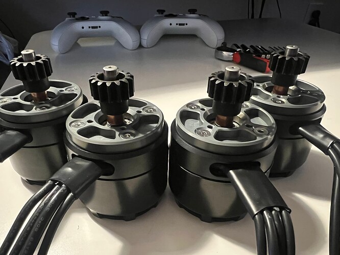

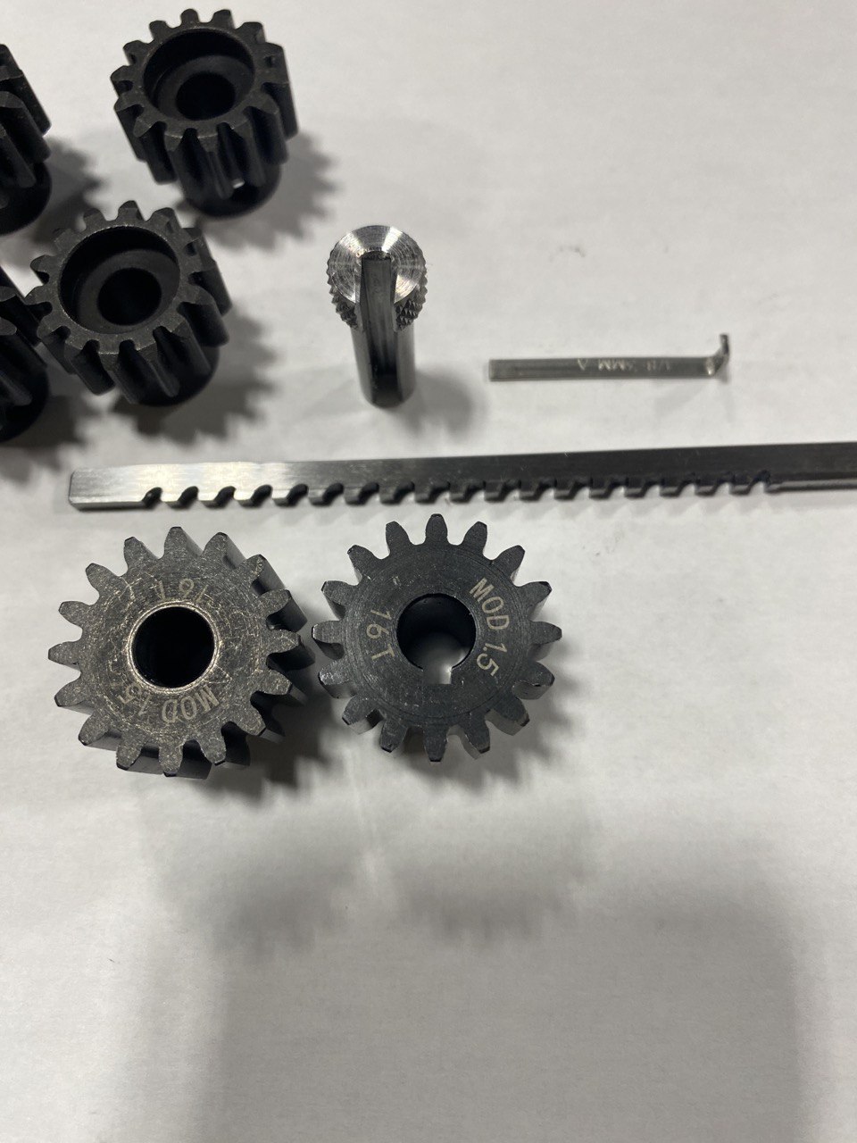

Also, cut the motor shafts to length and sent off the motor pinions to Phil who graciously is helping make a keyway for Evan and I.
Motor pinion photo courtesy of @Savage1

That red accent on the deck edge is :fire: :fire: :fire:

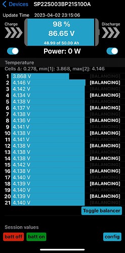

Ughhh, was hoping battery would be done, but hit a setback.
Not what you want to see after weeks of work.
Went through everything with the multimeter and everything on the battery and harness looked good (voltages reading 4.1 for all). Turns out if the B- port of the BMS isn’t connected that first cell won’t read correctly… huh. Guess I’ve never looked at the app when only the harness is connected before. So, should be good :face_exhaling:
Alright, alright, alright finished the battery and everything is copacetic now. As always details at the top.

What size battery did you build?
Went for 21s6p
