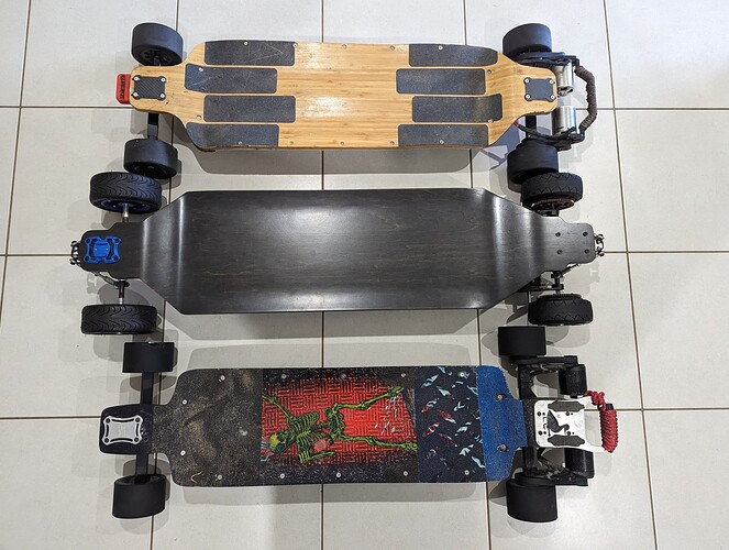

I’d love to see the semendeed in this shot as well to see how it compares.

Thanks. Yeah definitely interested in lowering a bit however much I can get away with, even if it’s just 5 mm. The 3-Links are pretty nimble already, hopefully it’s not a drastic loss.
@glyphiks would love to get my hands on a Semendeed one day or run into someone who has it for that comparison.

There you go bro
Thats the wheelbase difference between the semondeed with savage tkps and demonseed 44 with Rosas an North camp with 3links
The standing platform lengths are all super similar the north camp mostly has a longer nose and tail more than anything
