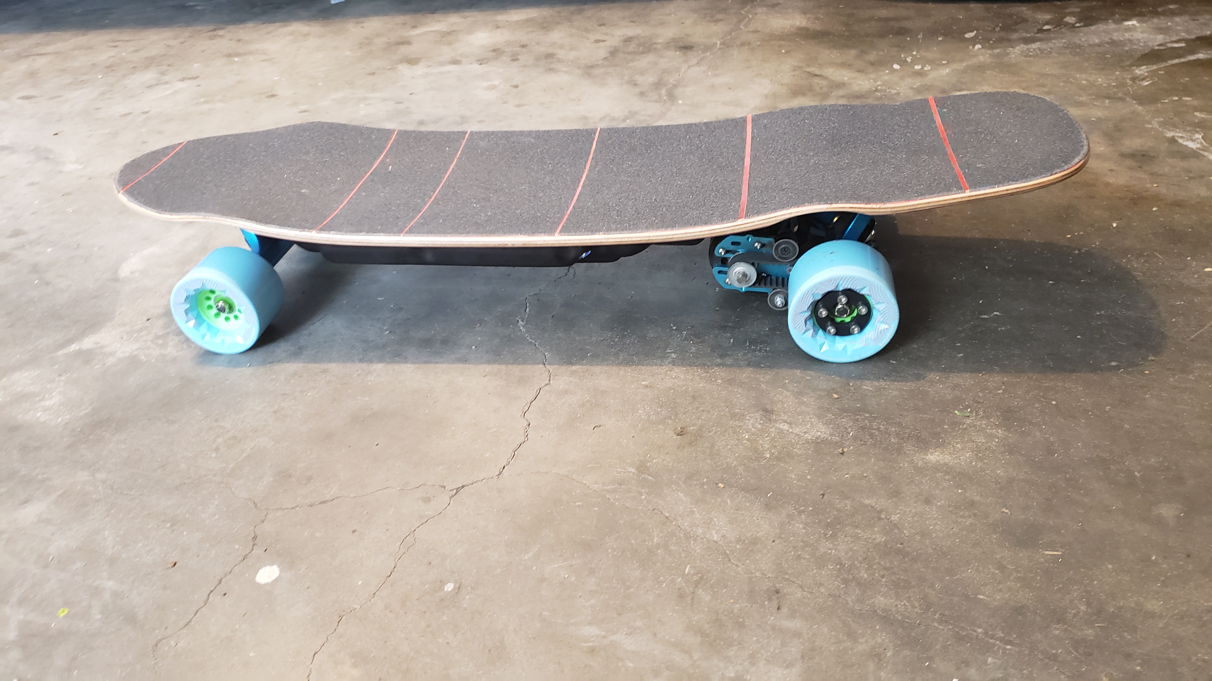

This little guy is just so good.
Real rocket. Board feels great.
Landyatchz Ralleycat - the most rocker you have ever seen.
Psychotiller 12S3P
Psychotiller Flagship Enclosure.
Unity.
TB 6355 190kV
Caliber II 50s
Dickyho mounts.
Running idlers for now.
14/34T Janux-esk8 pulleys
Zealous Bearings
Running 85mm Caguamas now. started with Evolve 83mm wheels.
Riptide 93A Krank Canyon Bushings.
I can’t believe how much difference the Caguamas made. Freaking night and day.

Do we think the 3P is enough to maximize those motors? I’m working on a similar build and debating 12s3p or 10s4p. Have you done any current readouts?
I am building another board like this, and Dave at Psychotiller is making me a 10S4P for that one.
I am dumb about all this stuff, so I just think 4 more cells is more better…
Having said that, this set up is stupid torquey. I am still scared to get to top speed. And I have gone 14 miles without totally draining the battery and with gear on I am at 225 lbs. https://www.relive.cc/view/rt10005673258

Did ya have any problem getting the enclosure to form to the rocker?

Nope. The enclosure is pretty flexy. I guess my only issue was not being able to keep it centered just right when I drilled the holes for the inserts. So it’s a bit crooked. More patience and better bracing would have kept that from happening

How do the blue caguamas feel? I know they’re good, but the blue ones are just a different beast right?
Dude. I thought the evolve 83s were pretty good and soft. But these blue caguamas are intense. Soooo smooth. I don’t even understand.

I got to many decks as well, the rally cat, too and this deck is just awesome. I know nobody would probably mount the motors on the back of it, but i would go this way with belt drive system. Unusual, but more space for batteries and much more ground clearance. But it hurts to see the kitty raped for motor clearance while using rock hard bushings, anyways Awesome build!
I had a kicktail board with the belts in the back. Had a freaking 10s5p in there. It was 37 inches so felt too long. It has tranformed into other things now. It is nice being able to use the tail
