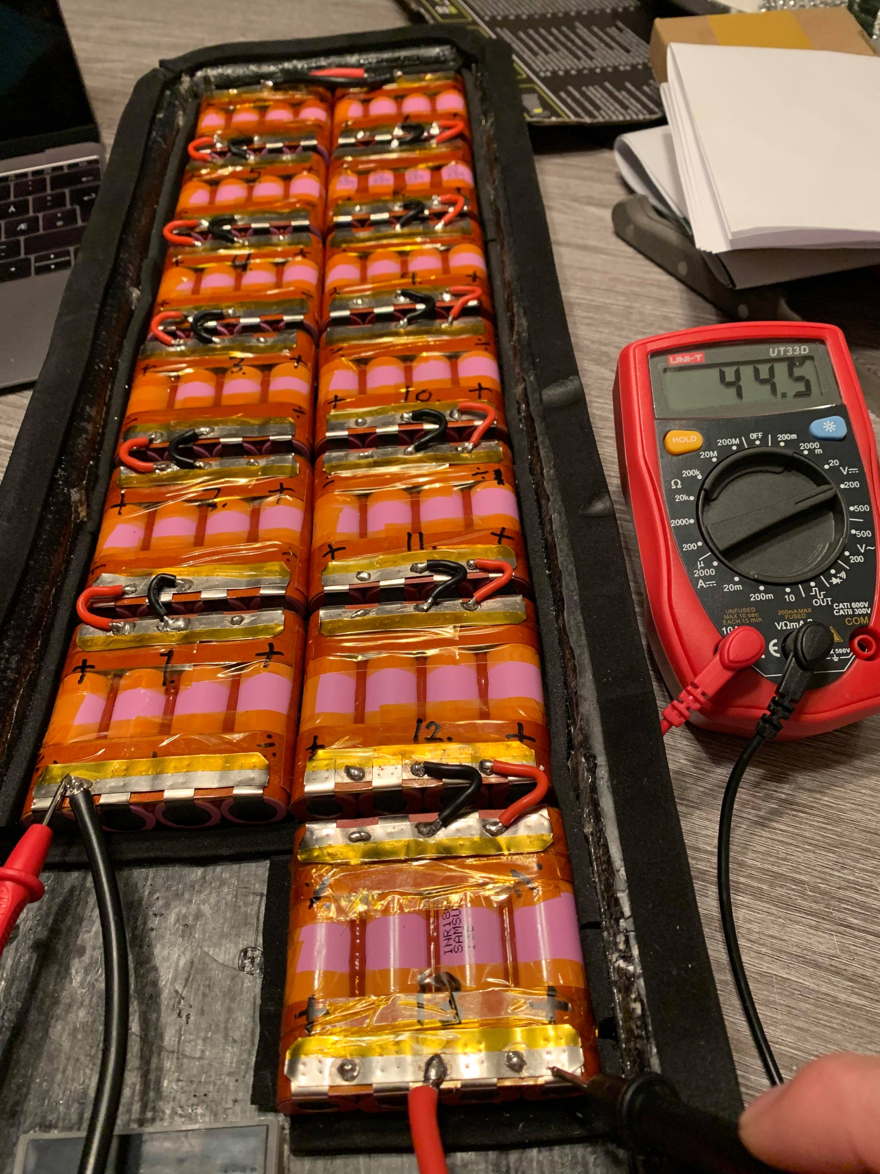

The Prodigy - 13s4p
Deck: Arbor Nautical Prodigy
Trucks: TB218mm
Motors: TB Dual 6374
Wheels: TB 97mm
Batterypack: DIY 13s4p
Enclosure: DIY fibreglass
ESC: Focbox Unity
Lights: Illume V2

Should be ok, confirmed by DIYelsk8 and Focbox that 13s is working fine on many builds
13s works. It’s just whether you need it or not. It will put your parts under more strain but ultimately the unity will handle it.

Board is done, got to ride it yesterday, it pulls like a maniac uphill and is too fast to go full speed yet, around 60 km/t the back truck started to float around like crazy, maybe it was the start of a speed wobble, i quickly slowed down and managed to stay on the board, but it was scary. Need to tighten trucks more, maybe buy some riptide bushings.
Problem is also board is braking is very slow, i tuned the regen braking in focbox unity to 35a but its still weak and does not perform a ramped braking that my ownboard does. Anyone have good settings for braking on 13s i weigh around 65kg and the motors are dual 6374 ?
If you’ve got the 4p, I’d change braking to -40A and if you like that smooth braking, set the throttle curve to a polynomial. People like them to be around -20% to -25%

I suspect that the “floating feeling” of the back truck upon reaching 60 km/h still accelerating can be rising a question of truck stability.
I definitely need to ride more and get used to the high velocity and board feel to address this issue, but psycotillers tkp trucks has been discussed in project design.
I also felt it as if some weight and momentum came from far back of the board and since I have reverse mount maybe board weight and stability is worse off with reverse mount than regular dual mount since motor weight and pull is further forward on the board, maybe someone with experience of both can answer this. Anyway, is smiled a terrifying smile and are both eager and afraid to ride the board again :wink:
4p yes. will try those settings out, are the polynomial setting available through the Focbox Unity software or do I need the bldc tool for that ?

Bushings will go along way to improving the ride of the 218s. Also get some insert bushings for at least the rear. Stops the slop. TB218s are renowned for walking under full power. I run 96 barrels in the rear and 86 front with inserts. Different animal entirely.
