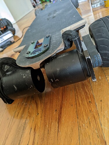

Welp, went on a group ride yesterday and banged up one of my motors against a tram track while going over it. Broken magnet. Board is surprisingly rideable, but I’ll have to replace the motor, and given how fast this occurred / how much I’ve been scraping them going up and down curbs or when dragging the board by the front, I think I need a different drivetrain solution.
Can’t switch to Rosa trucks because then the motors will be low again if I go with large ones, and I can’t even raise the motors higher in reverse mount because of the ESC case. I feel like I need to switch the deck to one with angled ends.

Maybe you can do what I did:
Move the motors up and sand down the board where it interferes.
I also moved the trucks back 1cm so there’s a little less sanding to do which required a little minor surgery on the drop-through hole.
If the motors still interfere with the ESC case maybe a combination of sanding down that edge of the case a bit and shimming it up / moving if forward a smidge can make it work?

I’m still puzzled as to how you managed to hit those motors against those tram tracks with pneumatic wheels. I ran 110mm thane and passed the same tracks that evening. :thinking:
For reference, the place in question:
Whats the clearance you have between ground and motors? I also noticed that GD case seems to be just tad smaller than motor cans, it’s as if motors are the closest part to the ground.
Motor to ground clearance is 4cm.
Gear drives are slightly lower than the motors, but unless you drive completely parallel over something (and that something is also flat), it doesn’t matter.
Also I broke the motor after the bridge, rails were definitely poking out of the ground there.
I’m telling you man, this is why I need 9" tires :stuck_out_tongue:

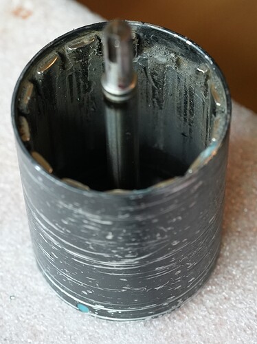

Opened up my drives. On one of them the threadlocker had given away so the motor key started making a tiny mess :sweat_smile:
Hey look! Kevin’s drives aren’t the only ones that suffer from this issue! :smile:
Motor had magnets broken, can is unbalanced, can’t be reused :disappointed:
Also the stator ends had some delamination from the damage of me still riding it like that + some windings were a bit loose, so I hot glued the stator gaps to prevent that from becoming an issue. But for now this stator is useless until I get a new can for it.
