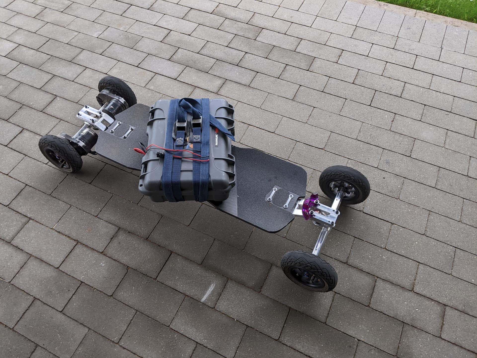

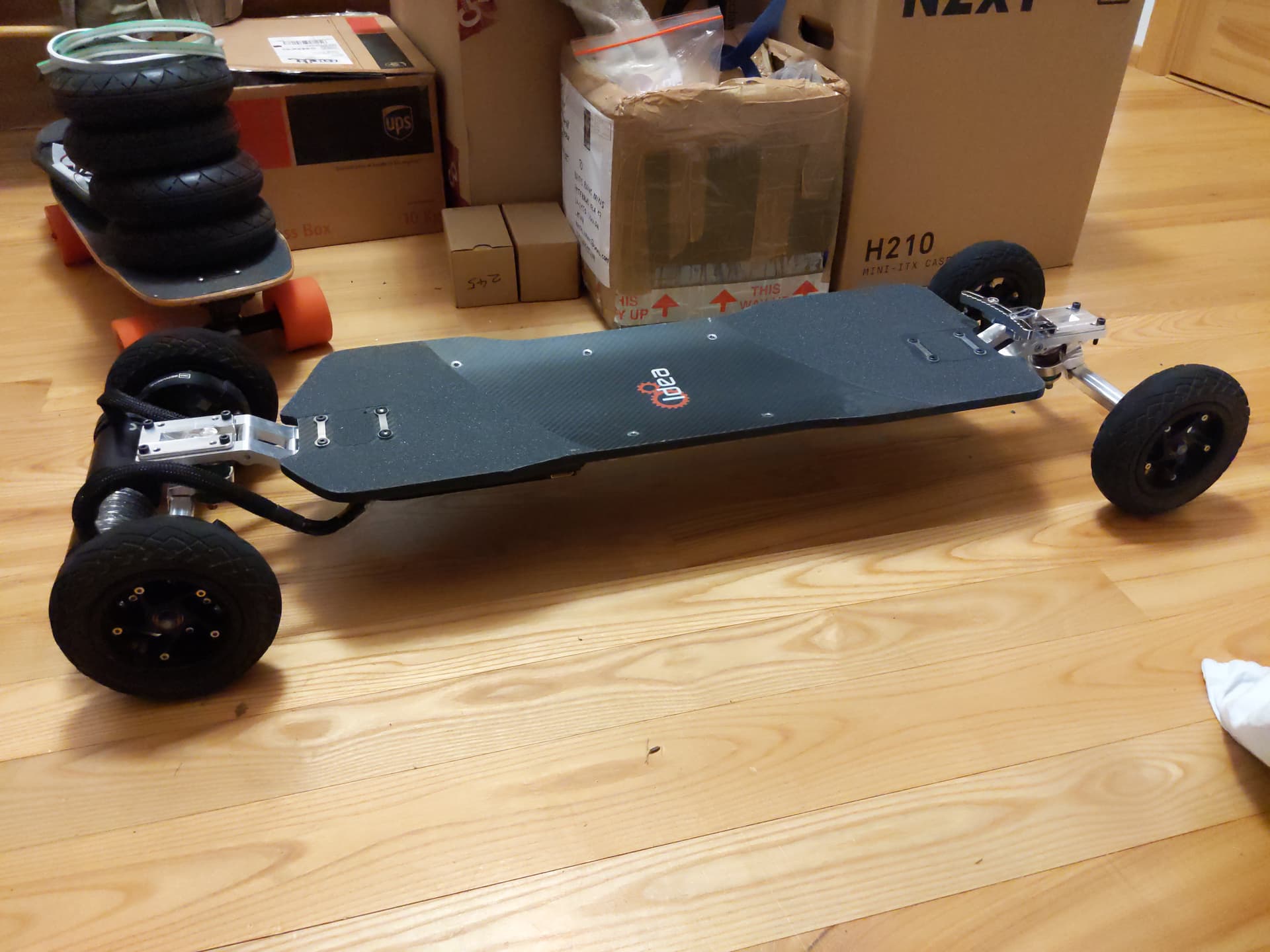

Since my Luna drivetrain is being lent out to my brother and Rudi, I put the 3ds TKPs back on this board. I also got rid of the footstops; they made my feet hurt. Hoping I just get used to not having any concave.
Also this board would look really cool like this if I had a small battery on the bottom, instead of the giant top box :see_no_evil:

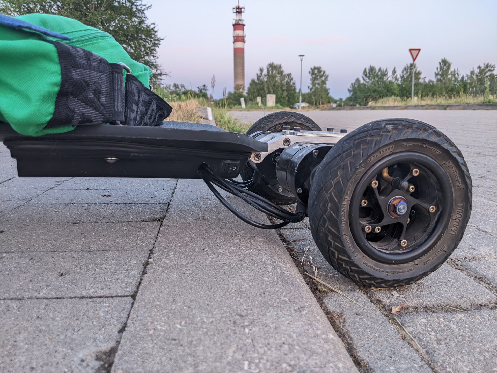

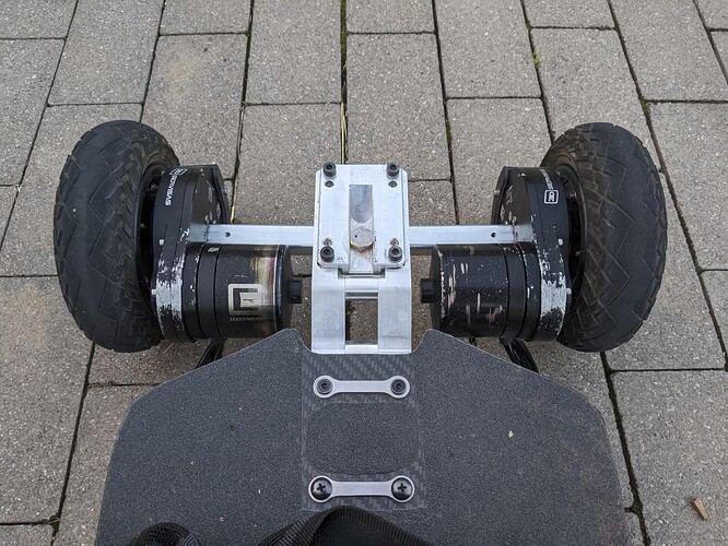

I switched out the 6384 motors to 6355 ones so that I could forward mount the drives. Now I can drag the board from the front, and I never have to worry about hitting my motors against something and breaking them :partying_face:

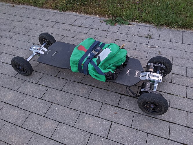

Green handbag is holding a 12s4p flexipack that I’m testing. I’ll figure out what to do with the phase wires pointing downwards another day :sweat_smile:
