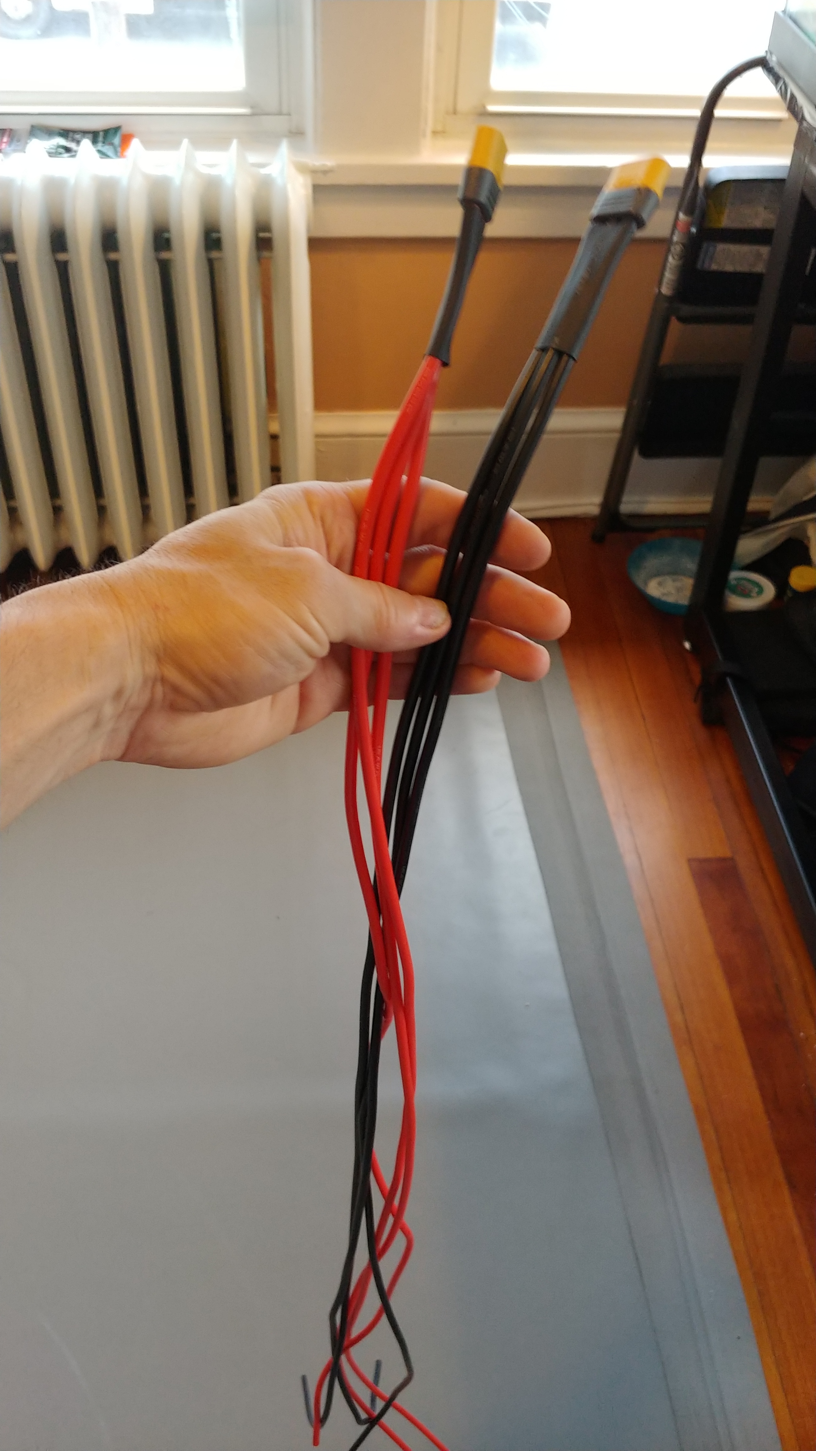

  1. I will route phase wires down the side of the board just under the lip.
    Phase wire extensions will lead into and MR-60 connector.
  2. Externally on the box, on each side will be the receiving end of the MR connector which will be mounted somehow. the wires from that connector lead inside and connect to the esc. This way If i ever need to remove all the electronics at once I can just unplug 2 wires and done.
  3. the hall sensor cable…IM TAKING INPUT HERE. I read some one used ethernet/gigabit cable as the main extension line from motor to box. This is option 1. I have plenty of standard sensor wires I can hack up to attach to the ends BUT currently wondering what a good junction would be from external box to the inside that isnt super bulky…and has 6 pins(or something)

  1. took my 12s4p offset double stack and broke it apart into 4 pieces an now is an off set brick to fit in the box, swapped the bms to a d140 to save space.
  2. started making some extension wires for phase wires using MR60s and then got ethernet cable which is fn cheap and soldered on sensor wire connectors…took some time but nice n long.
will trim phase wire leads once I get things mocked up…motor to box… and another connector from box to unity…I wanted things to be modular and easily disconnect incase I want to pull this box off for a monster “range” ride on my other board using this battery in parallel.

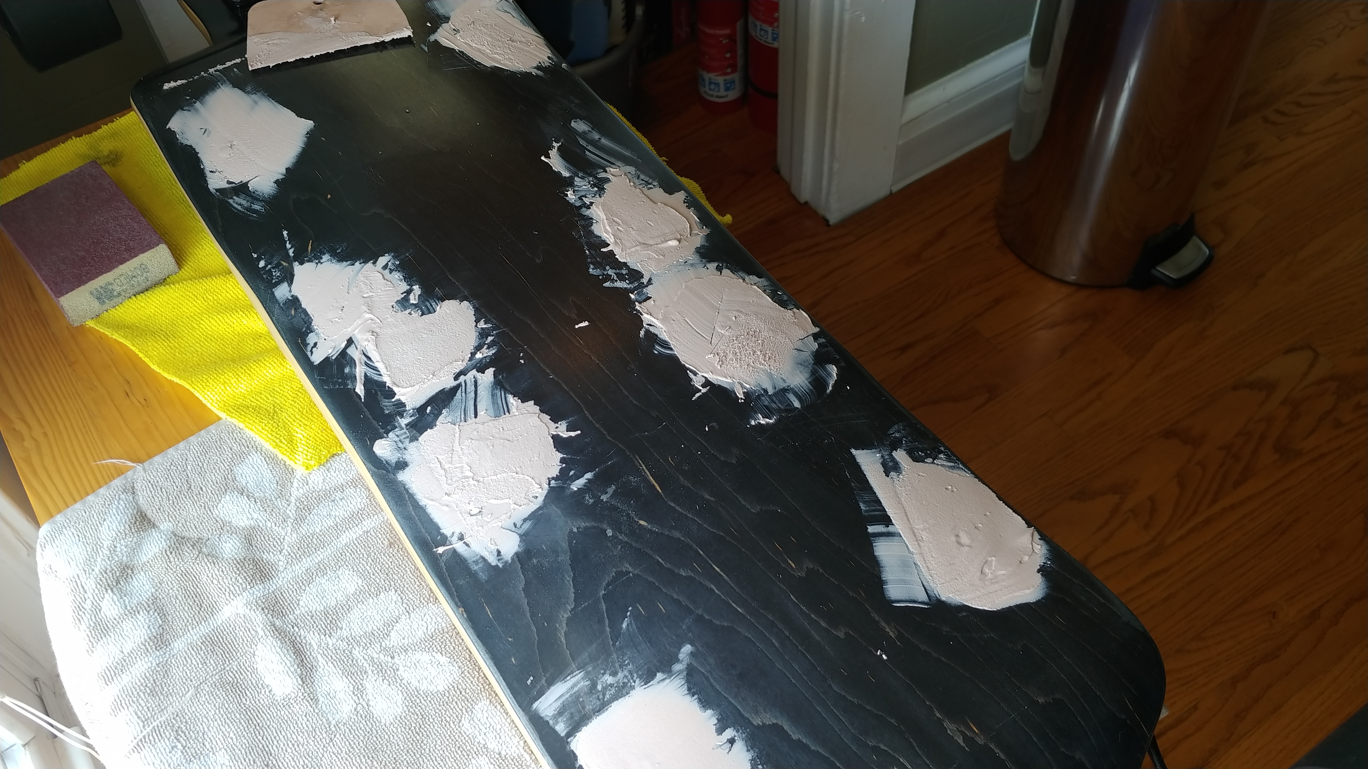

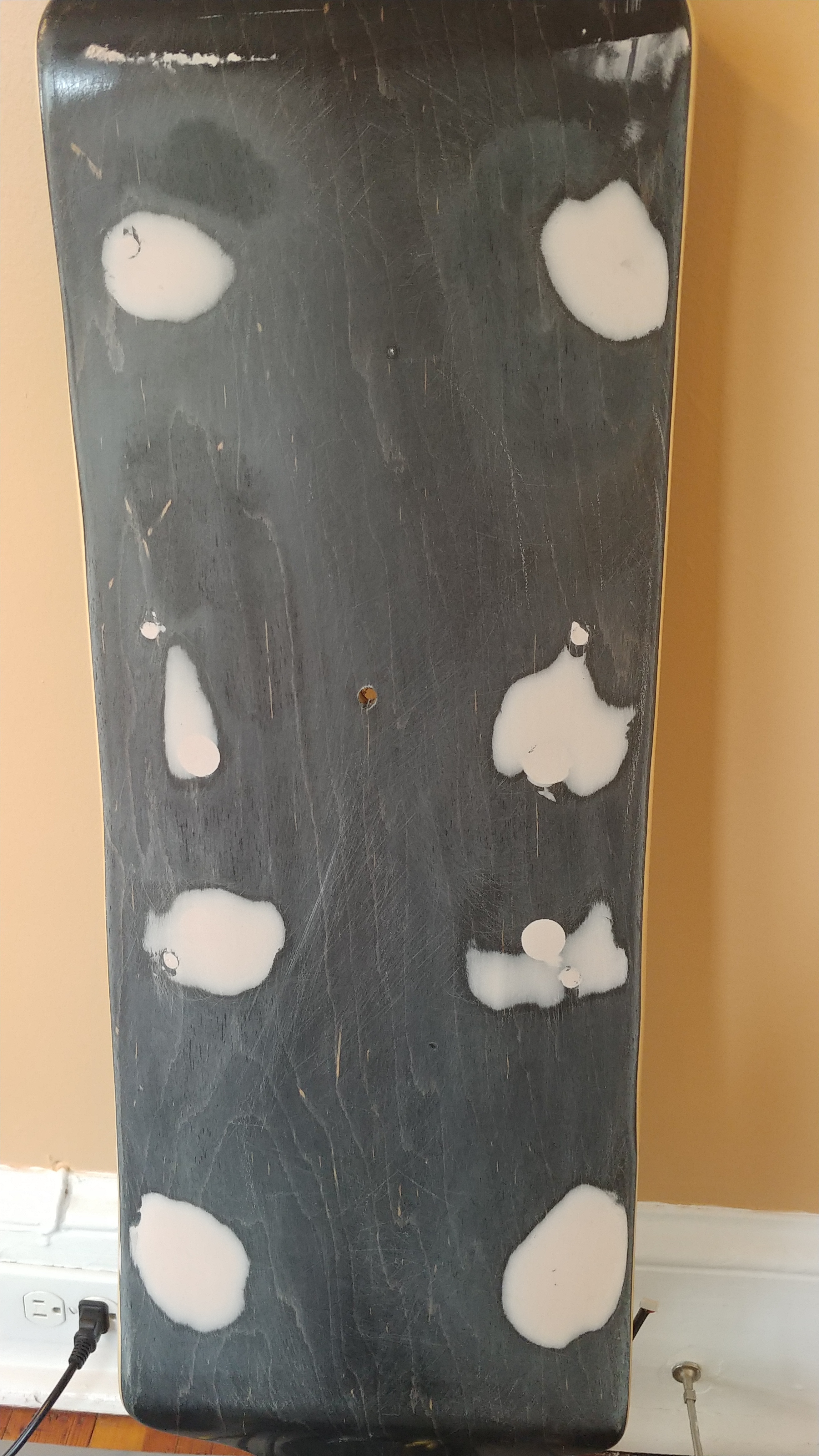

  1. this deck was originally going to have a TB case on it… then I build a different deck with a diff case and now circling back to this build obviously I decided to go top mount. Soooo, I pulled all the inserts… and filled with bondo.
Id also like to mention that Im attaching the case using T-nuts… i didnt want them to show on the bottom side so I used a paddle bit to countersink em in the wood… then came back around while I was doing bondo and glazed that over too. I will use a carbon fiber vinyl I had already to skin the bottom of the board for a fresh look. Im not looking for perfection on the bottom, just clean and simple.
after sanding things fairly smooth

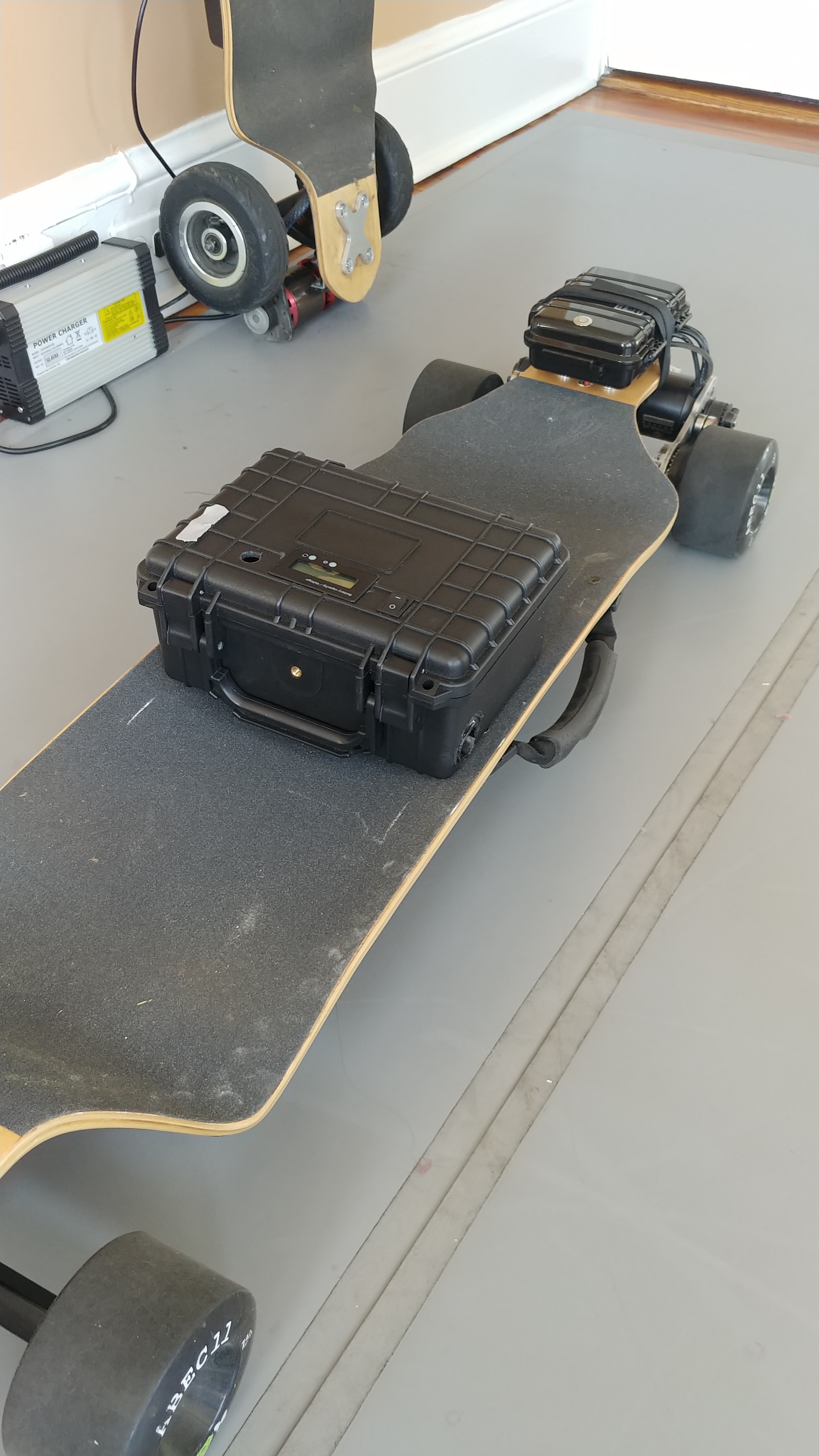

so pretty much finished everything today and got a test ride in… heres just a couple pics but more detailed ones to come to fill in the blanks…
not sure how i feel about the cables running down the side and the appearance BUT what u gonna do when its a big drop deck on thane? def cant run it under as its low as hell…so stuff is half secured and half mocked up in case I want to change something. the box barely fit everything and was a tight, very tight squeeze for all this.
I havent ridden on thane in at least 6mo so it felt kinda weird…but with it so low it was super stable and super carvy… probably could use some slightly tighter bushings. I also am rocking 18/36 which is what I had before I went to pnuemis and yet it felt kinda of underwhelming from what I remember =/

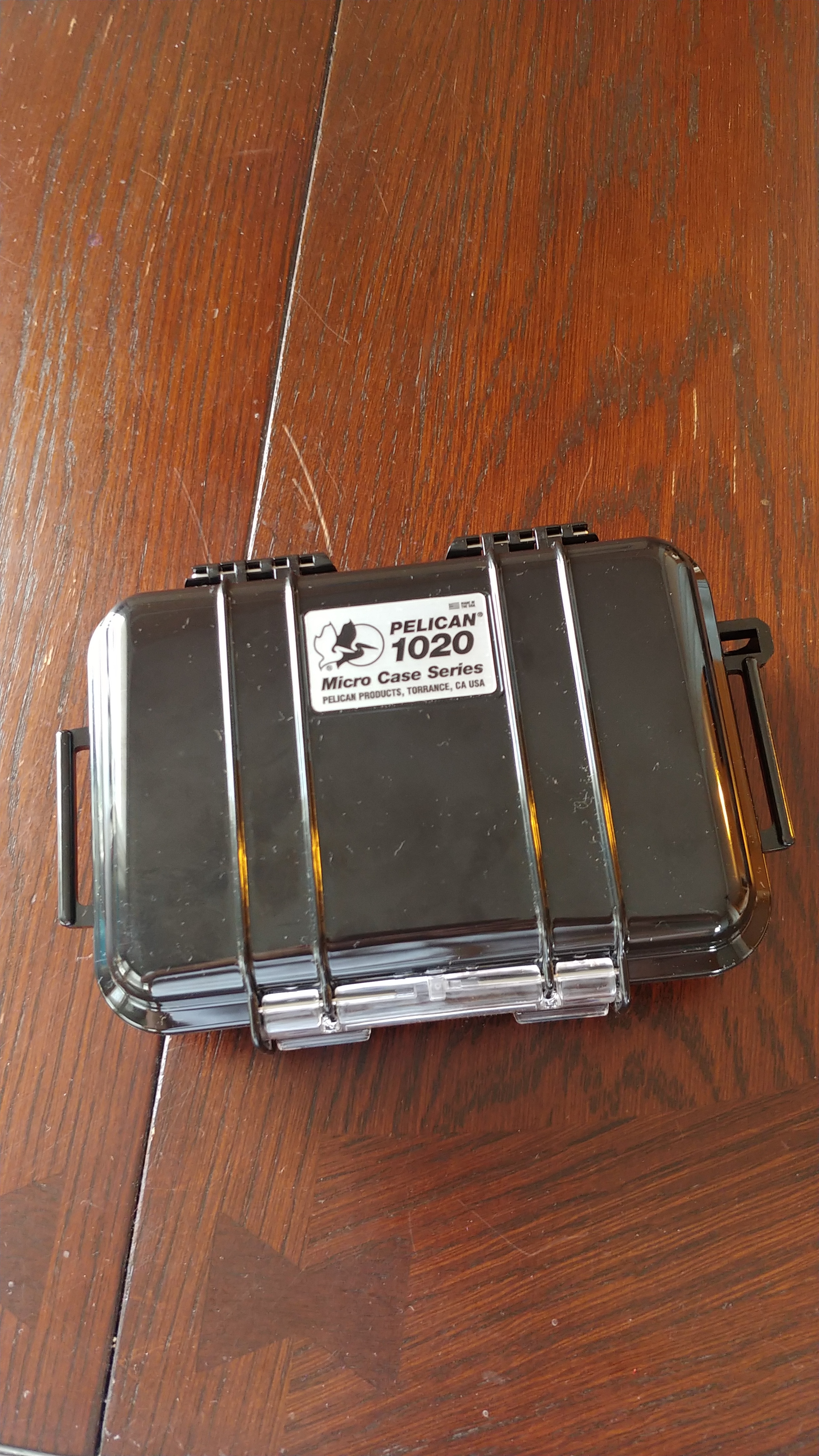

So I dont like running the wires down the side to the esc… No option with it being a drop as mounting underneath isn’t safe… So I’m going to try rear mounting just the esc and just running a power line to the rear… I saw some nice esc cases for unity… But like most peeps I’m on a budget… I saw this micro case on Amazon and its just under $20. Will try.and.mount and test this week! Thoughts?
The little box seems like a good idea to minimize wires running past your feet. If you have the means, how about routing out a small channel along either edge of the deck, inlay the pos & neg power wires into each channel, and bondo/epoxy/caulk them in place, so the wire ends come out near each box? Hopefully this makes sense, but that could pretty much hide the power wires in the deck edges under your heel and toe.

a lil progress today… more detail pics to come…but this looks wayyyyyyy cleaner… dont mind the velcro that was for the test ride till I figure out a better option to secure it.
Im hesitant to use screws to screw it into the board only cuz I dont want to have to remove them if the truck hardware needs to be tightened but… hmmm… otherwise everything fits nice n snug inside…
Secured to deck and everything fits just right… Hopefully road vibration doesnt break anything but otherwise this board is ready for service! The nice thing is it also feels light since I’m always lugging around my “tank” 12s5p dual 6374…
