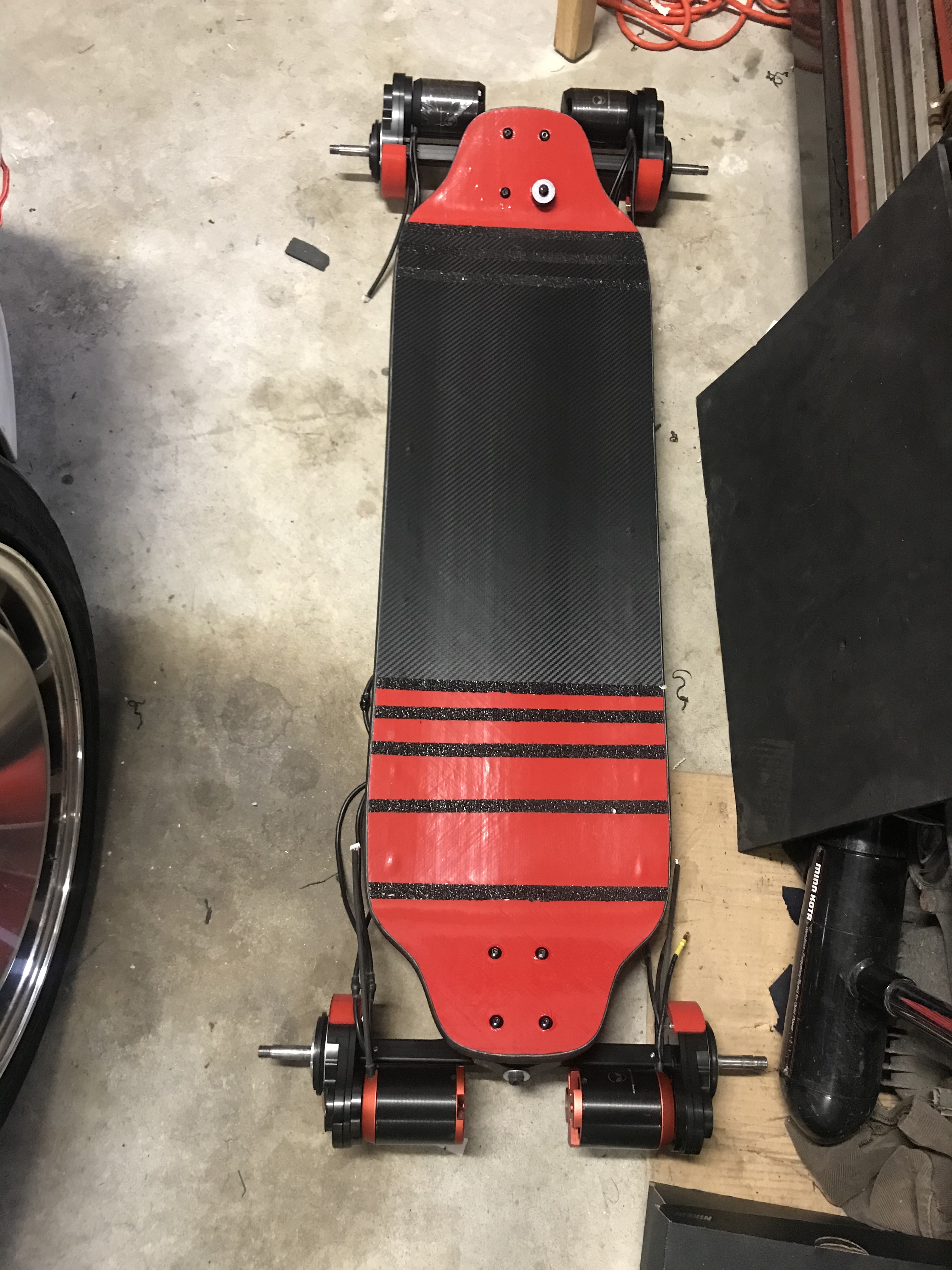

The Outlaw Star - "what has come” 4WD | 1:42 3DS | 6380/4 | Flux | 12S9P 50E

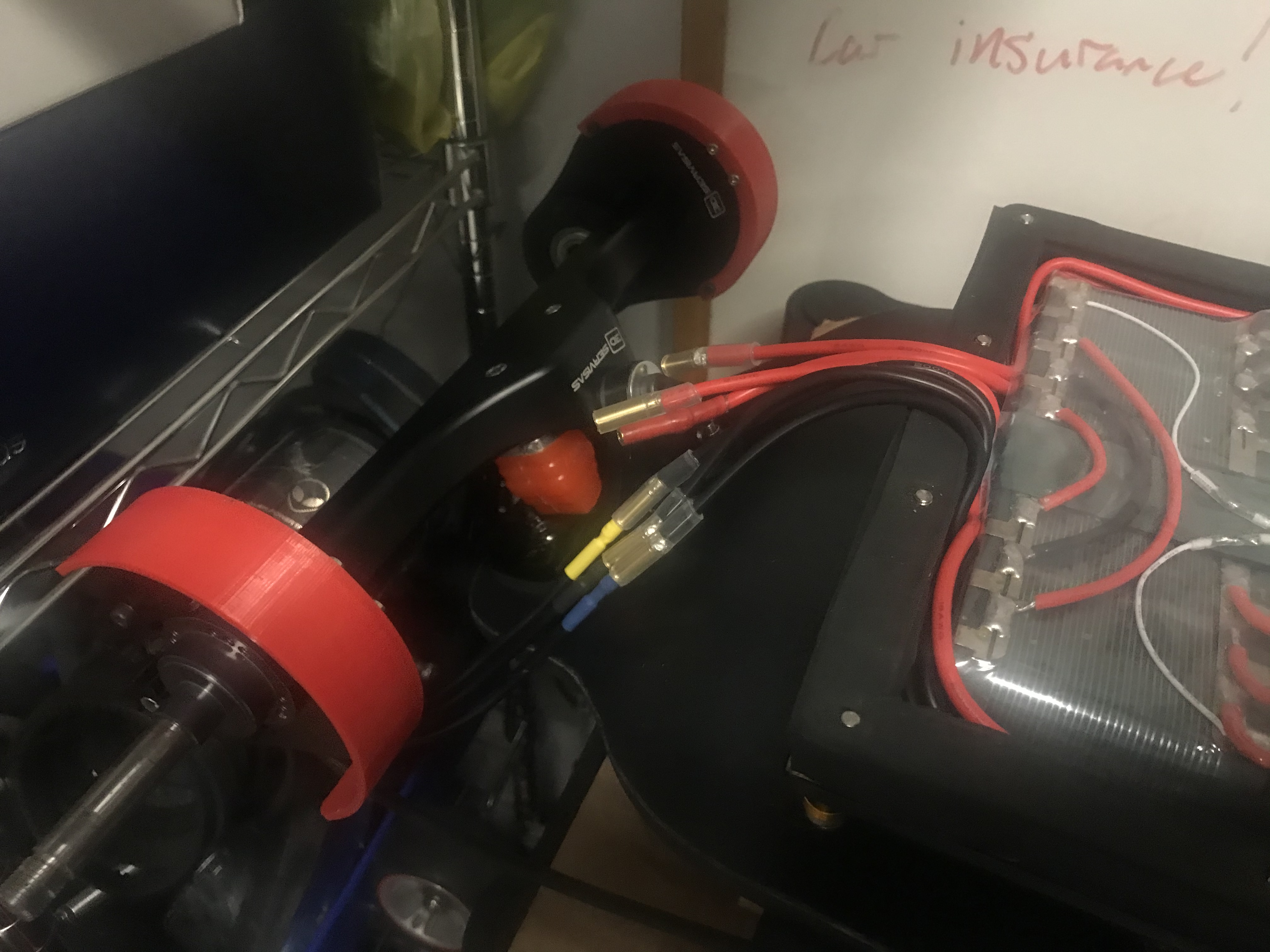

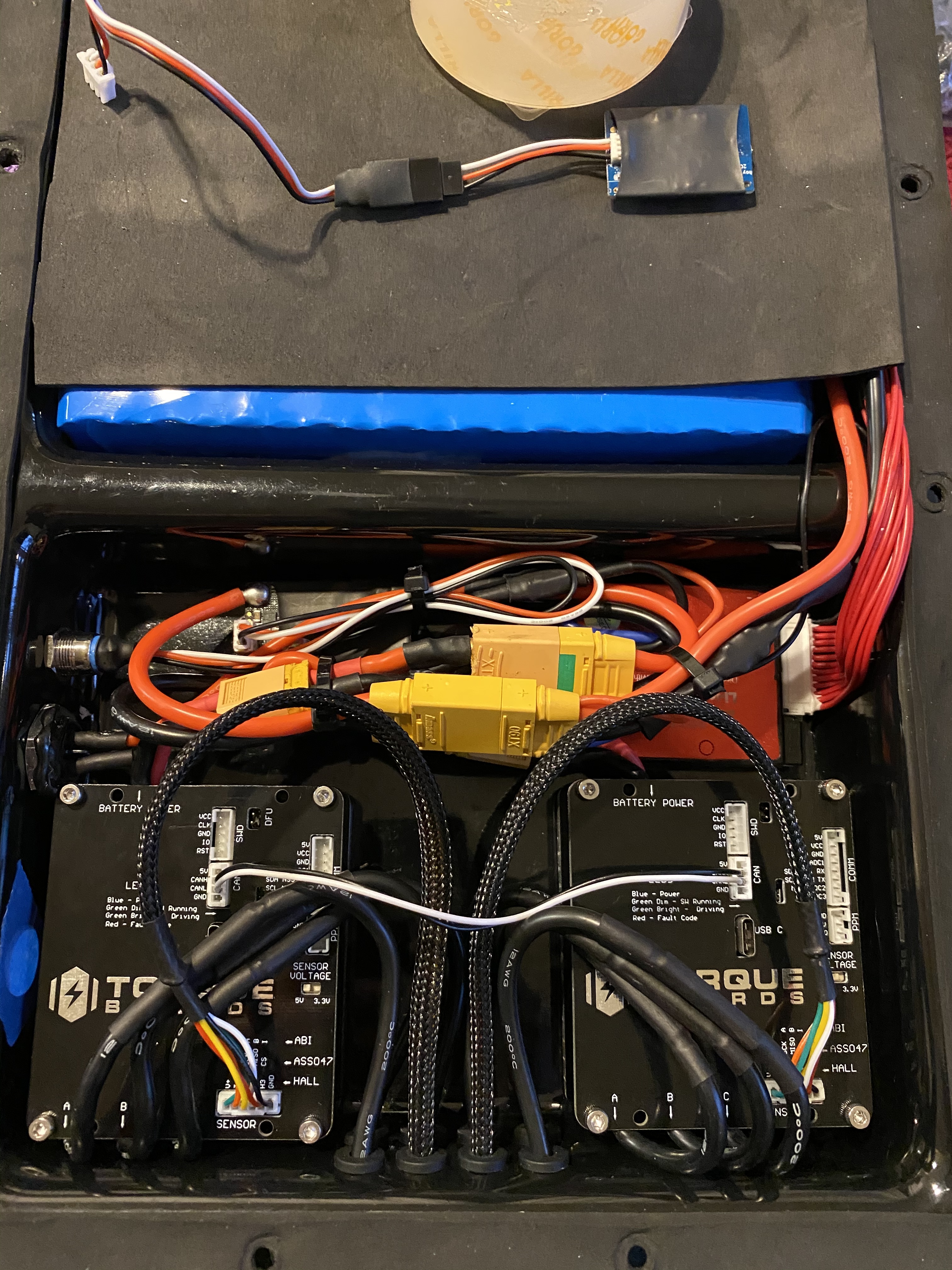

Janky heat sink I made outta some spare mounts:

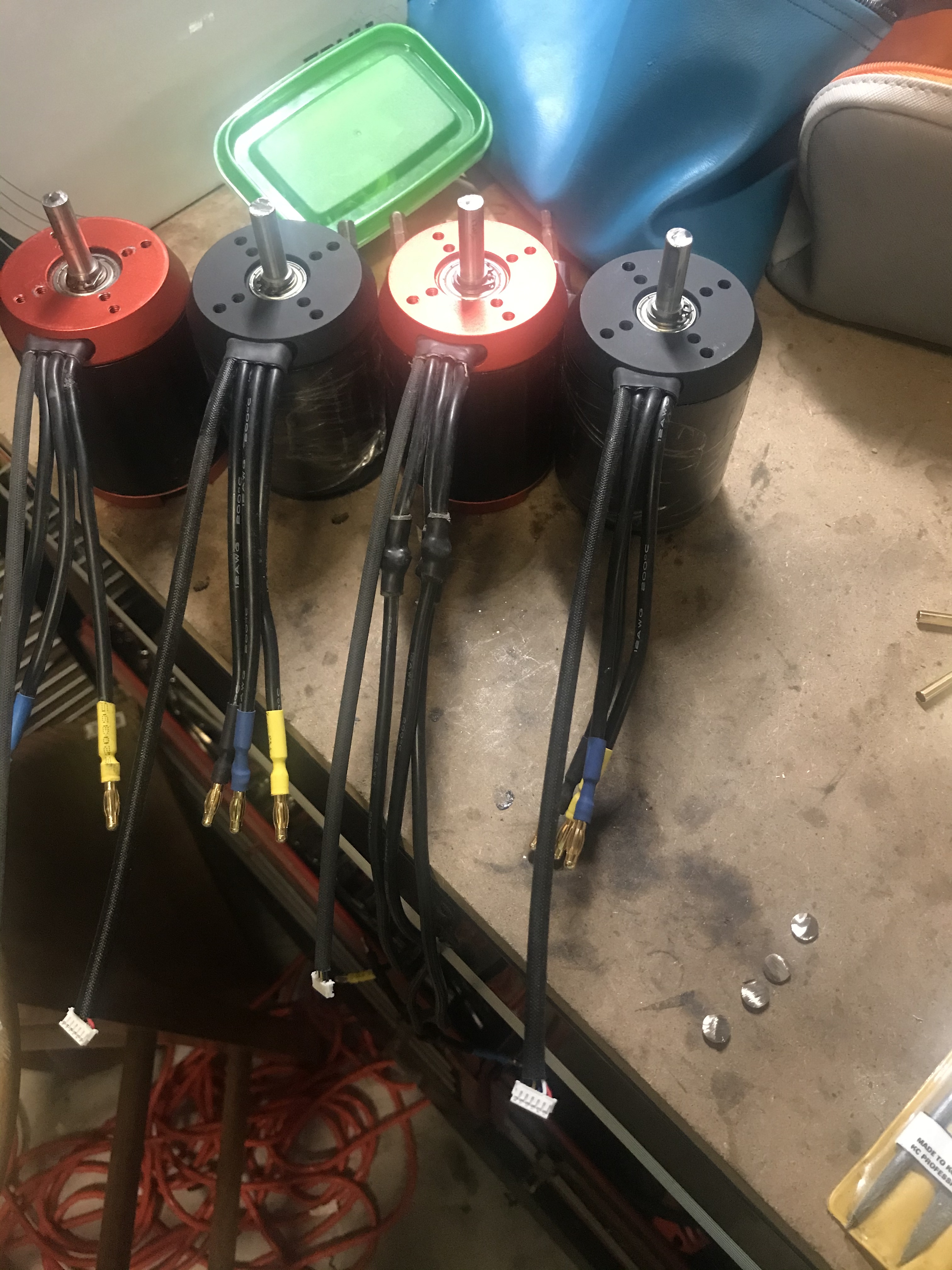

Got @torqueboards’s controllers going too! I wana see how many miles I can get in before I get thermal throttling on these and that’ll be my baseline the coming 4wd set up.
Need to figure out how to match the pin out on my metr pro to these guys

Love your heat sinks. I mounted mine on some 1/4 aluminum plates

Lmao. Right or left meaning the connector in the Vesc has 8 pins And the module harness has only seven wires
As for Vesc goes
Ppm/uart 115200 bps for master
Uart for slave
It should work just fine
Yes doesnt matter if you plug it into master or slave, just make sure both vescs have app set to UART. You will have to manually change this on each one. You can’t just change it one one vesc and write via can. But then should just be plug and play

Sad news. I’m taking the phattys off. I had a bead failure. Causing the tube to get shredded. Luckily I didn’t fall it happened at around 15 or 20. Unfortunately it messed up the gear casing by rubbing away material:
Pretty bummed about the 200x75’s they fit the size of the board nicely. I’m going to stretch some of my old red primo alphas on these widened superstars and hopefully they run well. Really wanted to think the other 200x75 failures were isolated issues but I can’t think of anything I did wrong when installing. Today was the hottest day I ran these tires so I feel like that allowed them to deform and stretch over the lip. This happened after 4 miles of riding today. Up until this I had put around 100 miles on these tires/hubs

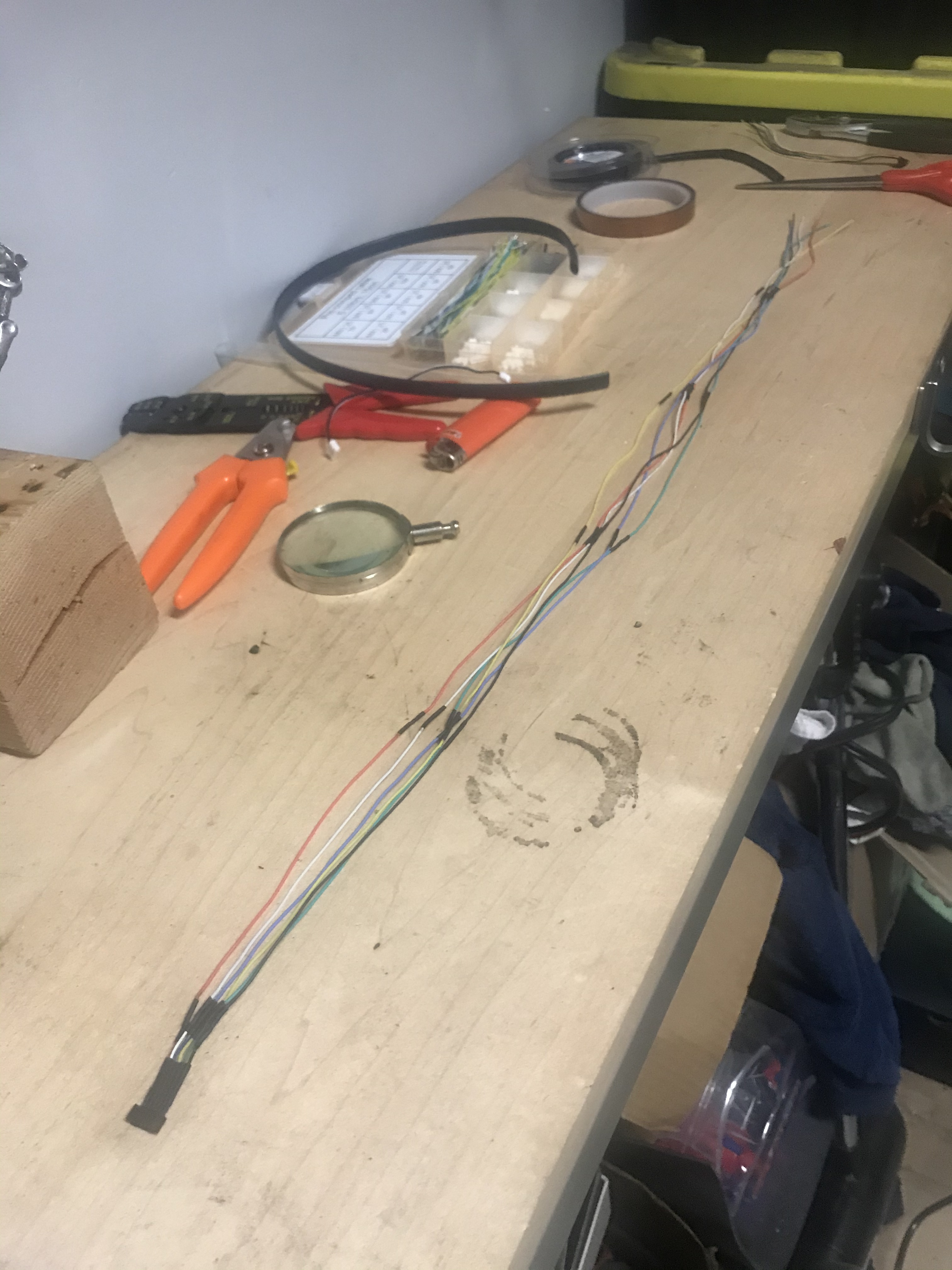

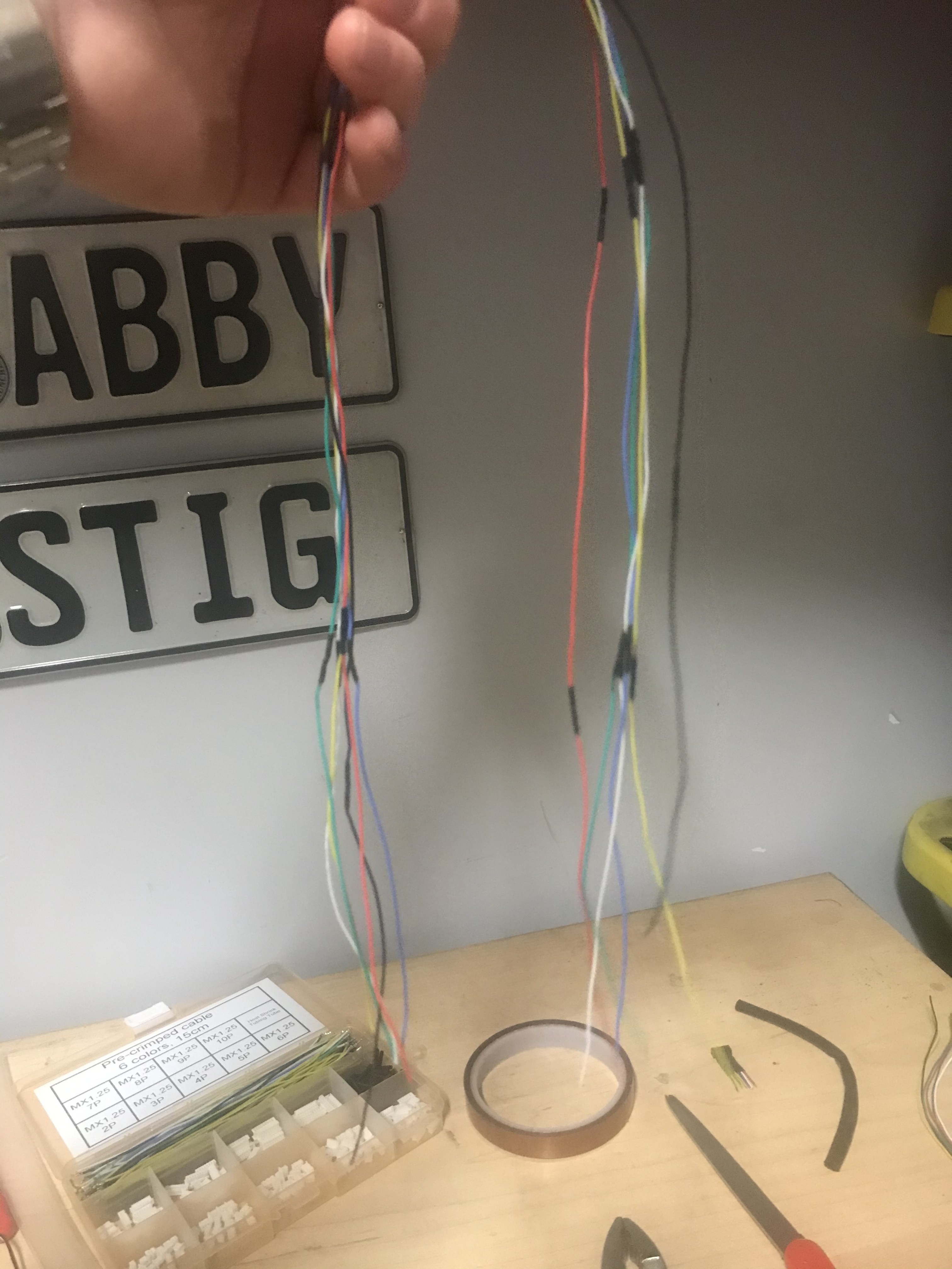

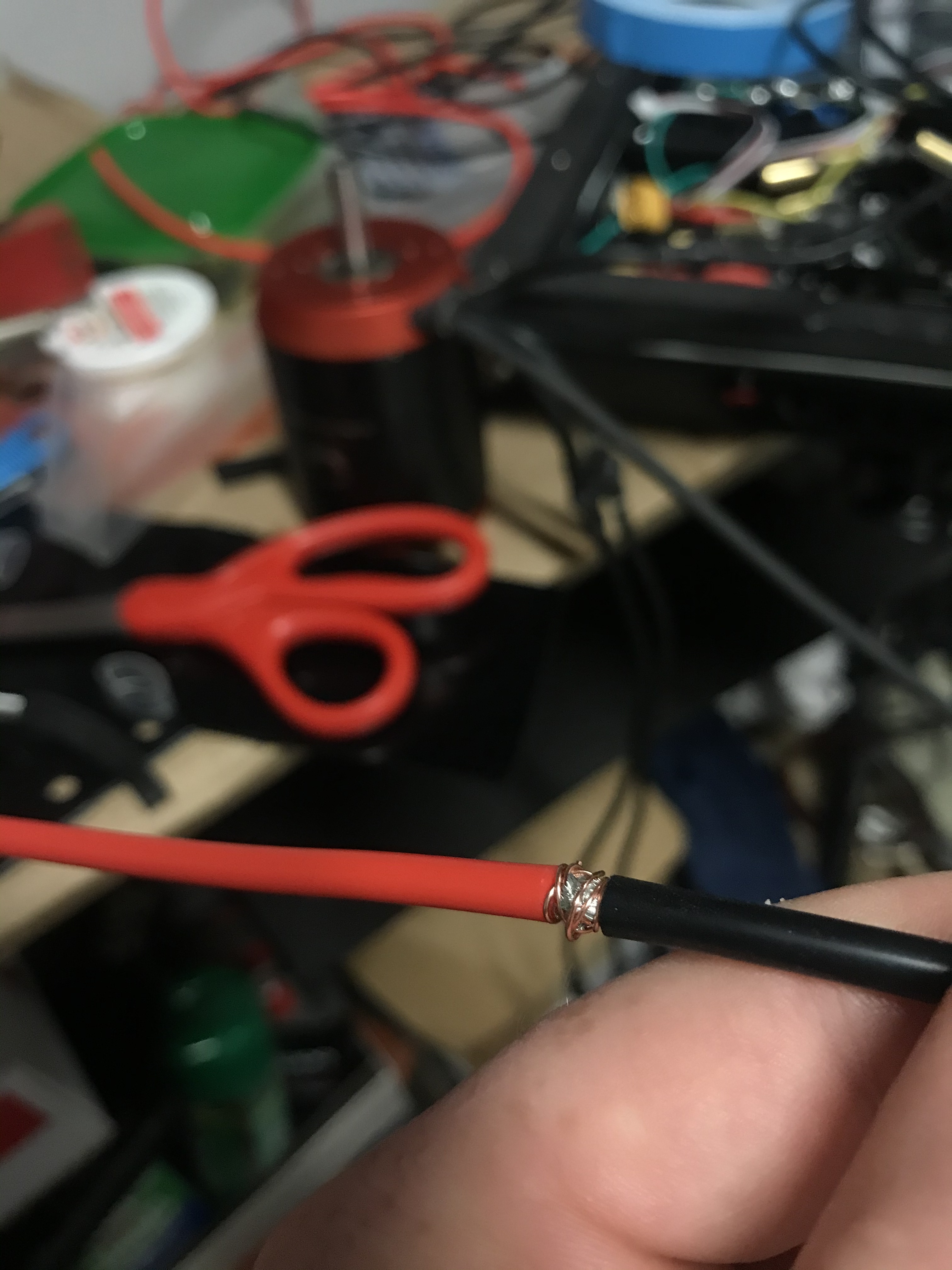

Been soldering away got a “fancy” new soldering iron because I was over my piece of shit weller.

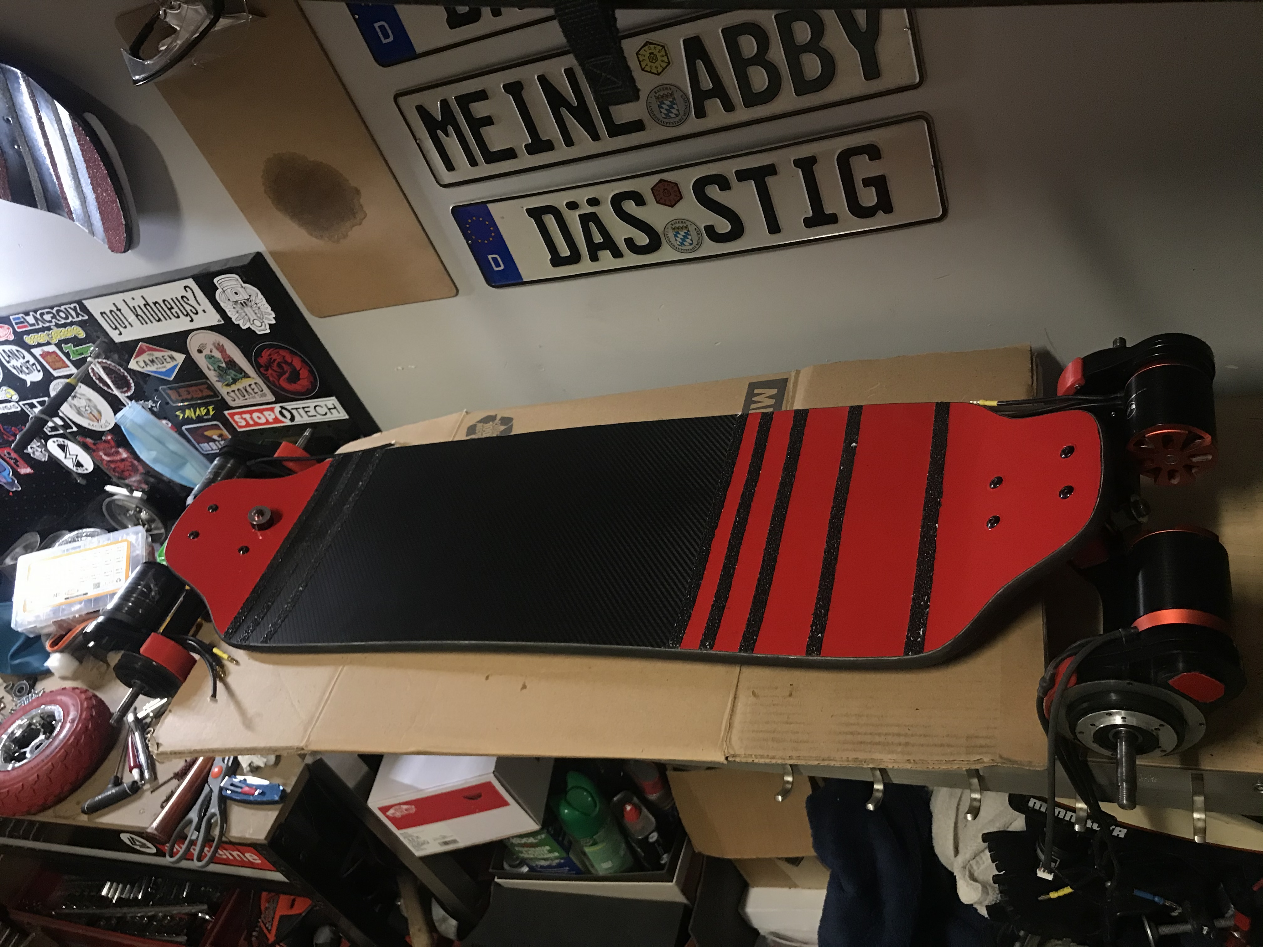

Pics of the current state:
Need to by a 20 ohm resistor for the 5V connection between the two unities, and then I’ll have all the hardware. Looking to get it going before the weekend!
