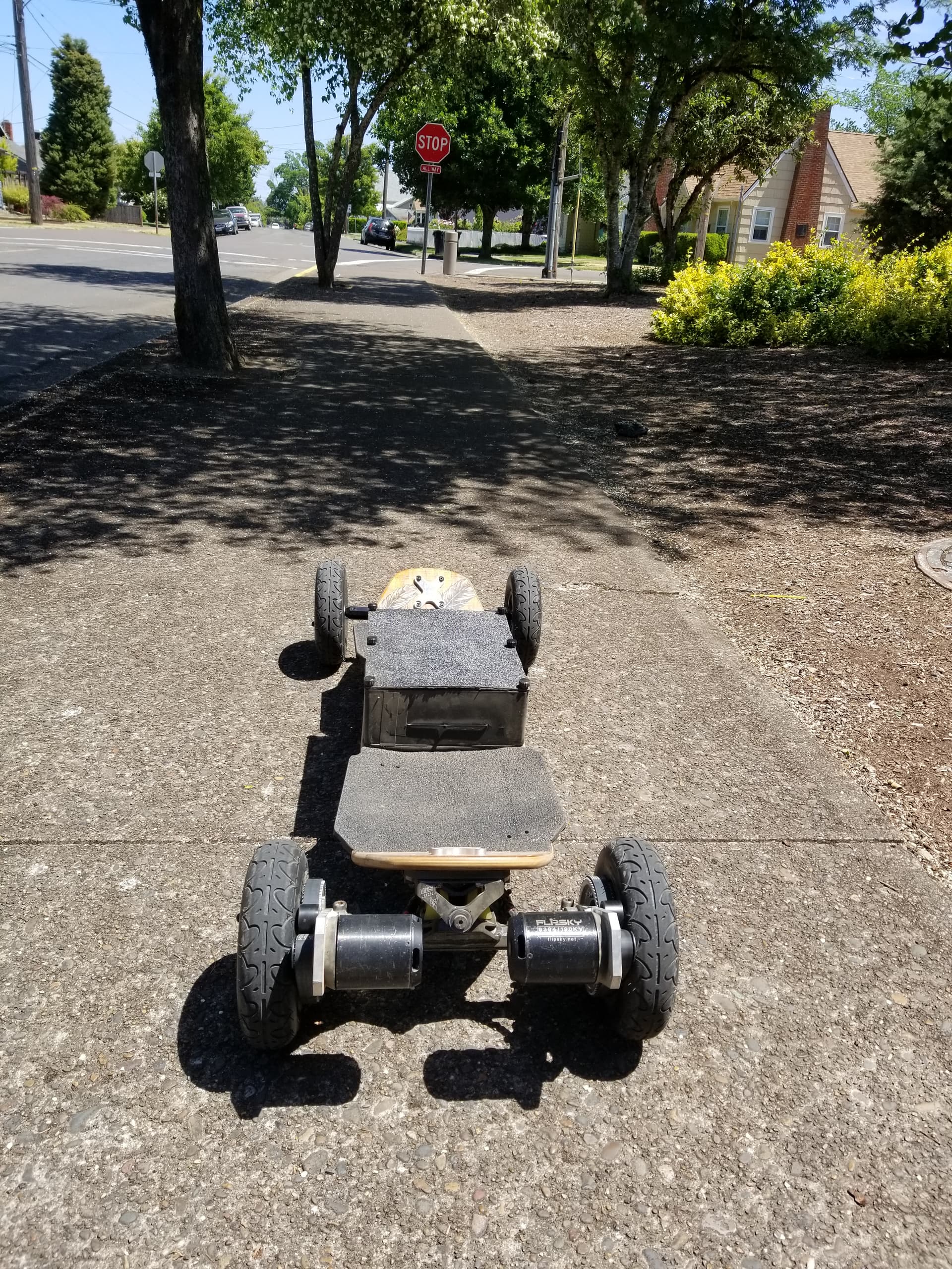

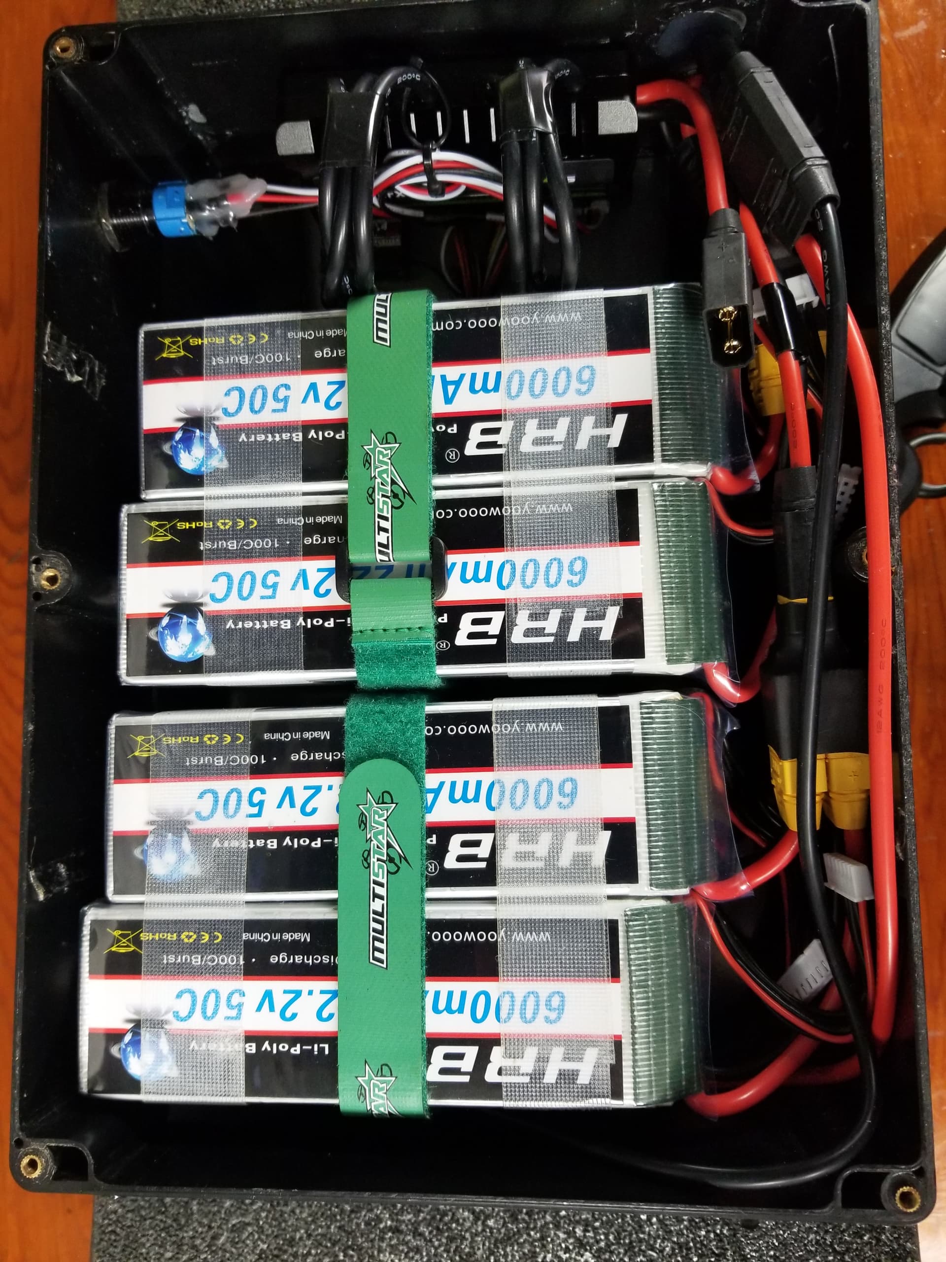

Quick field report / torture test… I installed the DV4s into a MTB build and set the motor amps to 100A per side. It’s powered off a 12s lipo and was placed into an enclosure with no air circulation.
On Saturday I took my daughter on a 1.5 hour ride in 80’ F temperatures. It was a pretty aggressive pace for the whole ride, but was able to cover all kinds of terrain (pavement, dirt, gravel, cobblestone, etc.). The DV4s took the beating just fine and never got hot to the touch. I’m very pleased with how well this thing performs.

I don’t remember what I set the battery to. It’s cranked up though, because 12,000mah lipo.
