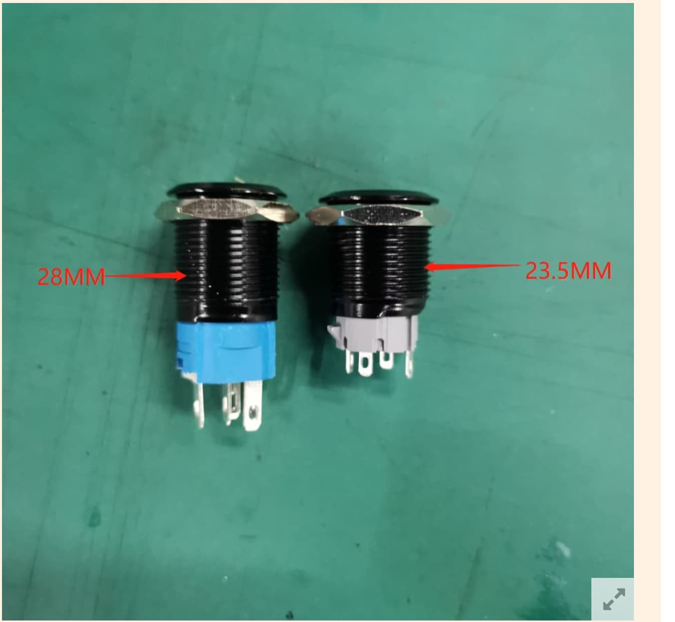

momentary just means the type of switch in its mechanical construction, the function of the switch is what we r after, usually written as NO or NC switch, which refer to Normally Open or Normally Closed switch. they function the exact opposite of each other, but both can be made as momentary switch
Same switch came with a buddies d75 last week.
Let me know if you find a solution, hes using an apex box as well.
there is, found a 21.65mm long 16mm dia NC switch (green led). im going to test it with my dv4s before asking if anyone want it
Not all heroes wear capes.
16mm dia or 12 mm dia are ideal.
@YUTW123 Is there a way to make the DV4s use a NO button?
That’s a problem.
I will change them in the later PCB update.
We also have a shorter button style, you can make a note while order…
