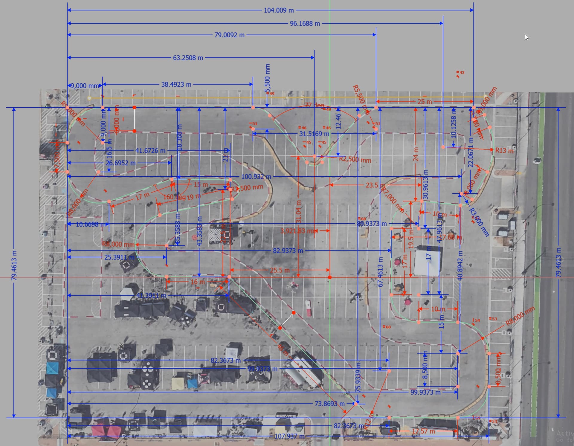

Inching my way to sub 13 sec laps and getting reclaiming that #1 spot on the T leaderboard back from @JeffyJ . Not much has changed in my approach - trying to accelerate earlier and brake later.
Indoor Track night is coming up in a little over 2 weeks. Really keen to see if I can claim the track record, but also need to allocate some time to get some much needed overtaking practice!
Also very excited to set this one up over the next couple of weeks :eyes:
What track is that?
Esk8con 2023 track
Damn, team erl is gonna be coming in hot.
