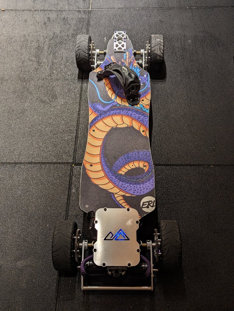

Here’s my newly finished/rebuilt raceboard, after a handful of iterations. I come from primarily snowboard & mountainboarding background so my original raceboard was essentially a mountainboard (from 2wd to 4wd). As great as it performed and as close as I nipped at @JeffyJ 's heels I was still lacking manoeuvrability around hairpin turns on the track and tended to slide around quite a bit when pushing the old mountainboard trucks to their limits. As well as loosing stability over 60km with my front barrels set to the inner settings.

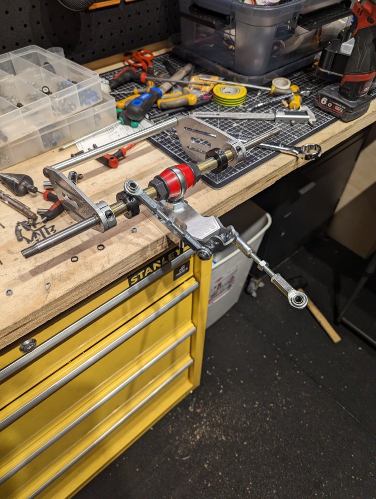

That’s where @MoeStooge 's 3-links came in. I’ve been eyeing them off for a long time and had originally planned to use brackets to mount them to my Haero Bro Rzaca 21 deck, but ultimately decided that it was time to move to a drop deck and couldn’t be happier with the result.
While I’m playing around with the motor amps & throttle expo to find my sweet spot, I know the board still has quite a bit to give me. Within the first couple of times riding it I’ve already improved my track times each time. The handling is insane and the shorter wheelbase suits my short ass perfectly! I plan to upgrade to @MoeStooge BRP’s very soon and can’t wait to see the more improvements on track times!
Specs:
Boundmotor octopus deck & enclosure
126p Molicel battery by @glyphiks
2x Maker X Dv6’s
2x 6385 190kv motor on the rear
2x 6355 190kv motor on the front
18/67 gearing ratio
Stooge 3-link trucks
Trampa deep dish hubs w/ Meepo cyclone tyres (primarily for polished concrete race track)
Here’s a collection of photos I took, from stripping down my original racer to building the new one

Haha there’s no way I can take this thing on a group ride. I’m far too reckless to risk the super low 20mm clearance on it. It’s definitely a dedicated track board.
I’m considering building out a cruiser for group rides using the MTB deck I just pressed… just want to put my esk8 money towards a couple of sets of BRPs & a 2nd set of gears first
Nice 20mm huh wonder how low mine currently is. Whats the side shot with full lean look like? How much clearance do you have at that point?
The brace across the front motor mounts is the lowest point and that stays parallel to the ground when turning so it isn’t really an issue

Just claimed #1 spot on the t race with this setup
Damn bro look at that lean, a bit more and you might be scraping :stuck_out_tongue_closed_eyes:. Congrats!
This is such an amazing picture.
