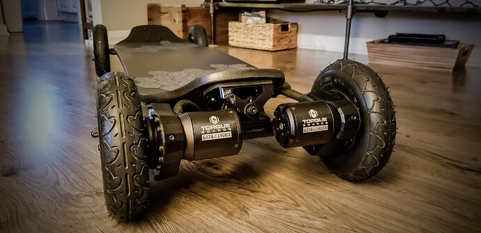

Welp, the Moon drives are fully assembled and she’s back on all fours. I’m really impressed with the build quality of the Moon hardware. The design is very elegant and the fit/finish is top notch.
Here are a few notes in case anyone else is considering getting these drives for their MBS builds:
  • The only items that you need to purchase is loctite 648 and grease. @moon includes everything else needed to complete the install.
  • It takes a bit of finesse to get the truck clamp centered on the brake hole. Once aligned and fully torqued, the clamp is extremely secure.
  • The 6374 motor size is perfect for the MBS trucks. This motor size allows for some uptilt without any interference with the MBS baseplate. In this configuration, the motors are completely shielded by the hanger. If you are running 6380 or bigger, the mounts will need to be tilted downward to be more parallel with the ground.
  • I’m a big fan of the fixed motor position with the 9t motor pinion. Not having to screw around with setting the backlash made the assembly very simple. Flipping the hanger is needed to prevent the clamp bolt from interfering with the fixed motor position holes.
Just a few living room glamour shots:

looks incredible dude.
like, super duper clean, boutique production level, if not better!!!

Thanks man. That’s quite the compliment, especially from a builder like yourself.

Looks great! Extra points for aligning the Torqueboards logos perfectly in every photo. That’s attention to detail!

Haha thanks man. Not going to lie, I retook a few pics because the logos weren’t lined up enough for me :slight_smile: :joy:
