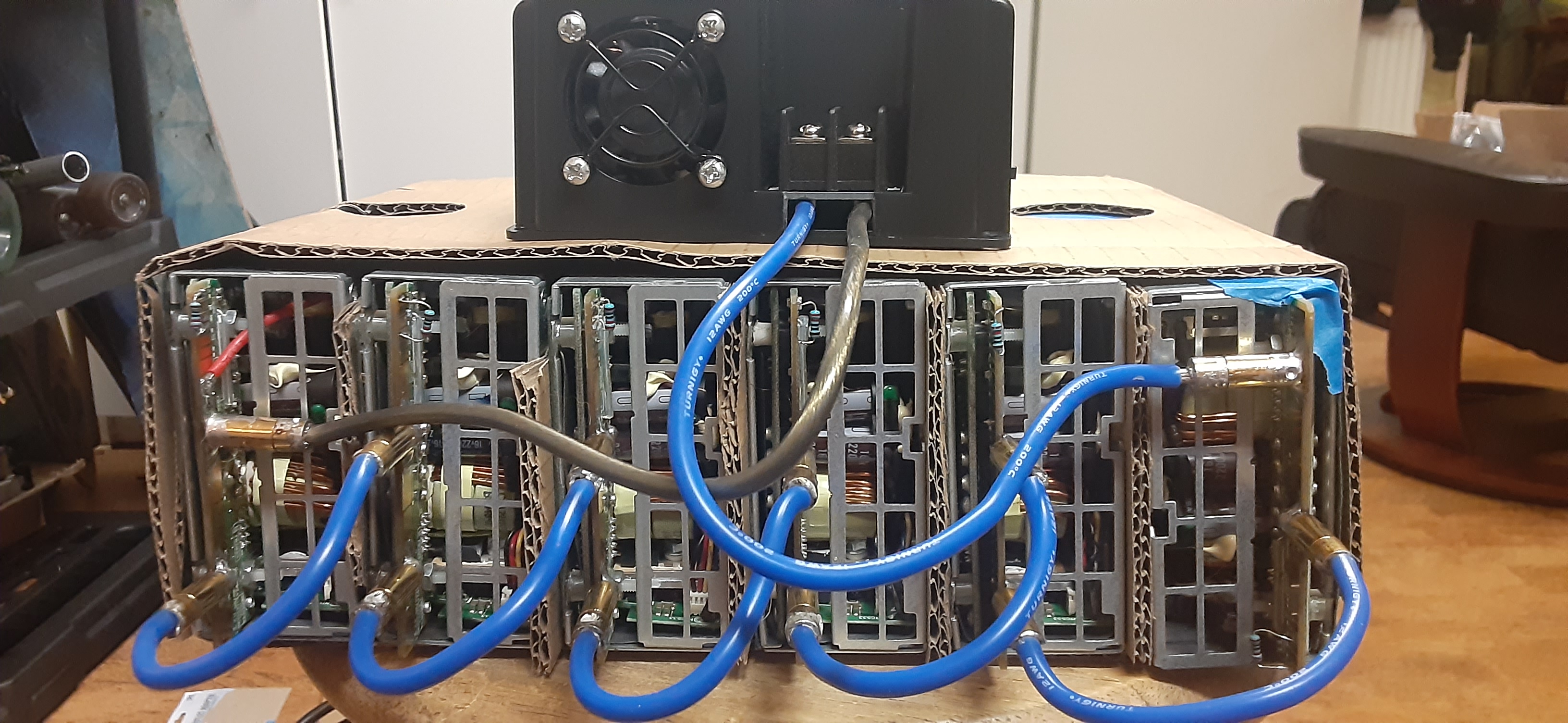

Now that I know it works and stuff I want to reduce the number of cables to the power supplies.
https://www.monoprice.com/product?p_id=5277&gclid=Cj0KCQjw6-SDBhCMARIsAGbI7UhVAwWg_g3aOZSvk51ZmFPNVw78UxtY6bInW6Efsrcg-tkd4wIwHGkaAnJCEALw_wcB
The only why I can think of doing that is by cutting and soldering wires that go to the plug inside all of them, connecting 3 and 3.
Part of the idea being if I connected a higher A DC buck converter then I could run set set of 3 on a different breaker.
Careful with connecting the different logic levels. The end for each individual supply is now at a different potential. So you cannot mix the logic connections.

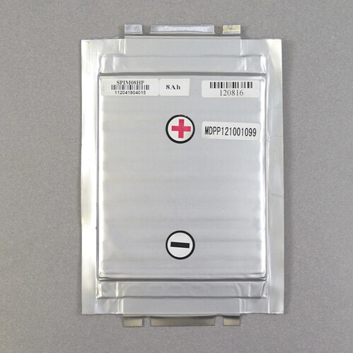

I want to make a battery bank to run the charger off of. I should have all the bits needed to put this together:
Spim08hp cells to make two 12S battery packs
BMS, charger, fuses for each one.

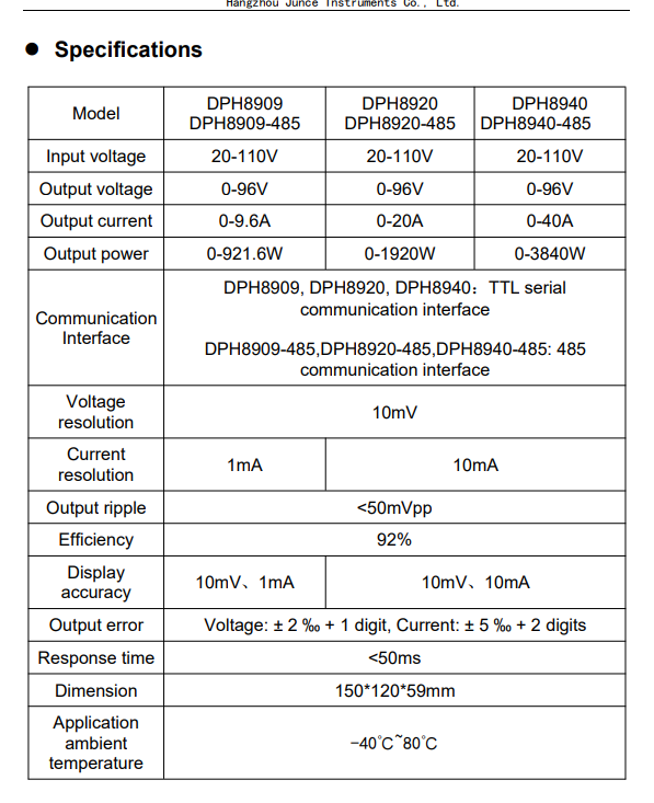

I was a little worried because the unit says/is called 96V but here is is actually max 110V
24S being 100.8V max.

But where do you get these? I thought they turned into unobtainium.
I got the candy sack 100 with free shipping

110v in , 96v out.
Like any converter, some voltage drop is expected.
Mind you. 14v drop at 20amps.is a wapping 280w of heat. That’s a small hairdryer…
eh, it’s got a fan. As long as that stays moving air it should handle 20A for a good period of time. looked chunky enough in there. Not too complex and soldered very well.

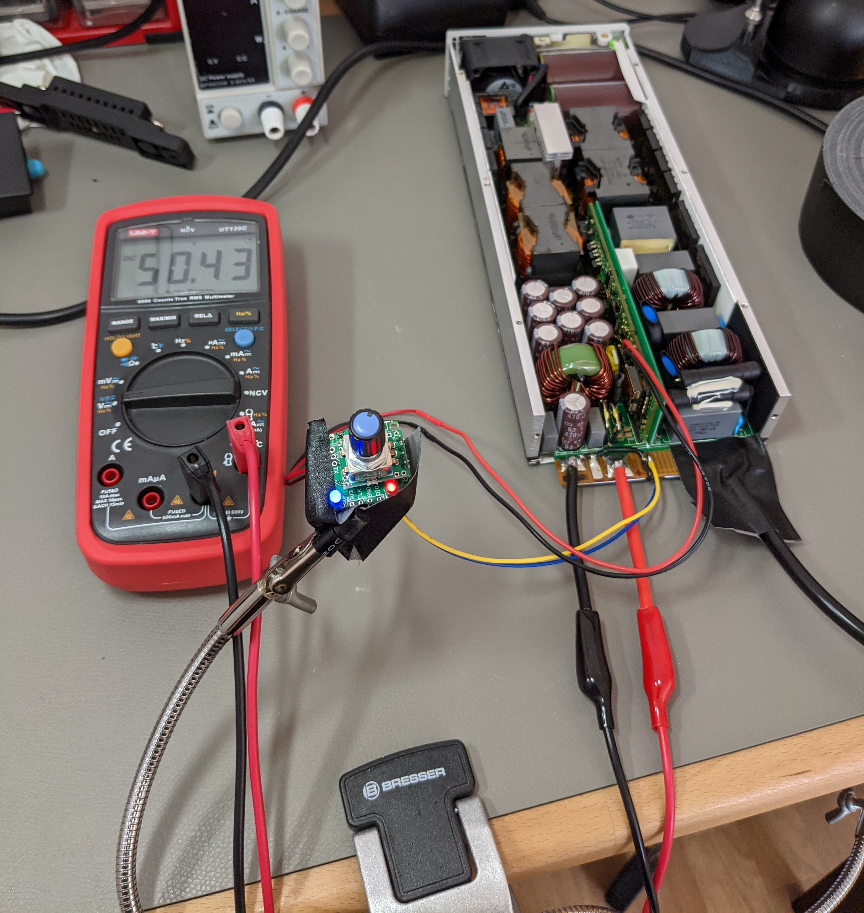

I’ve actually ordered these parts and am now in the building process of this psu :smiley:
seems to work pretty nicely for now.
adjustable voltage range is about 39V to 58,5V and current adjustment works too.
I’ve not yet tested it over 10A yet because i don’t have a big enough battery to dump all that current into.
an enclosure is coming soon too
