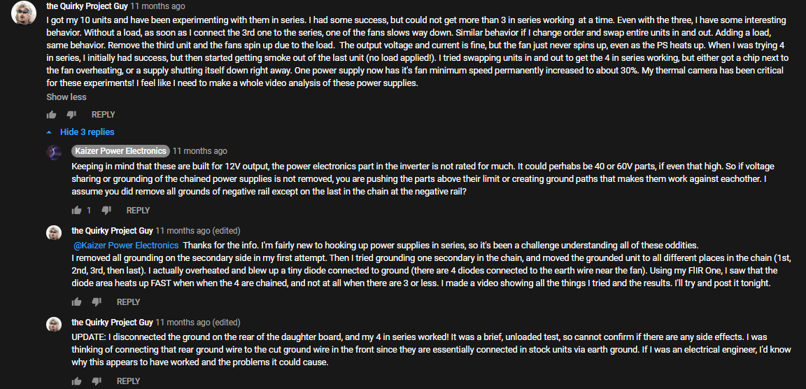

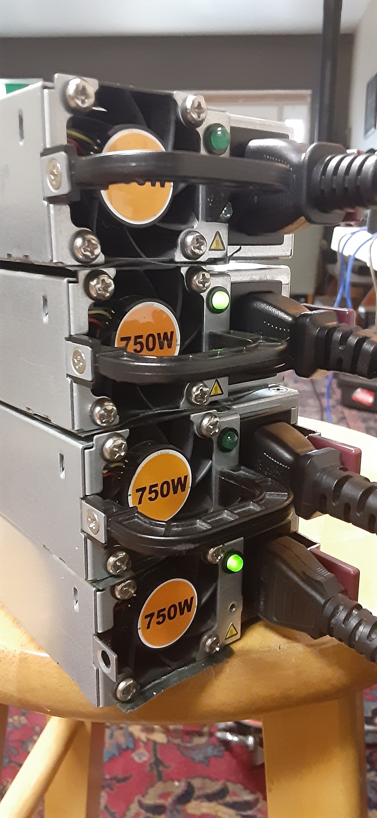

The first issue I ran into is when series connecting 3+ power supplies without the AC ground isolated the fans will spin faster as more are connected.
I attempted to solve this by isolating the ground on all but one power supply.

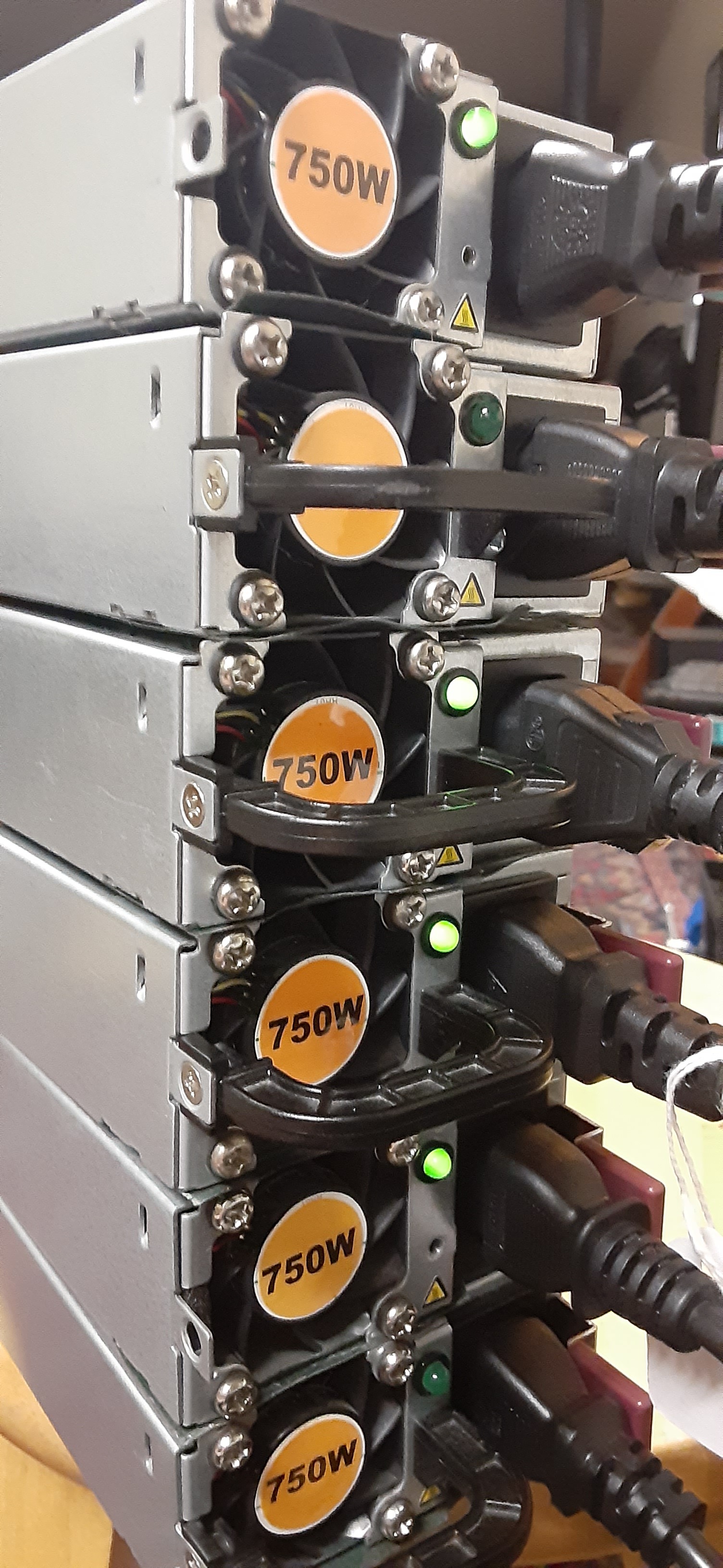

This results in this from the LEDs:
The first negative light is off as well as the 5th in series.

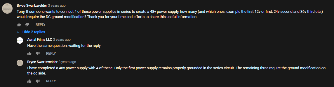

Apparently I need to have the DC ground tied to the AC ground on one of the power supplies

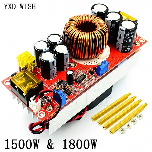

There are quite cheep DC to DC converters out there I use this one quite a high output and use a 12v server power supply, to supply it.

These are comments on a video specifically about hp DSP-750s PD18
This person seems to have solved the issue by removing the wire on the back of the daughter board by the fan to the case. Worth a shot I guess. Makes sense to be because the fans were freaking out and this would remove the link from the fan to the AC ground.

Just got done trying with the removed daughter board ground, now every other supply turned off.
I’m starting to think I really need to gave the first series power supply negative rail tied to ground for whatever reason. People say this doesn’t matter and you can leave one grounded or isolate all of them but it’s one of the few things different I am doing.

As I was suspecting, removing the screw on the daughter board solved this isolation issue.
so yeah, removing the screw from the daughter board to the case completely isolates SOME of the power supplies. Others are totally DC isolated with this wire still attached. Taking a wild guess I think it has something to do with the jumper making them power on. I have no clue why
