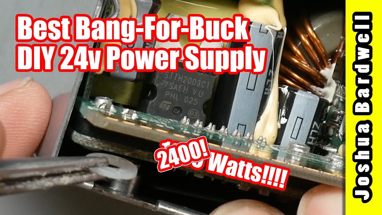

I just found this and it looks like a nice explanation of the isolation steps.
actual demonstration starts at 6:50
I guess it is hard to know what exact steps are needed for whatever power supply you get. Your cardstock choice seems very general purpose.
oh jehu did a video too
guess I missed that
he covers the isolation in all of about 30 seconds.
Yup lots of info out there. I kind of mentioned it but each supply Model is different.
I tried to give it a general explanation. Ut yeah you’re right. 25 minute video explaining bot much haha
it has all good info, with only the occasional drill shart noise interruption. The issue being you need to watch it more than once to really understand from a beginner perspective, and it seems daunting and confusing with all the info not following along at the same time.

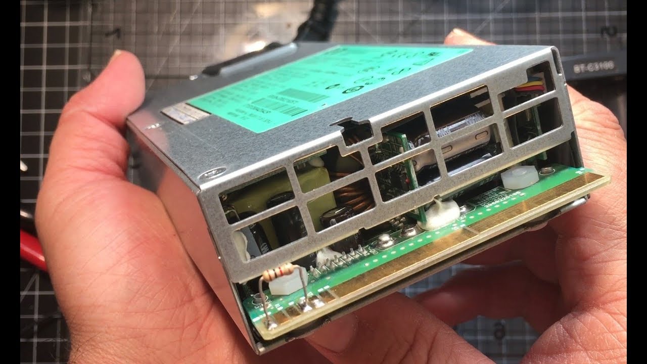

Guess it would be cool if a bunch of us could get different power supplies and all show how we do the isolation.
This is a nice resource for the low voltage enable stuff
https://pinoutguide.com/
as far as isolation. you just have to look it up before hand. I recommend getting other supplies if you cant find a clear answer pretty much immediately.

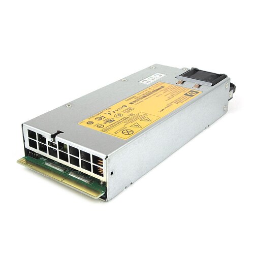

found this
https://www.newegg.com/hp-656363-b21-750w-power-module/p/N82E16817292067?quicklink=true&Item=9SIAMGHBZP0572
$5 cheaper
Those are great. Probably the best form factor and density

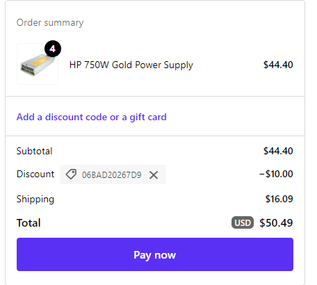

These are the ones you recommended and a solid price, 6 has $21 shipping but 10 is more than double shipping.
$88 total is better than what I found on ebay
Oh they have a “rewards” system that gives you a $10 discount off the bat
it was cheaper for me to order 6 and 4 separately than 10 at once, I could have even made a seperate account for each one and got two $10 discounts.
I spent $138 (could have been 128)
vs getting 10 in one order:

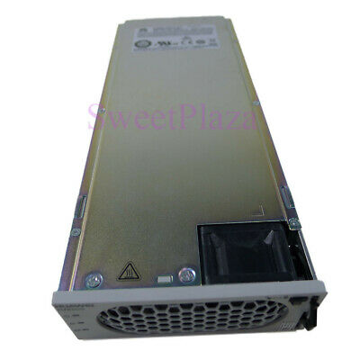

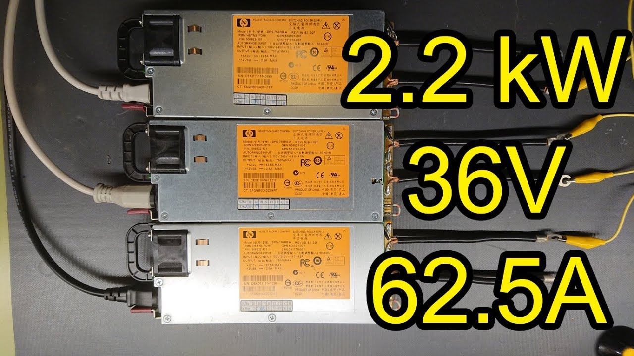

Would it be a good idea to get two of these 60V 24A
vs one 60V 50A
With two connected I could set them to charge a small pack and a large one at different rates.
Two dc supplies in parallel are tricky. Much like battteries you wouldn’t want them exchanging current. It’s doable since you have current control. But you need to be careful. Don’t let one supply try to dump current into the other.

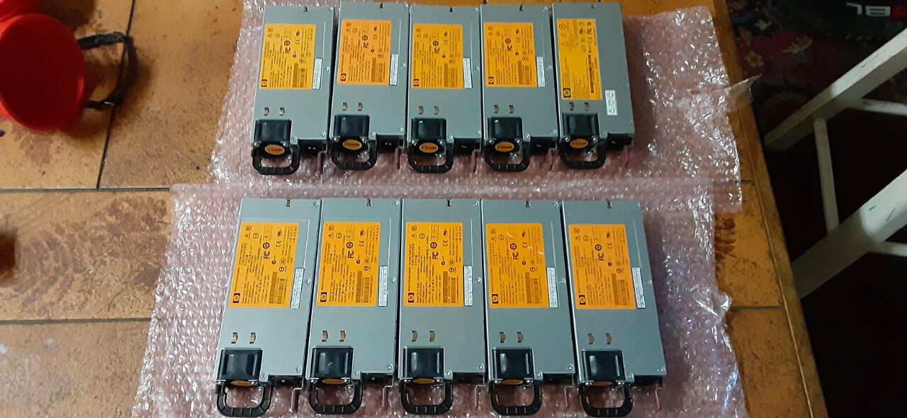

They are here! only dropped one of them!
Spare would have been a good idea…
if you buy these watch from here
yes with vice grips they come right off
oh testing before modification. Also not a bad idea… but they did that for me whateverr
