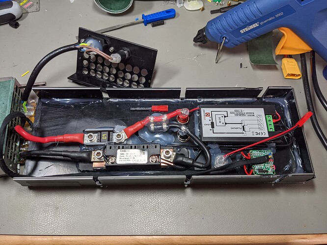

I finished mine today c:
Huawei R4850G with that can bus controller and shunt with powerdisplay.
Not the prettiest inside but it’s safe and sure packs a punch.
Took it to 30A already (didn’t want to stress that poor battery anymore) but it could do 60A.
