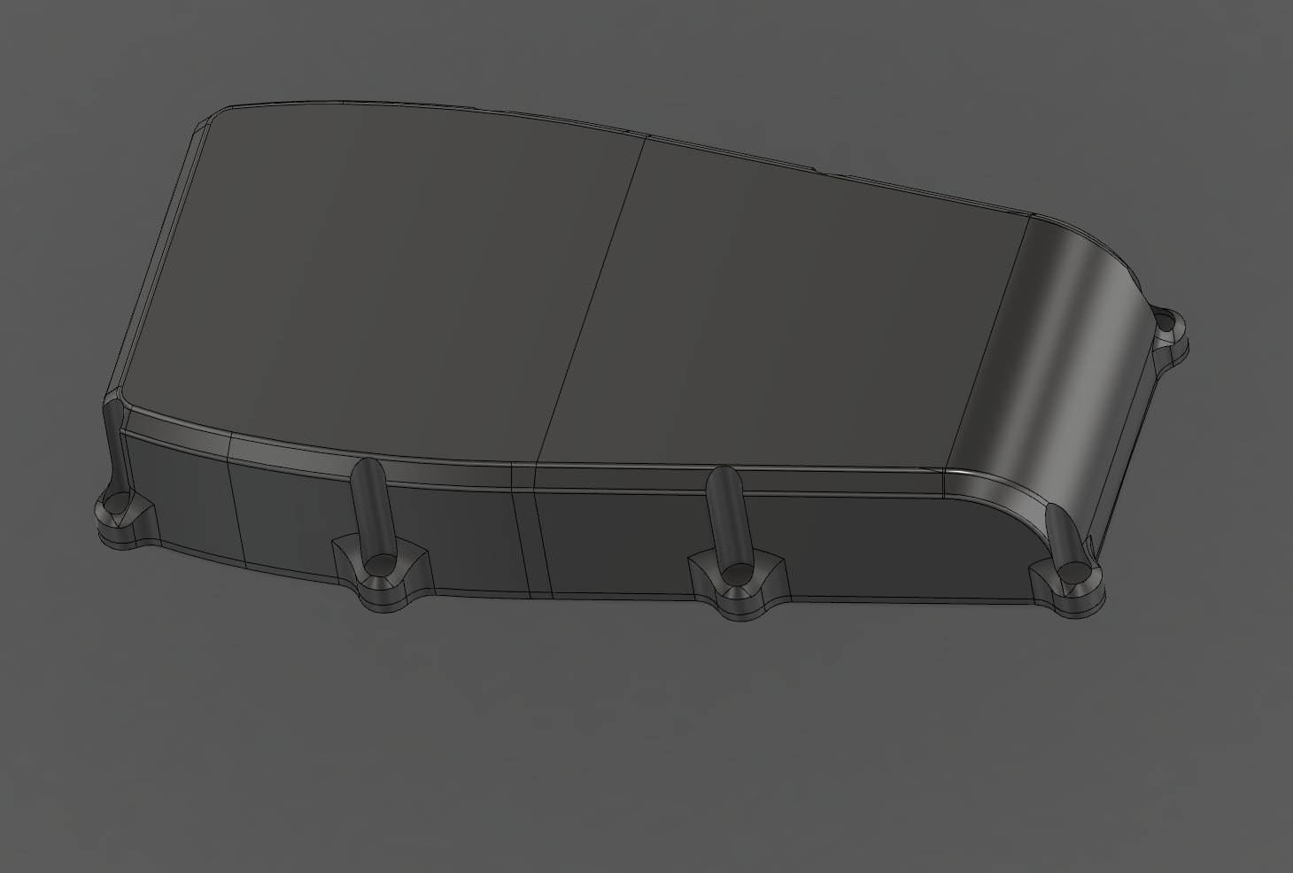

I was a bit impatient and started modelling the enclosure for the deck without yet actually having the deck. Stuff from China takes a while to ship and couldn’t just sit around waiting, so I grabbed the measurements from the eBay listing and started to block out a few designs.
This is the one I ended up with:
I’ll share the STL files to these after my build is complete and I’m satisfied with the result.
As the enclosure itself is larger than my Ender 3 print area, I had to split it up into two parts and fuse them together later with ABS Acetone goop. Knowing that I will acetone vapour smooth EVERYTHING eventually, I went nuts with the ABS goop, fixed any printing imperfections and sanded everything down once it had hardened and dried.
Once I did actually get my hands on the deck I was happy to find out that it actually fit.

Nice design with the enclosure. What screws are you using to attach it to the board?

I’l be using generic M4 screws and threaded inserts to avoid drilling all the way through the deck. 7ply is quite thin tho I might not be able to sink these all the way in without coming out the top side.
The lip of the enclosure will be lined with this foam gasket. Bought a few meters for one of my previous builds but never ended up using it. It adds a few mm between the deck and the enclosure, so I’m yet to measure the exact screw lengths that I will need, but I’m set on M4.
