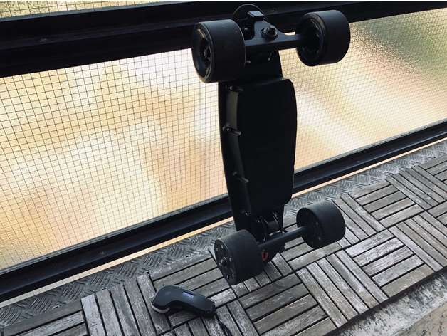

The Last Mile / 55cm (21.7") Pennyboard / 10S2P / Dual Hubs / Custom Firefly
Oof that would be a nightmare!
Darn thing is saying 66km/h (41mph) on the bench. No clue what it will do loaded but considering the size of the pennyboard I’ll have to do a bit of limiting and tune things down VESC side. My intention still is limiting it to 25km/h and keep it “street legal” here in Finland.

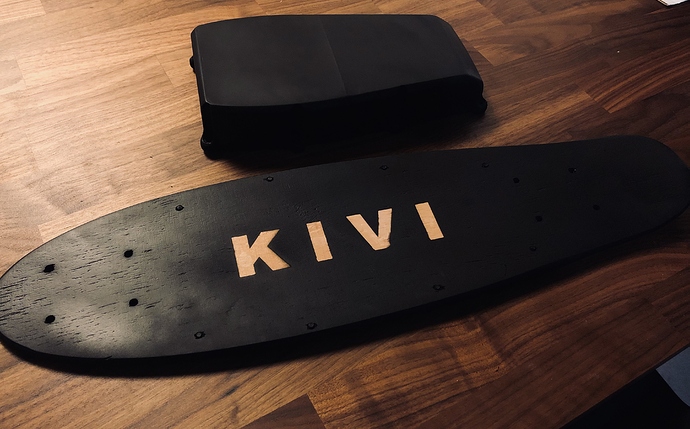

Deck and enclosure painted!
Just need to pick up my M4 screws and charge port fuse and I’m pretty much done.
3D printed a stencil and kept it in place with a dab of superglue for the duration of painting, but regardless of my efforts one of the letters (V) suffered a slight leakage. Hoping the clear griptape will somewhat hide my errors.

And it’s done!
Clear griptape is a bitch. :joy:
Will report back on how it rides.
What’s the finished weight?
5.2kg

Just did a 20km maiden voyage and drained the battery.
You can imagine my shock when I’ve been riding an Evo with penumatics and then hopped on to this tiny thing. Had to get used to the fact that there is nowhere to place your feet and no longer does it feel as smooth as those mushy pneumatics - it’s quite hard on your feet and curbs are my worst enemy. :smiley:
Balancing on this tiny thing is quite hard and 25km/h is the absolute max I’d be willing to do on this thing.
You’ll definitely be fine with a single motor, especially for a deck this size.
Love the manoeuvrability of the tiny 22" deck with a kicktail though - can really do tight turns and loosened up the trucks quite a bit. It’s perfect for the task I built it; to be used in populated areas at slow speeds and carried around.
