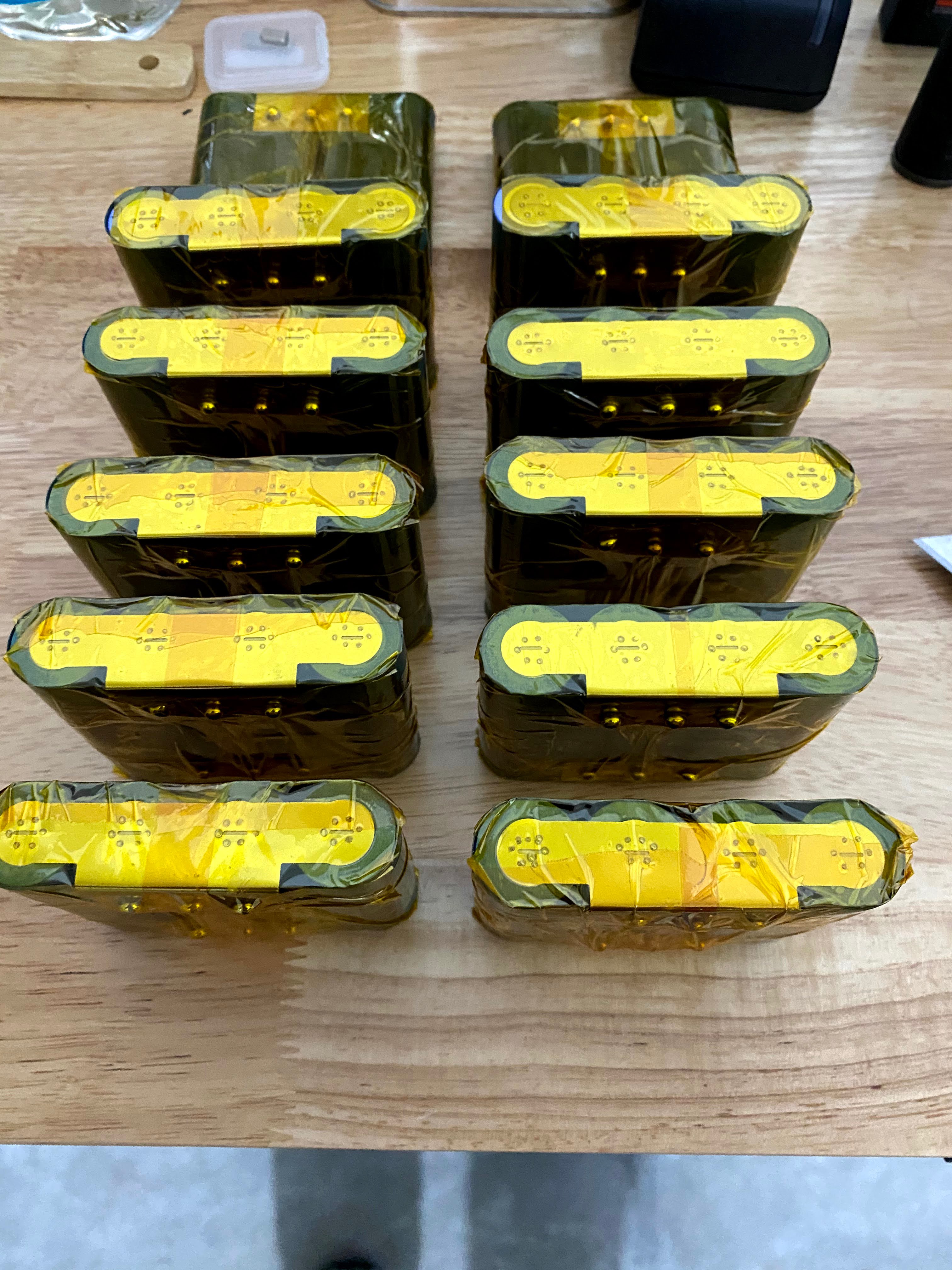

Starting my 3rd build now, and the idea behind this one is to make a street carver, that can be swapped easily between Thane, Rubber, and AT setups. Something with an ultra-board feel, that’s light and looks sleek.
Parts are starting to roll in and building is under way. The battery is the first objective, and will be made by myself. Once I finish the battery, I will sort the deck and enclosure out and start working on the drive train.

- 12s4p 40T Built by Me

Battery Building
This was my first battery I’ve ever built. @BenjaminF was a true gent and guided me the entire way. Such a huge help to our community that man.
1. P Groups, Gluing, Insulating Rings
2. Pre Soldering, Spot Welding, Fish and Kapton Wrapping
3. Series Connections, Reinforcing
4. Balance Wires, Charge, BMS Hookup
5. Charger Splitting and Heat Shrink
6. Profit!
Pack Reworking
Rebuilt the pack with a smaller AWG for the series connection to give more clearance.
