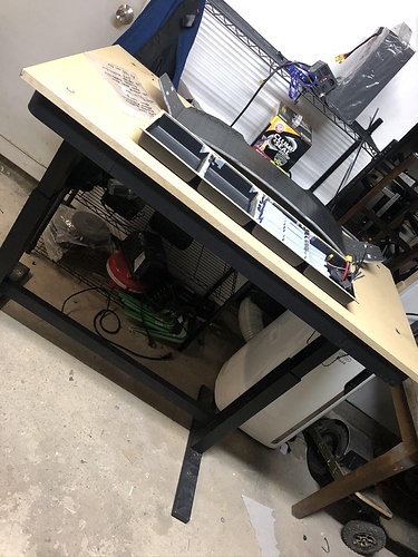

This battery will be a split mounted battery. 60% of it will fit in the enclosure and 40% will be on top of the deck.

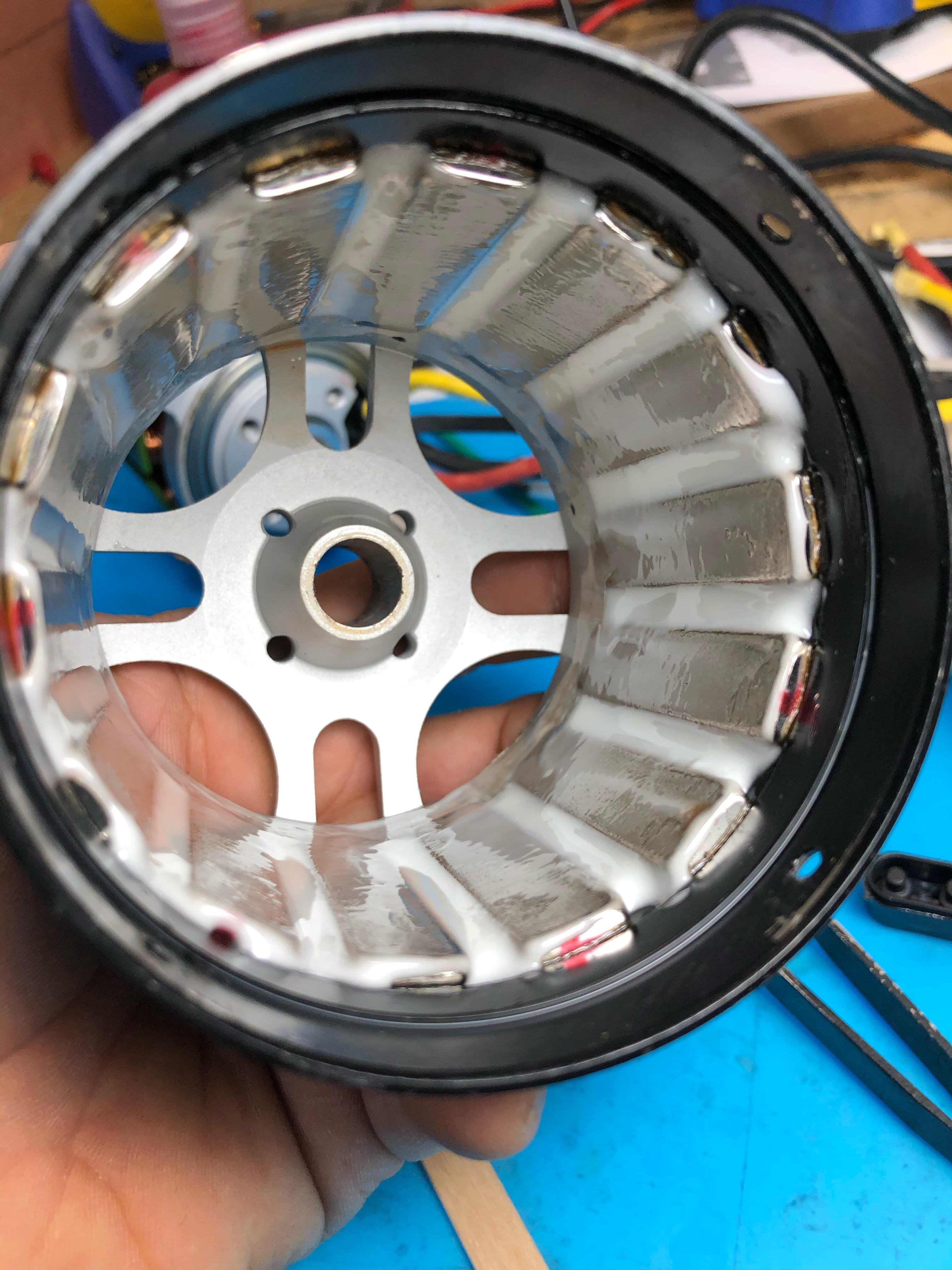

I choose the APS 80100 in 184kv for this build. They are known to have a few issues right off the bat and I have addressed those before ever even firing them up.
I have battle hardened the motors with Epoxy between the magnets and the sensor board PCB (I choose not to coat the entire stator with Epoxy for cooling concerns).
I have replaced some of the cheap hardware on the motors, added some more insulation to the wires, chopped the extra shaft length, and will be coating the inside of the motors with corrosion X.

Kaly XL50+ deck and Aluminum enclosure. Very stiff, very sexy. This enclosure will housemy 4 Vesc 6 and 90 of the 144 cells, BMS Awesome work @Kaly
