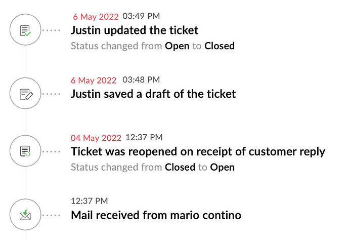

I replied to the ticket on May 4th, and didn’t hear back.

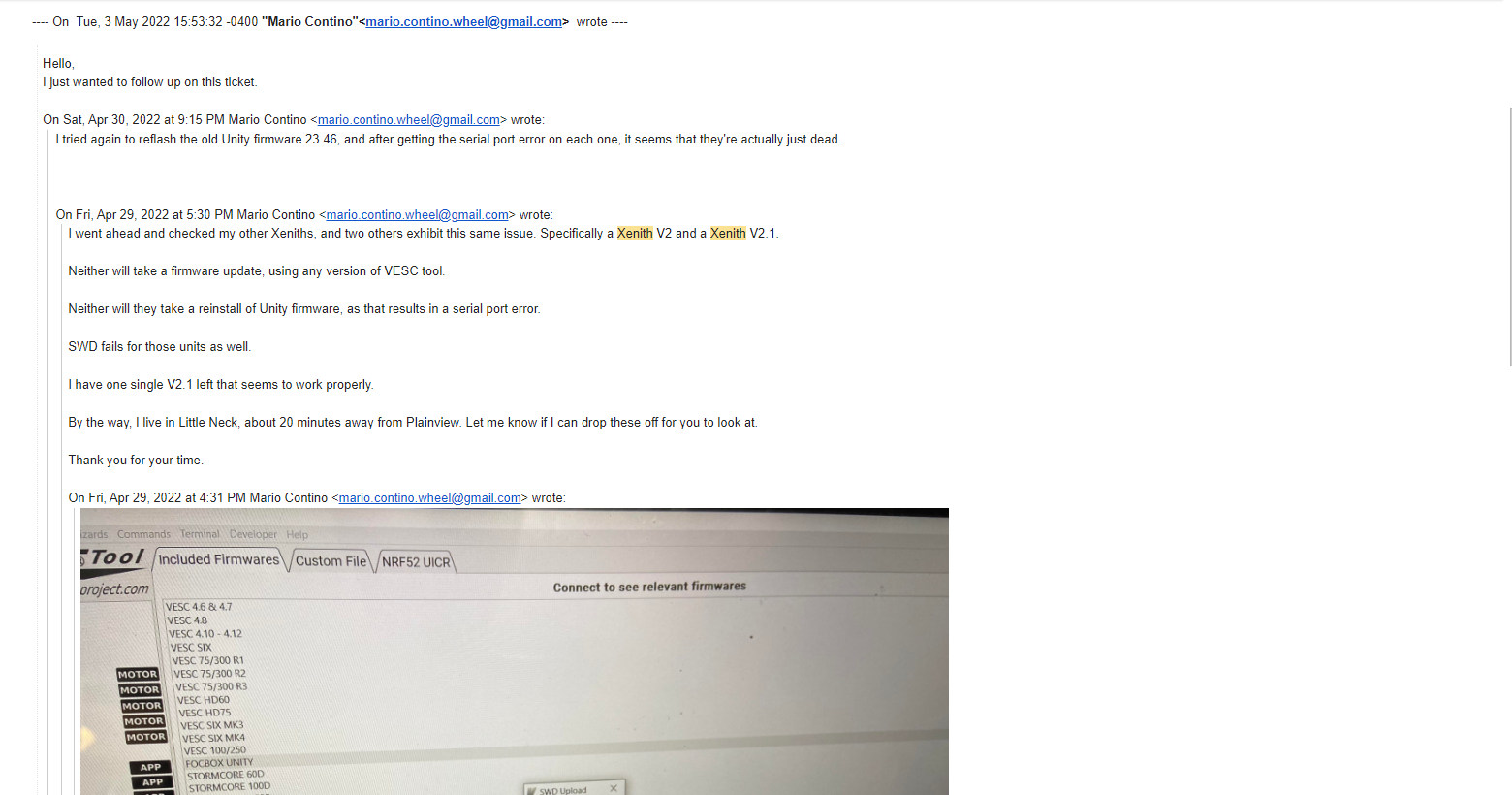

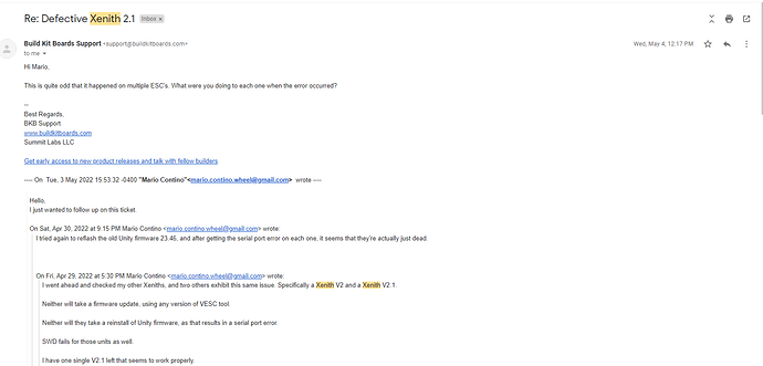

The issue started when the Xenith placed into a customer’s Prototipo wouldn’t complete motor detection.
Since most of the issues I encounter like that are fixed by reinstalling firmware, that was the first thing I did. Which then led to the actual issue, sparking the first email I sent to support:
Followed by:

When I explain what I have found, I am in no way justifying the actions. I just want you to understand what is going on. A reply was written to you on May 6th, never sent, and then the ticket was closed. The general work flow is to close a ticket after a reply has been sent, so I am guessing the reply was meant to be sent. I will talk with Justin on Tuesday (its midnight and tomorrow is the 4th).
After reading over your ticket, it seems that there is an issue with three Xeniths. I will be emailing you a return shipping label for 3 of them (after you confirm). When they arrive I can then either process an exchange or a full refund for the product + shipping. Given what you have said about BKB I am assuming you will choose the refund route, but I just wanted to provide options.
