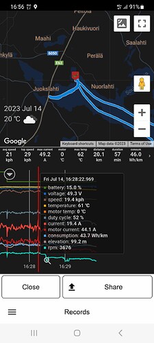

Is there a way to change between light and dark mode for the metr app? Android system is in light mode, but the map is currently dark. Hard to see in sunlight.
That’s weird, should be light mode when system is light. If you open it in external browser (Share), is it also dark? Or light?
In the browser it’s light.
