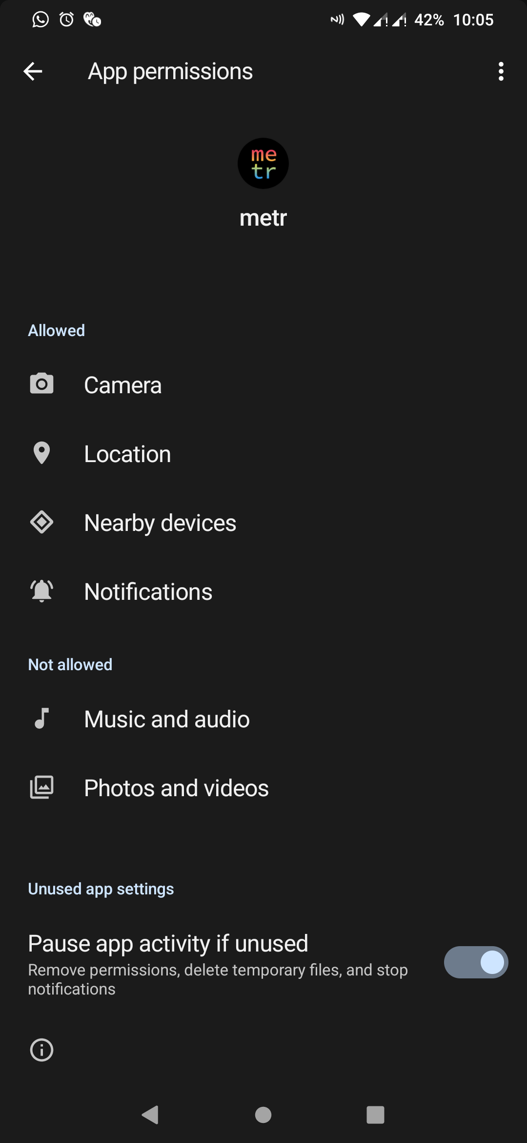

Any other pointers if phone GPS data doesn’t work? Location is allowed and VESC data is recorded ok.
I allowed every permission that was asked for, as per usual.
Normal app setup, nothing else.

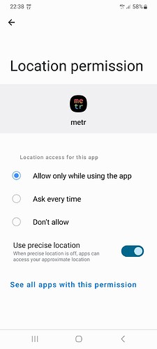

Unfortunately still no GPS data with the Metr Pro Unity. Battery optimization disabled + batt use unrestricted at Android settings, notifications enabled, etc. It used to work fine. My previous ride was during last fall.
Do you have foreground notification when the app is minimized? (screenshots here https://forum.esk8.news/t/the-definitive-guide-to-metr-app-metr-pro/3109/1#heading–troubleshooting)
Glad to hear this :slight_smile: since my vx2 died I’m stick without real time telemetry
Yeah, I do. Foreground notification stays on after initial Metr startup, and I always have the app open on screen before a ride to make sure it connects. Is this location permission ok?
Yes it looks good. Ok, last thing to try, send me log file Settings → Show Logs from the day when you made recording, support@metr.at

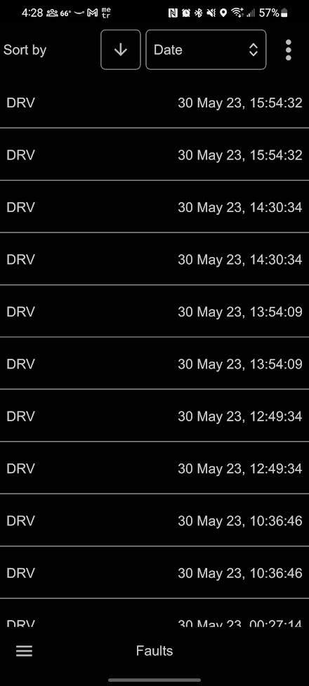

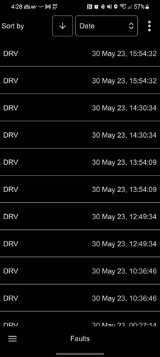

Issue: Metr drops two “DRV” errors (one for each motor) every time Stormcore auto shuts off.
Specs:
  • Dual_Stormcore_60D_FW5.1
  • Metr Pro uart FW5.36
  • Flexibms on CAN
Please help! I’d prefer not to disregard DRV errors haha
Nothing to worry about. Happens on the Unity as well. (Both single MCU vescs)
I figured it was not harmful but it’s annoying seeing it on all my logs and errors haha
There are no such options currently.
Do you use auto shutdown feature? Turning it off completely is an option.

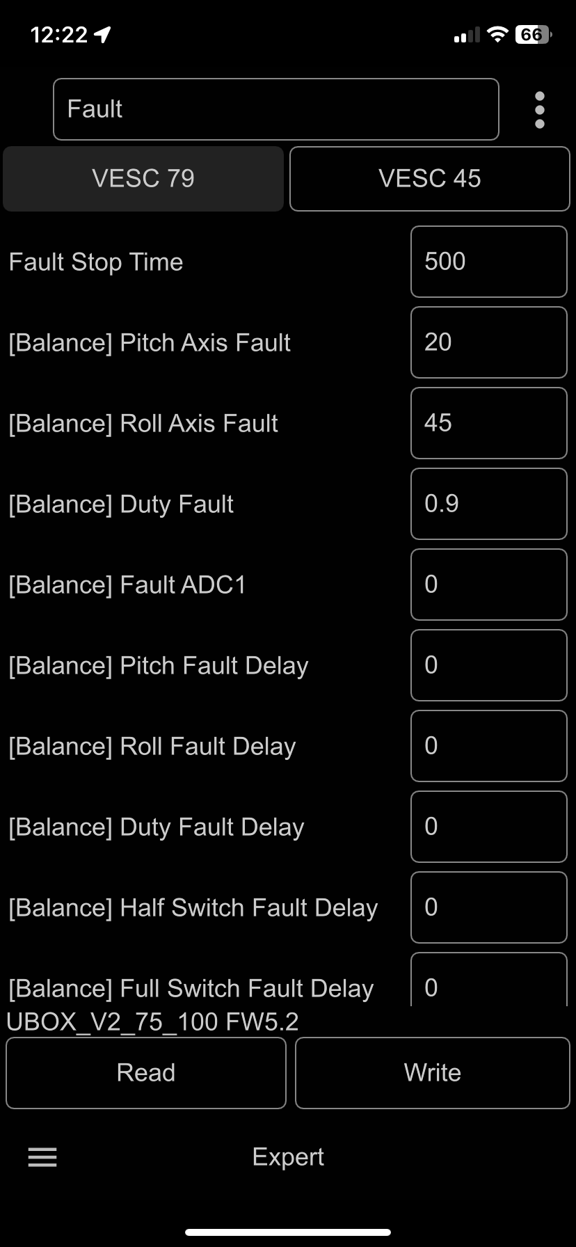

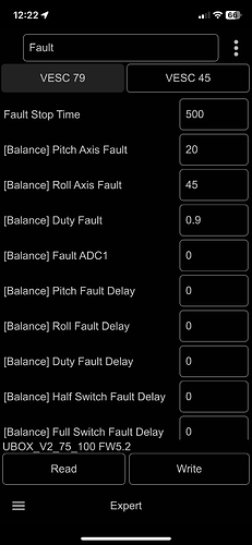

Second i was reading around and saw a post suggesting to set the fault time from the default .5 seconds to .08 seconds, in the metr app it displays as 500 with no units
Can I assume this is 500 micro seconds and set it to 80? Am I looking at the correct setting or is it labeled something else? Is this really necessary or na?
That is in milliseconds. Stock is 500ms, you’d want to change it to around 50ms - 80ms ish.
