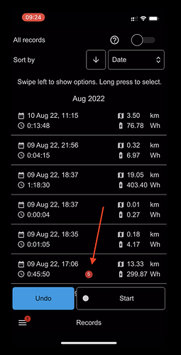

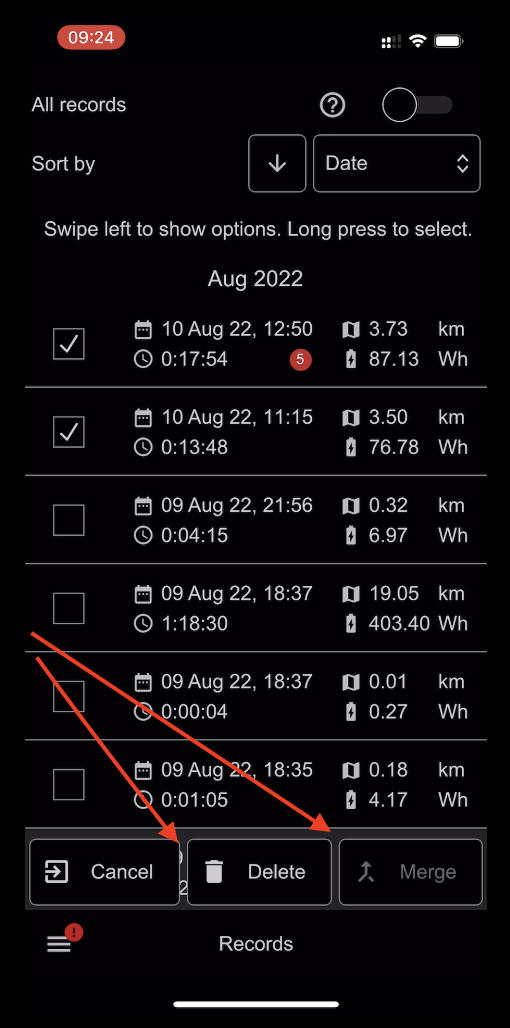

Here is a video of it. As you can notice first of all when 2 or more records are selected, the Merge button is still grayed out. Then if I press on it once it becomes white. If I now press it again. One of the records just disappear, or is merged to some other record that I don’t see.

So it was a combination of 2 bugs that you experienced:
First bug, when clicked in the checkbox area (1) or record details area (2), the visual effect is the same (record gets selected, checkbox appears). But unfortunately only when clicked in record details area (2) the record is actually selected. This is why “Merge” button stays greyed out, because you clicked on little square. You did nothing wrong, it is just a bug in the app.
Second bug, when you clicked on the “Merge” button while it was still disabled (greyed out), the click event propagated beyond the button and actually selected another record behind it. You can see it in a brief split second.
Which resulted in merging 2 records (one with 5 faults and another which is located behind Merge button).
This explains why resulting record moves down (records are sorted by date), it still has 5 faults.
I hope it explains it. New app version with fixes is coming soon. In the mean time please select records by clicking in the middle of each record (2) and not on a little square (1).

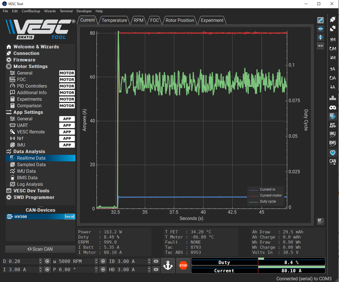

Foc openloop seems to be broken in the official vesc tool itself. I’ve tried in 5.2 and it didn’t work, Roman i believe tested in on different firmware as well with the same results. Since metr uses the same command as the vesc tool, it has the same result. Broken in vesc = broken in metr.
So you are telling me I need to actually ride these boards to get the battery drained? Pure silliness
Thank you for explaining it. I’m sure you did in the other thread as well, I can be a bit slow sometimes :upside_down_face:
There is a chance. You can try using the foc_openloop command yourself on the desktop. Depending on the firmware you’re using it could work.
Huh, I use foc_openloop all the time through the desktop tool on 3.00/5.2 and 3.01/5.3. Have to keep the heartbeat on or it won’t stay on
It does not work on the mobile app, and I use a PPM remote so I can’t use it on the metr app’s discharge feature either. Get an error saying PPM is enabled and I haven’t disabled it because “I don’t want to go into the internals of the electronic components and switch things up”
It also depends on hardware. I think foc_openloop stopped working for some VESCs on 5.x but still works for others.
