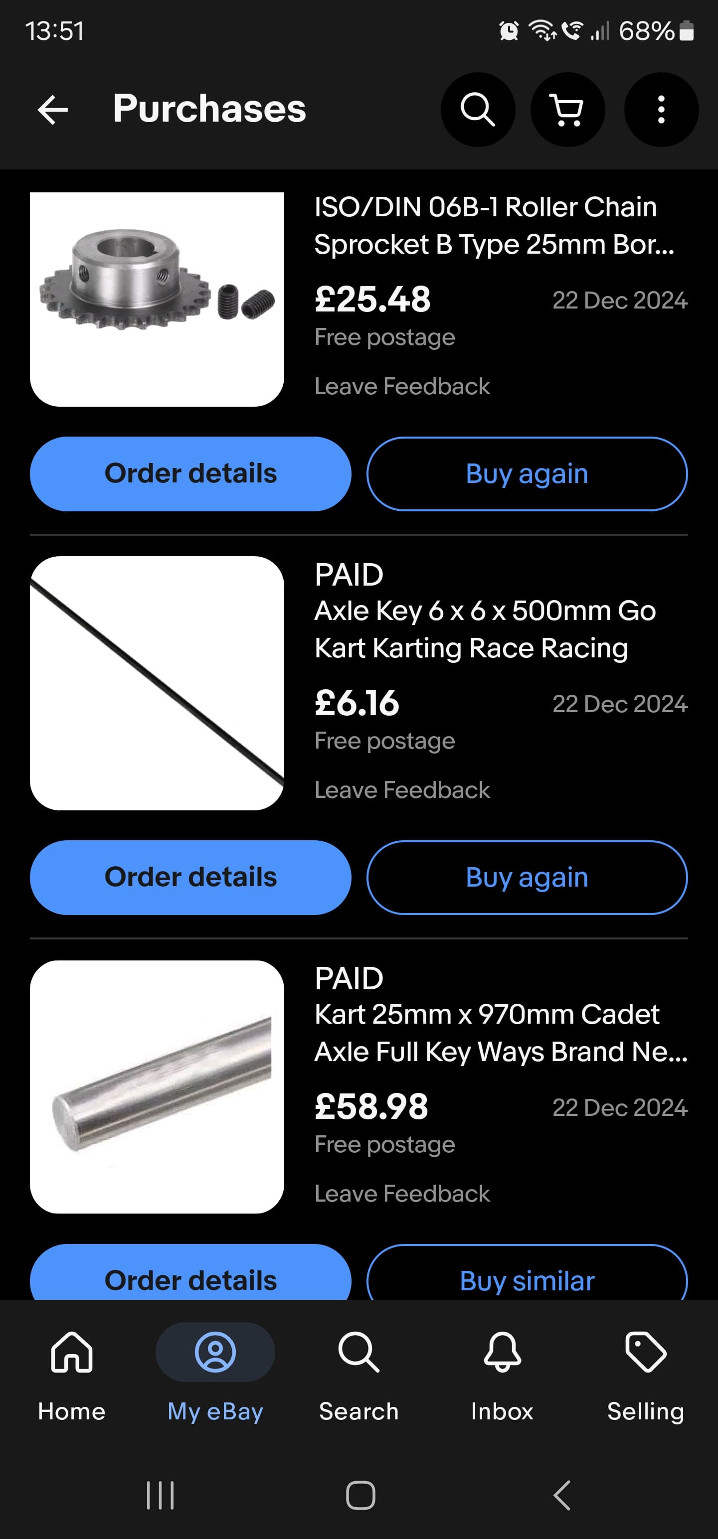

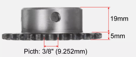

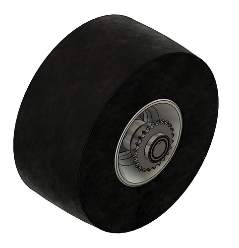

Addressing the elephant in the room here - the sprockets. I sized them based on “what’s the biggest one I can find on Ebay that fits a 25mm keyed axle and doesn’t cost an arm and a leg” then sanity checked it with the 3Dservisas Esk8 calculator site. I have a pair of Apex 8T ISO 06B moyor pinions, so with two motors and a 1:3 ratio I should have plenty of torque. Estimated top speed in the region of 30mph which is probably overkill. If I end up needing more torque I’m sure I’ll work something out later down the line.

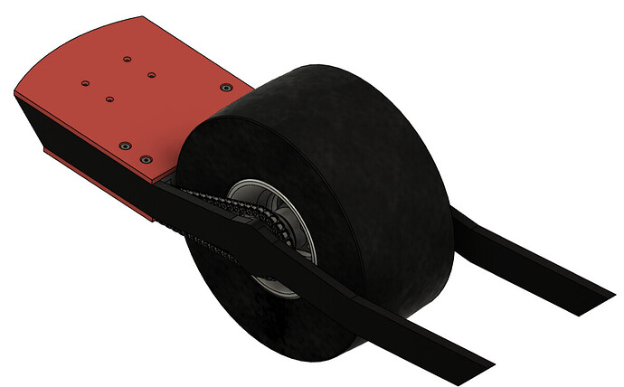

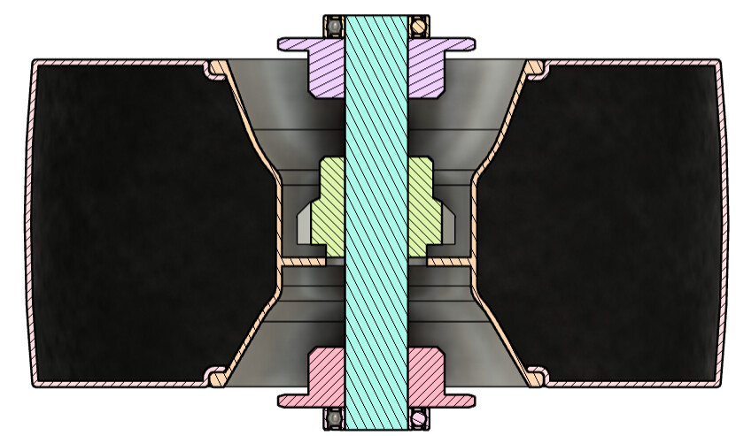

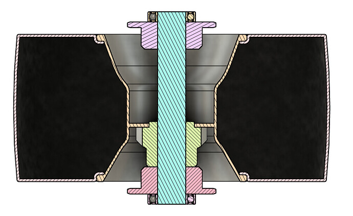

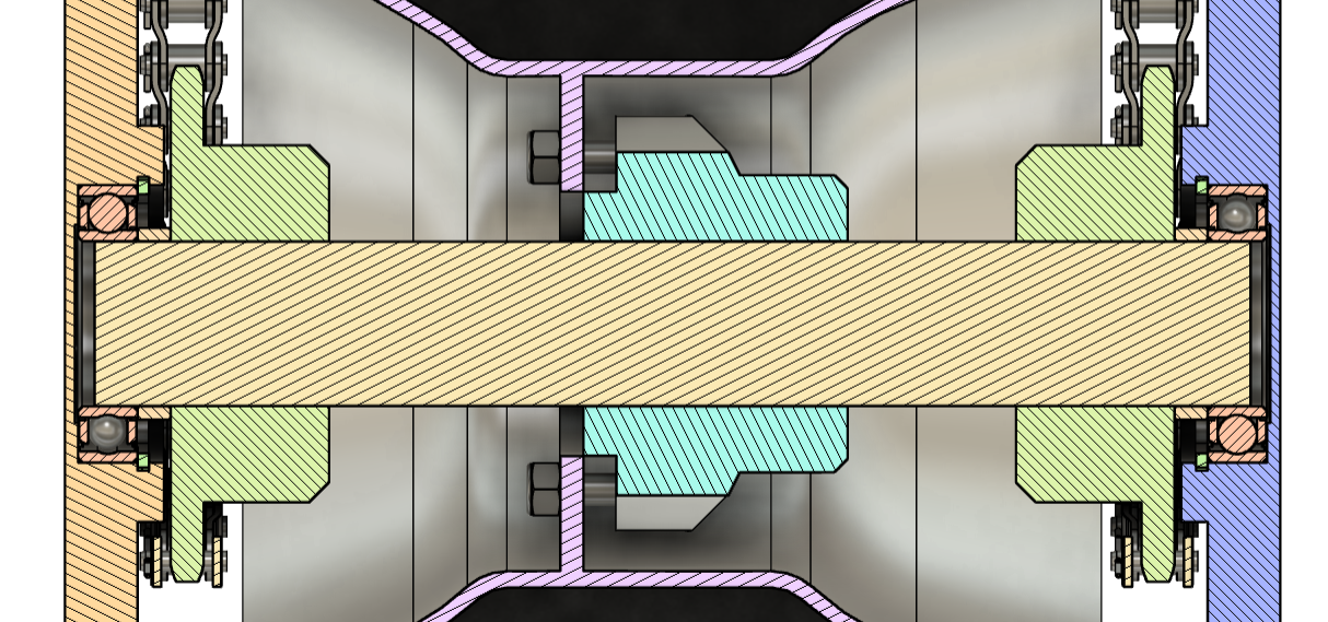

Quick CAD mock-up of the current planned driveshaft assembly:
My biggest concern at the moment is due to the offset inherent in go kart rims, there’s going to be somewhat of a large gap between the sidewall of the tyre and the side rails.
There are a few ways I could get around this:
  1. Only use one sprocket and inset it just enough that the chain doesn’t rub against the tyre. This really is not ideal as I want to make this dual drive and may introduce balancing issues.
  2. Make modifications to the wheel rim such that the hub can be mounted on the opposite side. I don’t like the idea of damaging the rim because I risk compromising it’s structural integrity. FYI It’s not pictured in my rough and ready CAD model but there are ribs on the other side that prevent hub mounting:
  1. Add standoffs between the wheel rim and hub so that the hub can be mounted on the opposite side. This is probably the best option. A custom CNC machined spacer would be nice, but in a pinch three ESK8 axle spacers should do the trick.
  2. Modify one of the sprockets to reduce the collar length. Wouldn’t gain much because the grub screw is close to the edge as it is:
So I think option 3 will be the route I go down.
Edit: This is what the spacing will look like with option 3:
Very little difference to be honest. I’m not sure if it’s worth the loss of stiffness of the hub/rim connection. And I might end up needing more clearance anyway for the chain so that idea is probably going out the window.
This is very clearly a fundamental flaw with using two sprockets but I’m a stubborn fucker and I will continue anyway. I’ll probably 3D print some chain guards anyway once the design is more mature to hide the gap and protect myself from the chain.

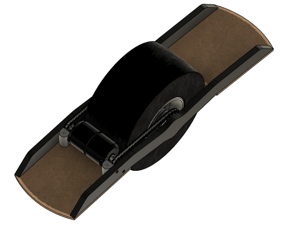

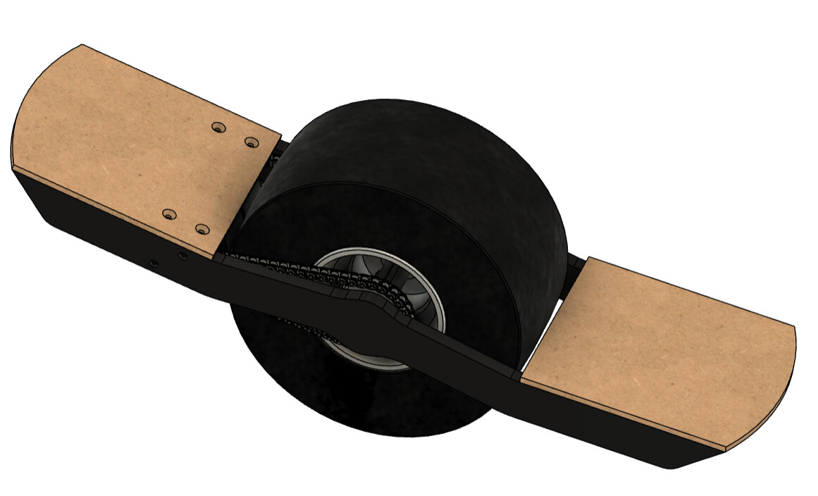

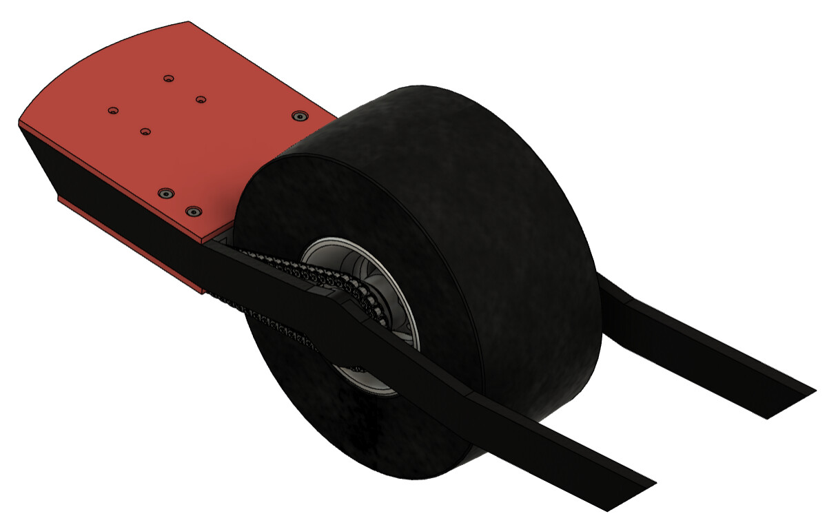

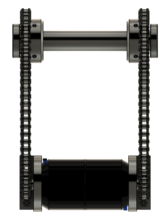

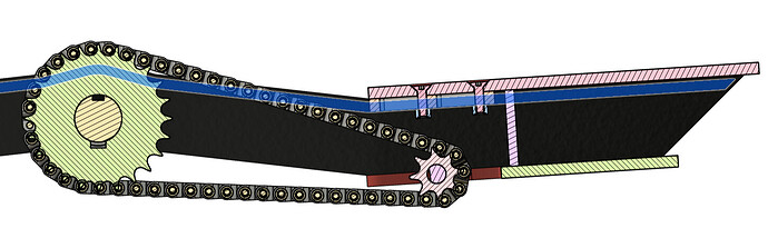

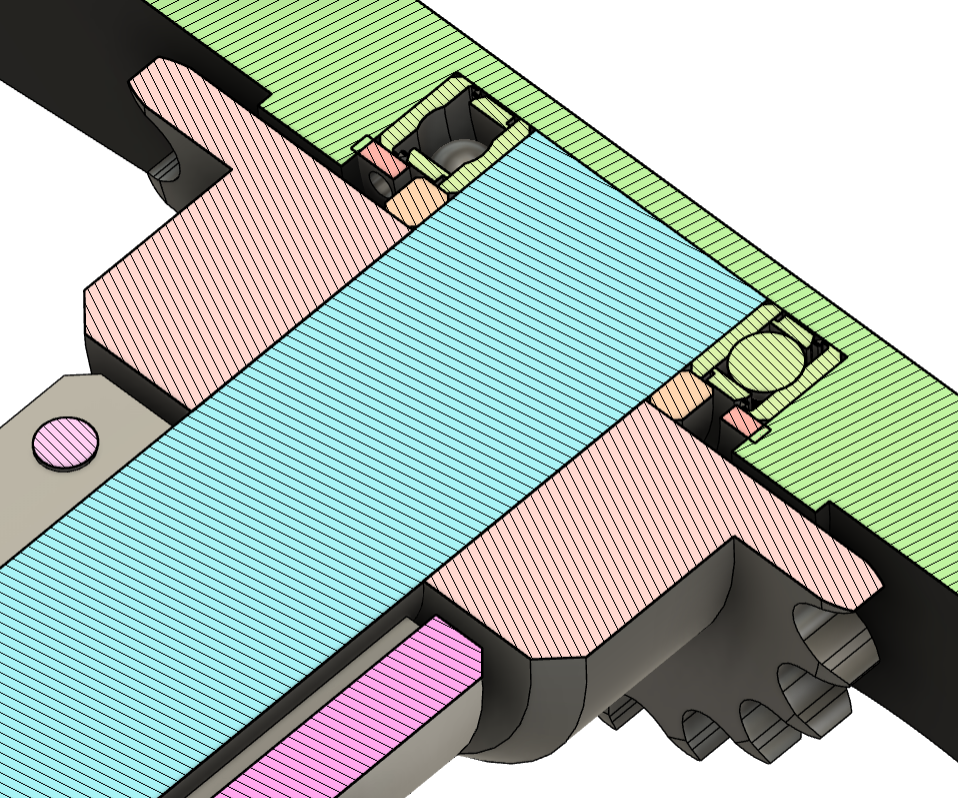

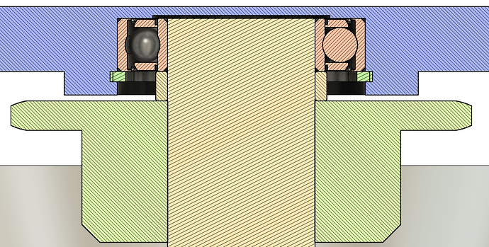

Concept development progress update:
Important features:

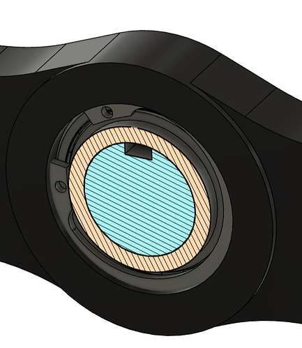

Circlip for bearing retention
Spacer (orange hatched area) to maintain sprocket alignment in the event that sprocket grub screws fail.

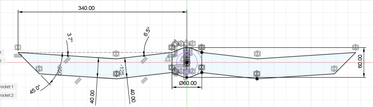

WTF-style rails based on dimensions from TFL (The Float Life) patent ( US11325021B1)

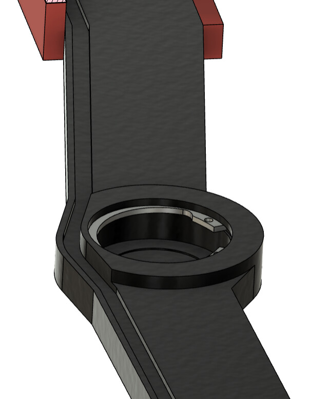

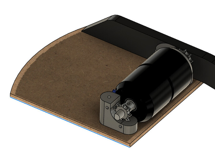

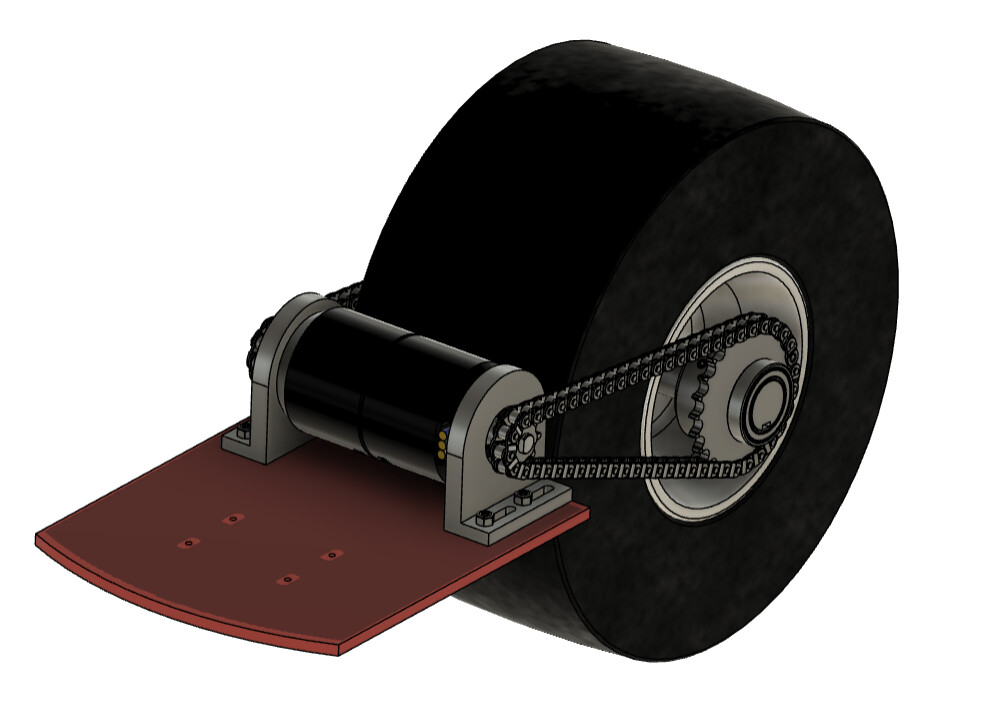

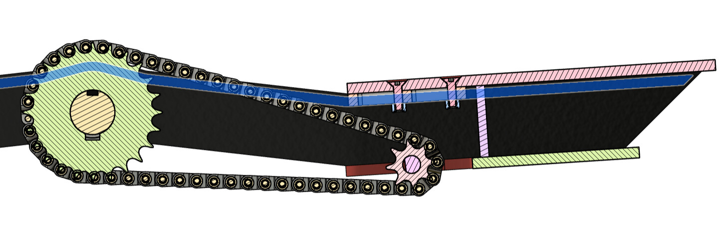

Motor mounts will look something like this where they mount to the rail and footpad. Exact dimensions TBC of course, lots of interference in current version (especially with the chain). Slightly concerned that only two of the motor mounting holes are being utilised so may instead design a 90 deg. angle bracket that mounts between all 4 motor holes and the footpad.
Behind the motors will sit a fully enclosed waterproof 3D printed enclosure mounted to the rails and/or footpad containing the ESC and other electronics. Underneath the other footpad is where the battery will go. Yet to figure out how to route the wiring either side of the wheel. A channel inside the rail is out of the question unless the rail is made extremely thick, so it might have to be routed round the outside which is a little ugly…

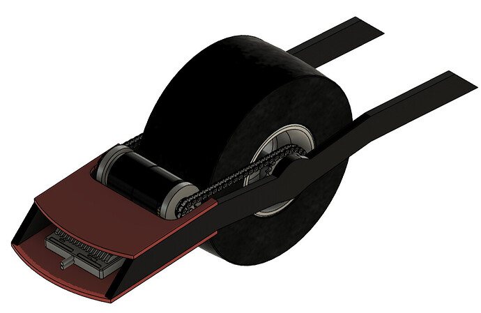

Progress update:
I was worried I wouldn’t have the room to create a channel to route cables from one footpad to the other, but it should be possible to do something like this:
I’ll work out the exact dims once I’ve specc’d the battery and know what gauge wiring will be running through the channel.
If the channel isn’t wide enough I could always offset it slightly which would match the footpad thickness.

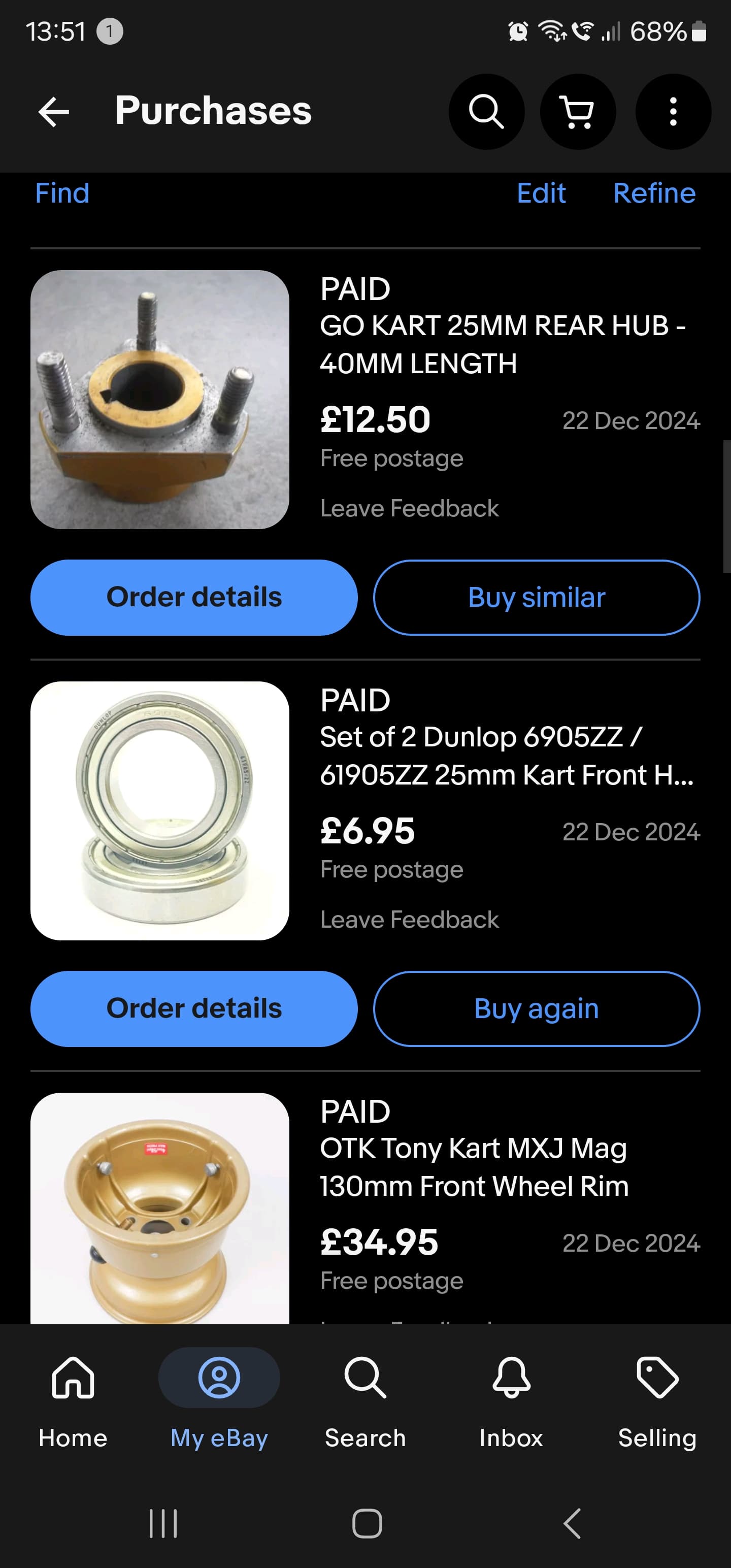

A few of the bits I’ve ordered arrived after boxing day. Seems that Santa was slighlty late but I’ll forgive him.

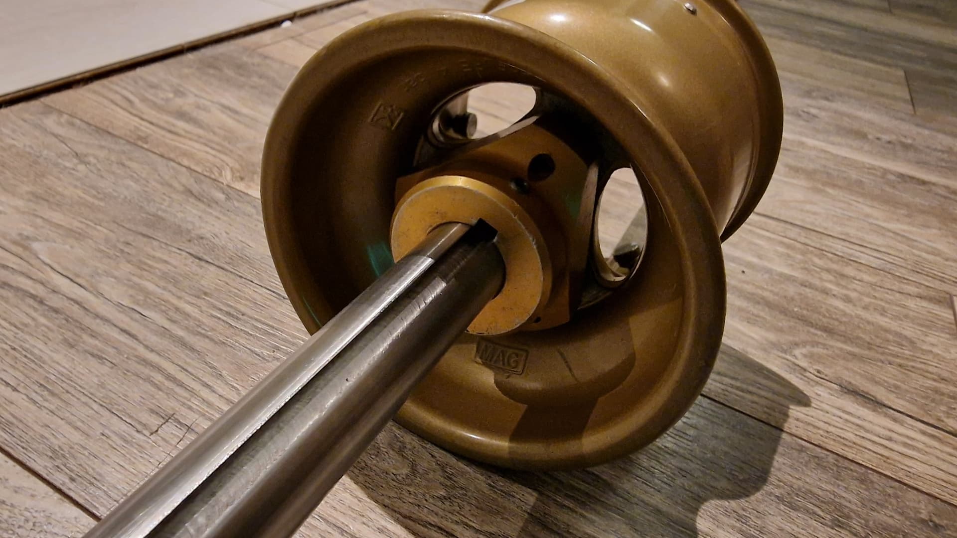

The axle, the hub, the bearings and the wheel rim. Which means I’m missing the sprockets but they’re on their way from China so I expect to be waiting at least another week for them.
In the meantime I’ve been playing around with the components.

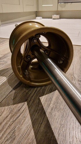

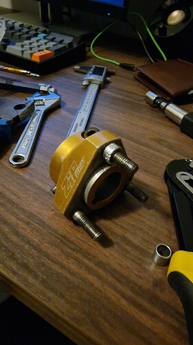

There are a couple of issues with the hub/rim assembly. Firstly, the slight extrusion around the hub centre has a slightly larger outer diameter than the rim centre hole. You can’t see it very clearly in the images but take my word for it. The hub is offset by somewhere between 3-5mm along the length of the axle from the rim when assembled. I’ll have to revisit the CAD to see if this is going to be an issue but I don’t think it will be. Worst case scenario is that I’ll mount the hub to the other side of the rim with some standoffs which was one of the ideas I previously mentioned but scrapped due to the stiffness tradeoff. Alternatively I could take a hole saw to the wheel rim…but that is a last resort.
Secondly, in the process of playing around with how to mount the hub, I assembled some axle spacers I had lying around (I think they’re @Boardnamics from the caliber hangers possibly?) onto the M8 stud bolts in the hub. Due to a slight lip on one of the aformentioned bolts, one of the spacers had to be torqued down with a nut to push it in place. Total neanderthal move that…because now I can’t get the damn thing off. I’ll be replacing the stud bolts anyway because the threads are a bit fucked but I would like to save the spacer if possible. I’m thinking of taking a blowtorch to it but mechanical methods are preffered. Maybe a bearing puller will do the trick…

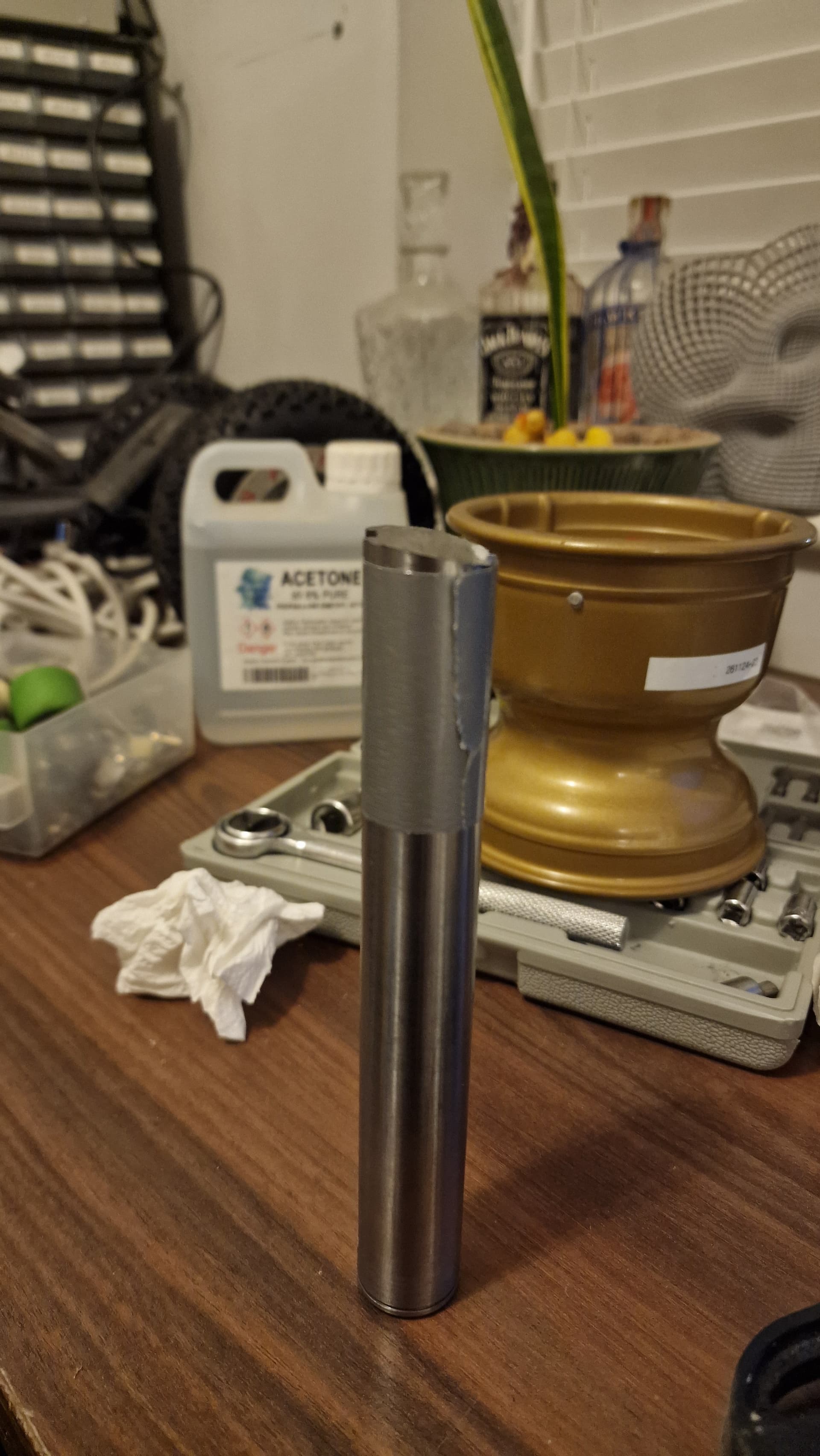

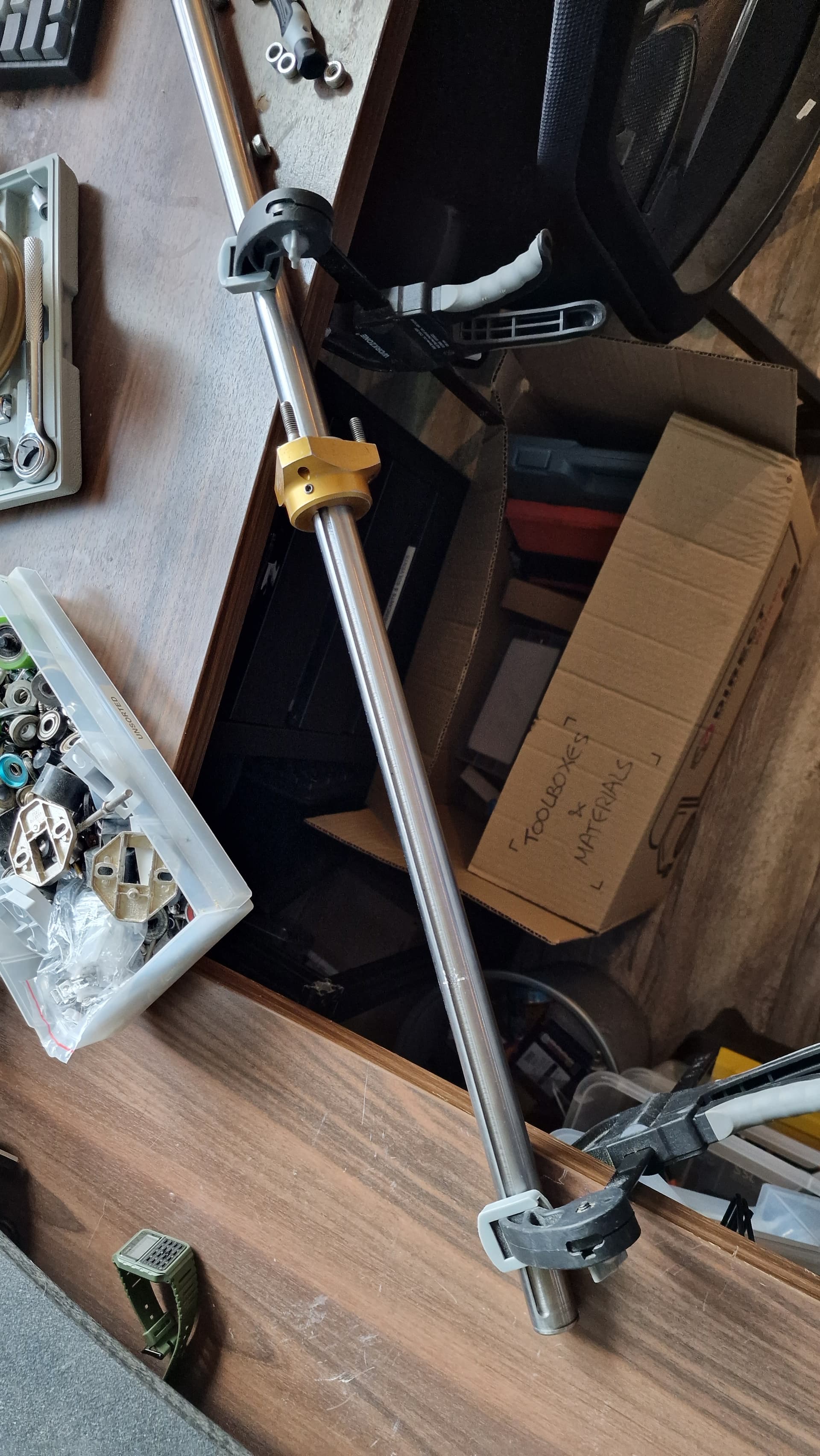

Today I tried my hand at cutting the axle to length. I was very nervous about this as I had no idea how hard the axle was going to be and without any appropriate power tools it was going to be tough. I hacked away at it for half an hour with a shitty little hacksaw and managed to cut off what I thought was 180mm of solid steel bar.
Turns out it’s 180mm on one end of the cut and 175mm on the other end of the cut…
Looks like I have lots of filing to do!
On the plus side, this should be fine. Although it won’t engage the whole way through the bearings on each rail, it should be fine for some prototyping and I have more than enough axle left over to try again.

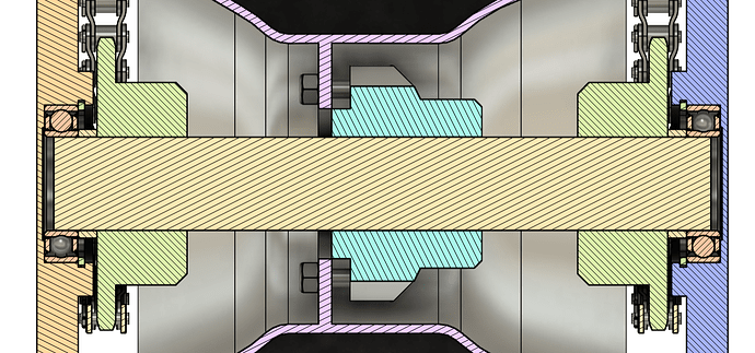

Here’s my options…

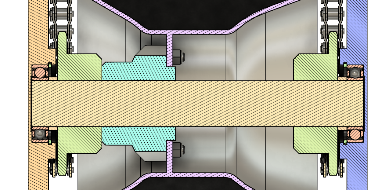

Current design:

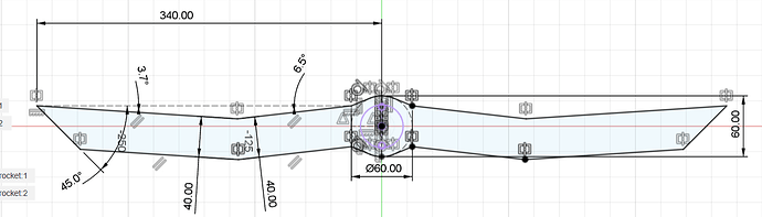

It’s pretty clear that I can’t allow the extra hub offset on the left hand side without pushing the sprocket further out. In turn, that will make the entire build wider by about 10mm, give or take some. It doesn’t sound like much and that may be useful to give the chain some clearance at the expense of looking a bit uglier. It will also give me more room to adjust the motor positioning as they’re currently modelled as butted up to each other which would cause a lot of friction and heat generation.

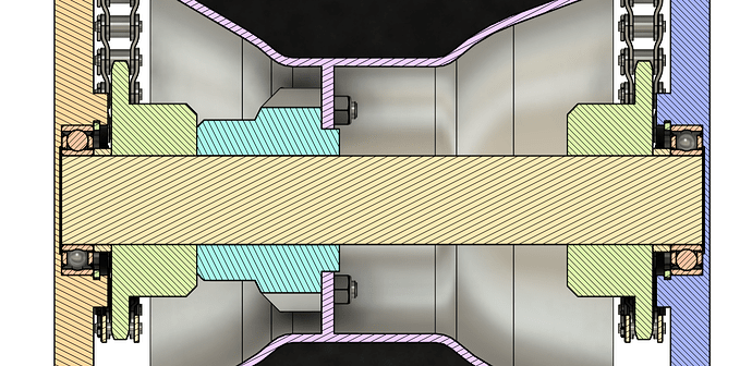

Alternative design:
Here I’ve also modelled in my bodged axle. I’ll definitely have to fix this as it will put a lot more stress on the bearings. But I’ll work with what I have for now for prototyping purposes. Putting the hub the other way round would give me plenty of room for the sprockets, make the assembly more symmetrical which may help with balancing, but from my trial fit it would severely impact the ability to access the valve on the inside of the rim that’s used to pump up the tyre.
So I think the plan moving forwards is to make the axle longer and therefore make the entire board slightly wider. Currently the CAD model measures in at 184mm wide. According to the image below, a OW GT measures in at approximately 240mm wide and a Pint X at approx. 200mm wide, so it will probably do the build a favour from an aesthetics and useability standpoint. I might beef up the rails a bit around the bearing housing too. I have avoided it because I know the thicker they are, the more expensive the plate stock to machine and therefore the more expensive the part, but it seems inevitable if this thing is going to hold up.

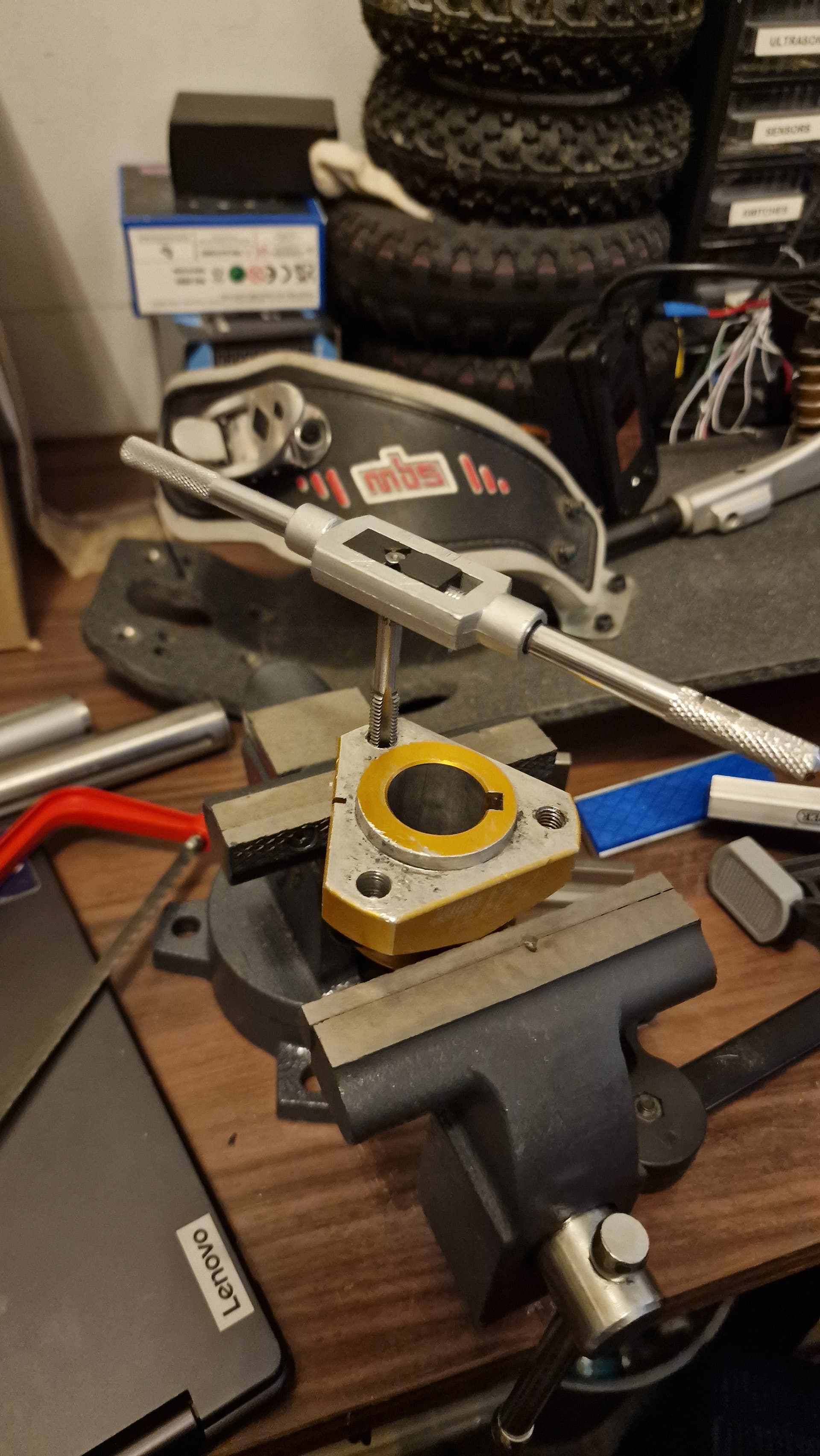

Been using this project as an excuse to treat myself to a few nice tools. Nothing fancy, but picked up the following:
  • A benchtop vice (long overdue)
  • magentic soft jaws for the vice
  • a scribe
  • a machinist square
  • a 13mm extra deep socket for the hub nuts
  • a new set of files
  • a stud bolt extractor
  • a set of imperial to metric square drive socket adapters mainly for the stud bolt extractor
A few of those bits arrived today, including the stud bolt extractor. Despite not having a socket adapter for it I managed to use my willpower and sweaty hands to persuade the existing stud bolts out of the hub. I then cleaned out the threads with a tap. Good as new!
A 500mm bar of 6mm x 6mm sqaure keyway stock was meant to arrive today.
Instead what did I receive? A totally empty package…
There’s yer problem. If you ordered the KEY stock, you would’ve gotten a square rod of steel. But since you ordered KEYWAY stock, you received an empty 6mm void in space that has to be installed on the rotary shaft to hold keys.
