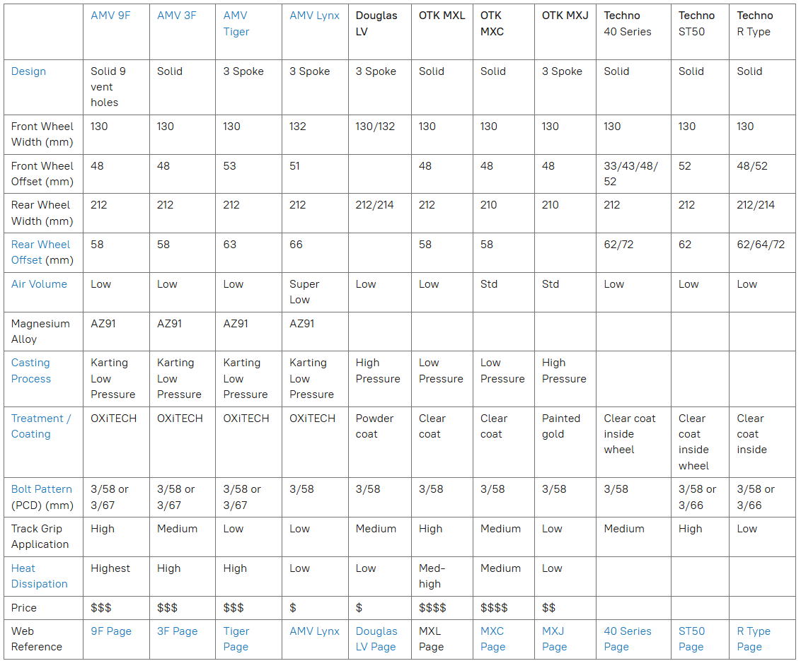

It comes as a lovely coincidence that go-kart wheels have a very similar shape and size. This table from AMV Kart components sums up the common go-kart rim dimensions nicely:
From this, it is clear that the front wheels are typically in the region of 130mm wide (5.12 in for the hamburger guzzlers) which is about an inch shy of the OneWheel width. The diameter, though not shown here, is in the region of 4-6 inches and the tyre diameter boils down to whatever rubbers you choose to slap on the rim.

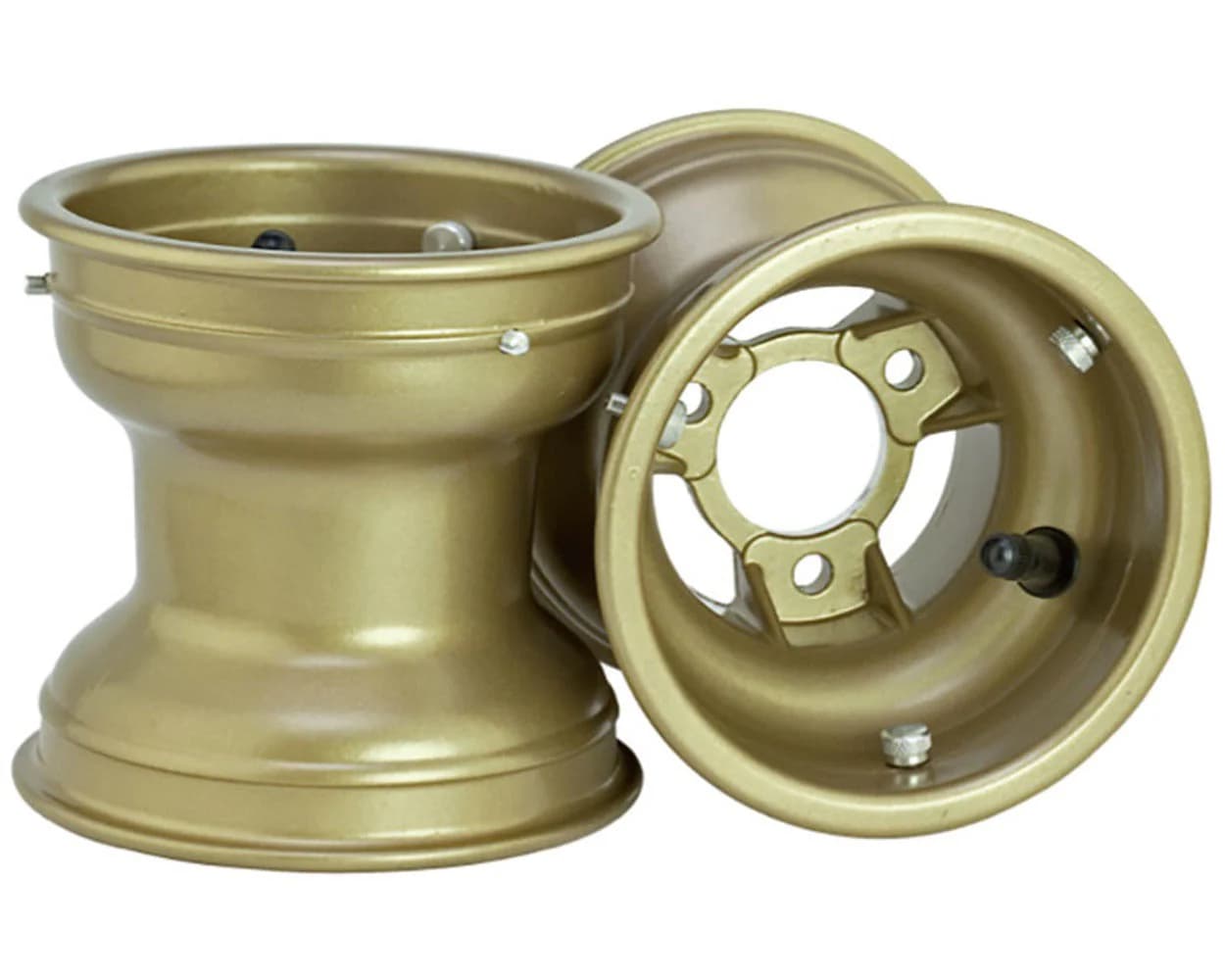

I’ve been chatting to a guy on the cesspit known as FB marketplace about a set of used OTK MXP’s he’s willing to sell for £10 a pop which is an absolute STEAL. These bad boys are made from a magnesium alloy, meaning they are lightweight and dissipate heat much more effectively than aluminium.

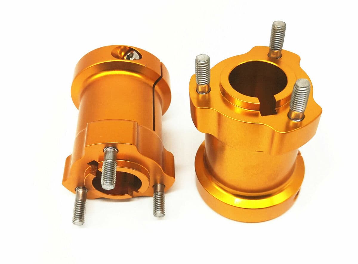

The keen-eyed among you may already be asking yourself how the hell these are mounted? Well, I present to you what is known as a hub. Rear wheel hubs look a bit like this, with some variation in the mounting hole pattern, bearing ID, and overall length:
They are designed to be restrained radially via a keyway, and the compliant clamping collar is torqued down to provide axial restraint.

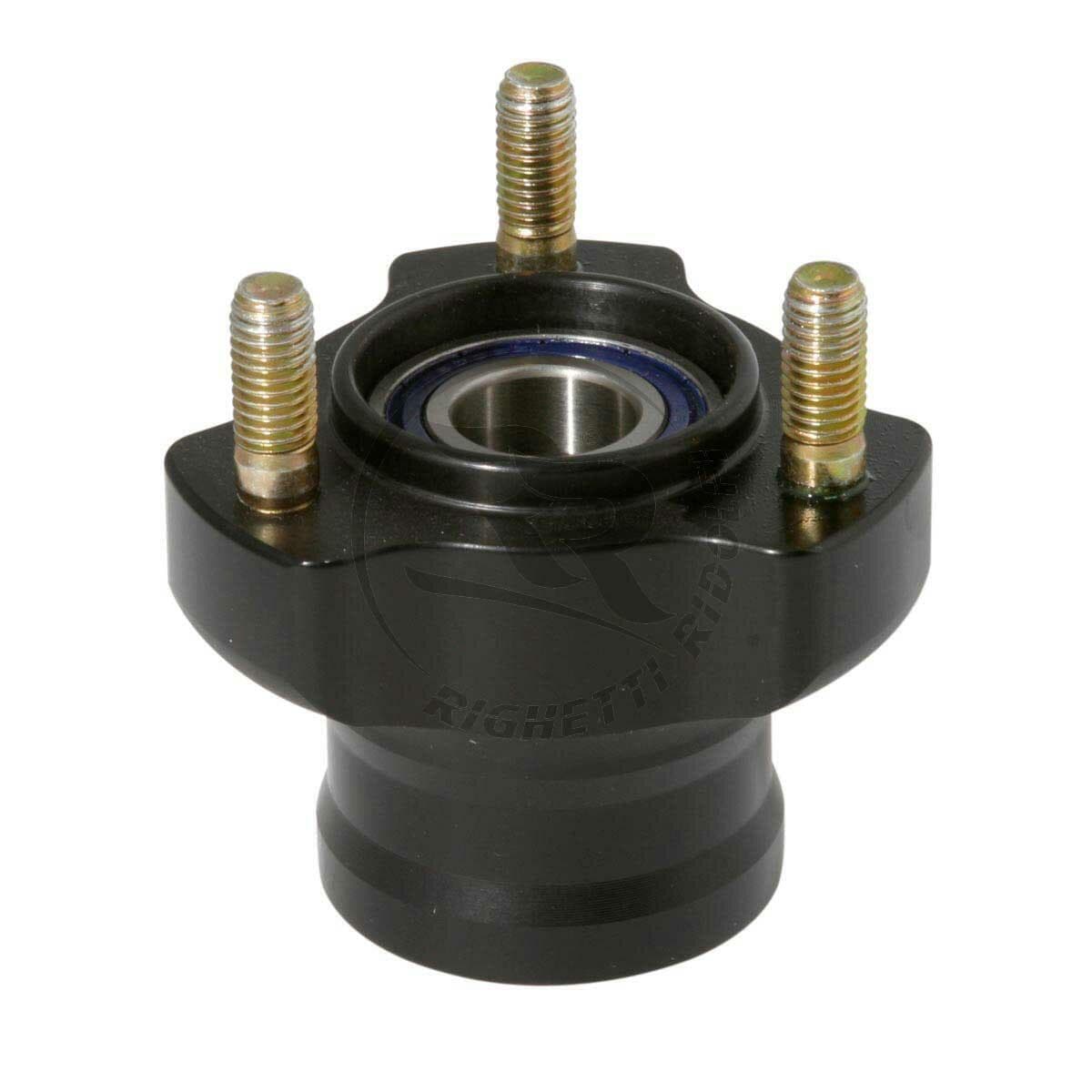

Front wheel hubs are more like this:
They simply provide an interface between the shaft and rim through the bearings, with no radial or axial restraint. This is because most go-kart’s are rear wheel drive, so the front hub must be able to spin freely and independently of the axle.

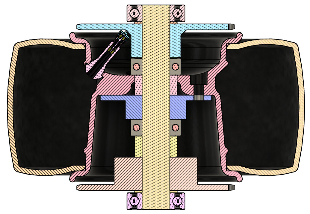

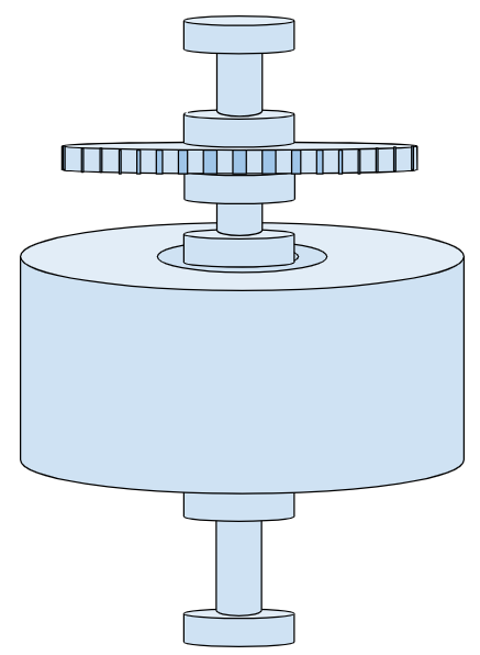

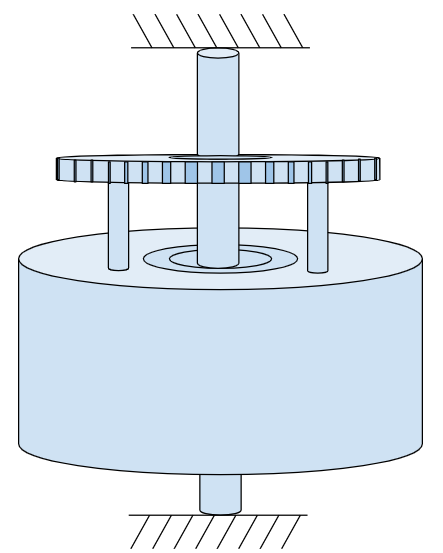

This brings another architectural decision to the table - do I want to drive the wheel directly through the hub or rim like it is done on an ESK8, or should I go with a “live-axle” whereby the shaft itself is driven?
Driving the wheel directly would require a sprocket to be attached via. standoffs to the rim, which I anticipate may introduce stiffness related problems. Alternatively, it could be driven through the use of a custom-made hub but that would be expensive. Either way, all of the radial load transmitted through the wheel would be concentrated at the hub bearings, and the axial load at either the hub’s built-in clamp, separate shaft collars, or spacers filling the gap up to the rails.
On the other hand, driving the axle would mean mounting a sprocket to the axle and finding a robust method of mounting the axle at either end between the OneWheel rails. The added mass of the sprocket hub, any collars and spacers on the shaft, and the shaft itself would increase the inertia that the motor must overcome. Diagram courtesy of my epic skills using the drawing tool in google-sheets.
Although driving the wheel directly is objectively the better solution, given the space constraints I will be working with I anticipate it will be more complex and may even require custom machined parts. Quite frankly I don’t have the budget for that. I will go with the simpler option by driving the shaft. This means I can use COTS shaft collars, sprocket hubs, spacers, etc. which will keep the costs lower.

One remark from old engineer without dream​:face_with_peeking_eye:. Do not forget that chain will become longer after time. Consider this in Your concept. Idler will be needed from mechanical point of view. Not sure how big influence this will have on stabilization. Good luck and welcome in real world. Where managers would discuss with You about compromising solution missing logic and physical principles. Need change my job. Sorry :man_facepalming::metal::skateboard:

That’s a good point, I’ll need some kind of tensioner. I’m already planning to have an idler so the chain sits lower and is less likely to shred my ankles.

Or put motor on some linear guide with tension. Good luck .
