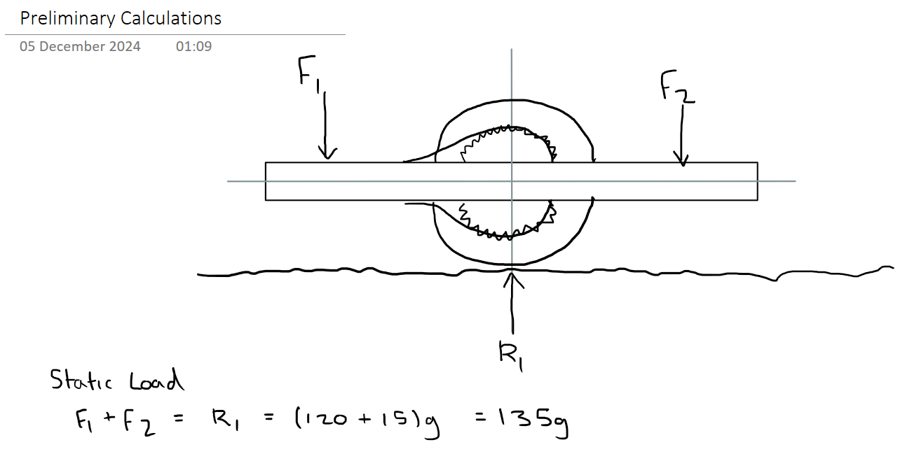

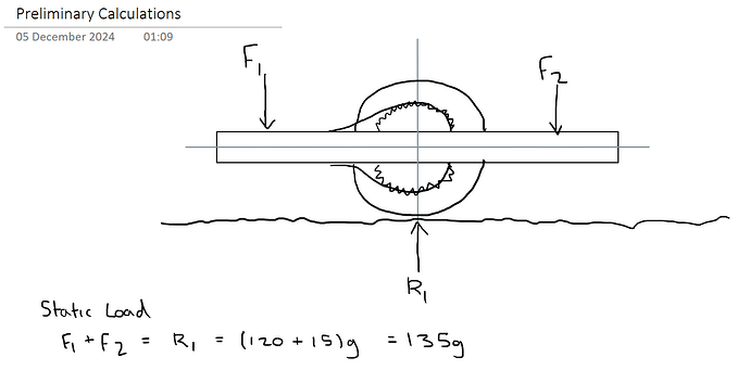

So, I’ve spent some time this evening running a few preliminary calculations…

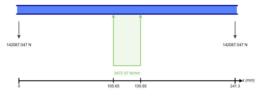

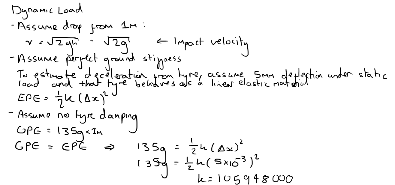

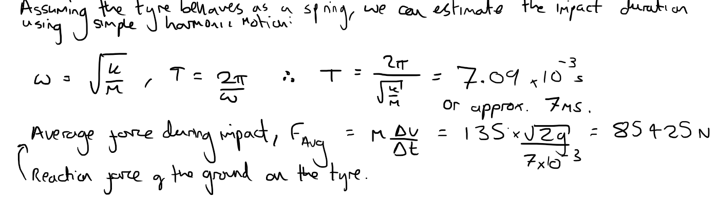

I’ve definitely gone wrong somewhere as I’m getting bending stresses over 1000x the yield strength of steel under my dynamic load case. I’d appreciate if someone could have a look. I suspect it’s because I’m assuming a very short time period for the impact and a very high stiffness for the tyre…
Edit: I also think my estimate for tyre stiffness is far too stiff which is leading to extremely high impact force in the calculations.

I think the nonphysical results are starting with your linear spring assumption. Tires are pneumatic springs, and the deflection of the contact patch is small compared to tire volume, so they can be treated as constant pressure springs. So the force applied to the ground is proportional to the contact patch area, which will grow quickly at first, but become closer to constant at large tire deflections. The linear model you put together probably over-predicts the reaction force.
You also estimated the impact duration using the formula for the natural frequency of the mass-spring system. This would only describe the system accurately if the human body was perfectly rigid, but it’s actually got its own springyness. If I performed a 1m drop with my knees locked, I would also pull a 100g landing and snap my bones. As the rider bends to absorb the impact, they’ll absorb the majority of the energy that would go into snapping your frame rails.
I would start with data about how much force humans exert when jumping, seems to be ~10g for a half meter drop. But those are gymnasts doing stiff landings, so maybe there’s a better source that could match our sport better.
https://www.sciencedirect.com/science/article/abs/pii/0021929088902527
Then once you have a G factor, just treat the frame loading like a statics problem. I don’t think there’s a need to bring kinematics of the tire into it, since the rider has so much more mass and ā€˜suspension travel’ than the vehicle. The vehicle might vibrate a bit as it gets jostled, but compared to its natural frequency, the force of the rider standing on it is a slow-moving boundary condition that it will settle into an equilibrium around. The tire will just smooth out the initial instant of contact until the system reaches the real point of maximum load, when the rider bottoms out their legs.

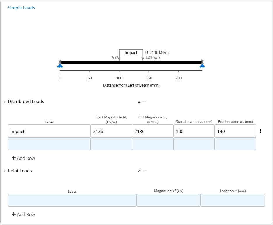

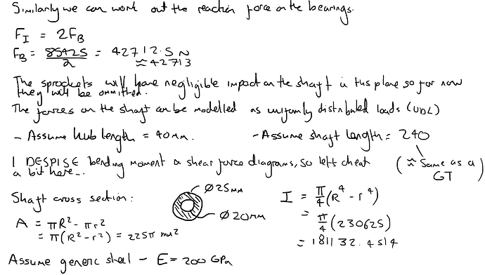

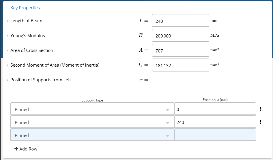

Oh, also you need to set one reaction force in the beam calculator as a roller support. setting both as pinned can produce weird results.

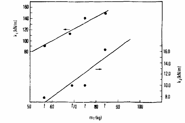

I began by attempting to work out the impact force using the same methodology as the one in the paper you cited:
We can model the human body as a 2DOF mass-spring-damper system, whereby the impact force applied by the rider and Onewheel to the ground is given by:
To estimate k1, we can extrapolate the linear relationship between stiffness and mass demonstrated by Ɩzgüven et. al. which gives us an approximate relationship:
k1 = 2.1m - 26
In our case, m = 135 kg, therefore k1 = 257.5 kN/m.

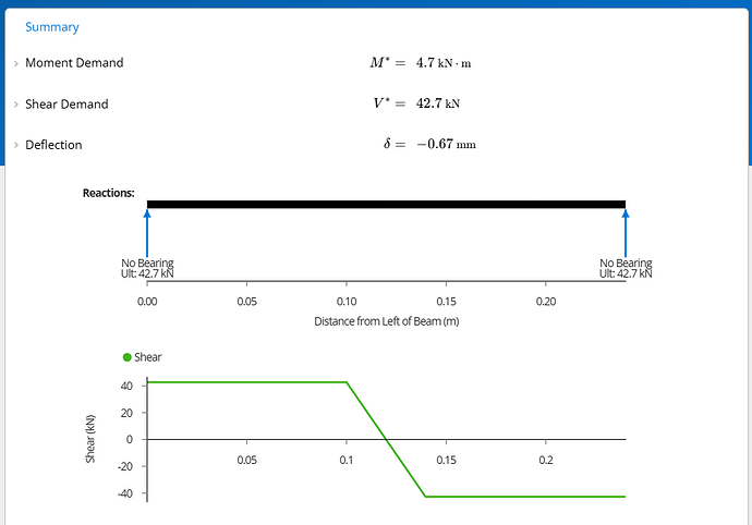

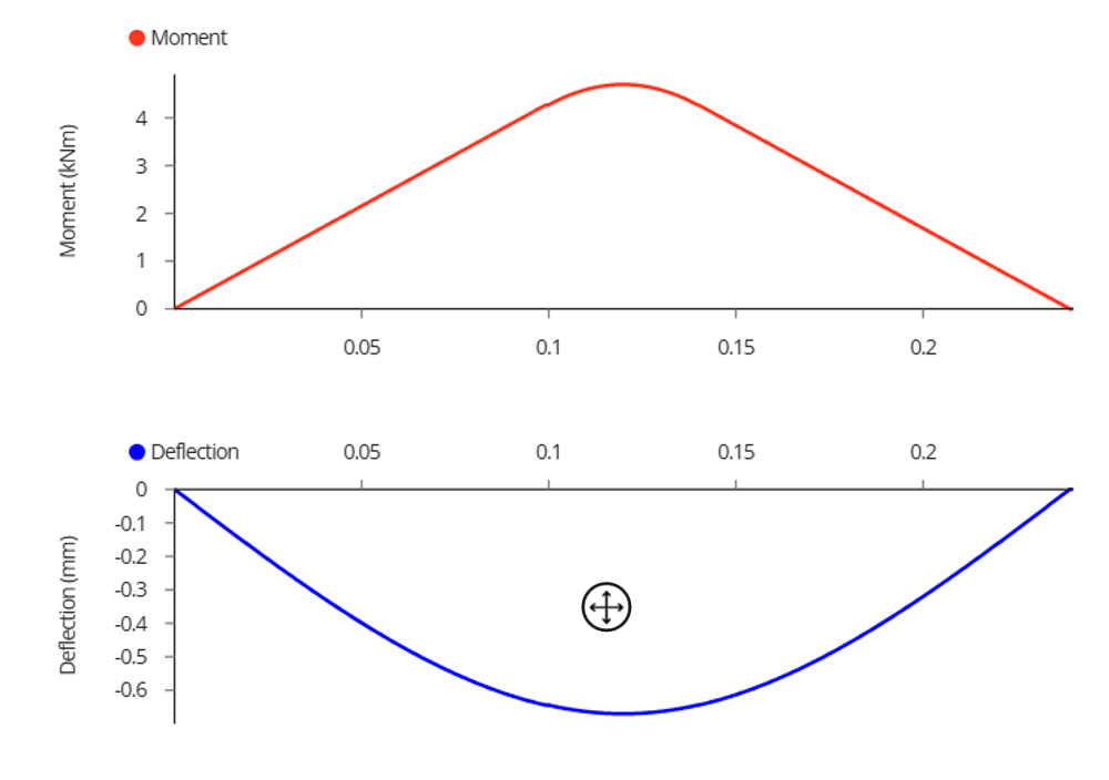

Now we can return back to the beam bending calculations. Using a shaft length of 241.3mm, OD of 25mm and ID of 20mm, we get a cross sectional area of 176.71mm2 and second moment of area 11320.78mm4. Assuming the shaft is made from generic steel, the Young’s modulus is 200GPa. Modelling the impact as a UDL as it is transmitted to the shaft via. the wheel hub:
We end up with a peak stress of 17752MPa which is 68 times the yield strength of steel. This is because the load case is still incorrect. No wonder the shaft is failing if it is subjected to over 2100g’s of acceleration!

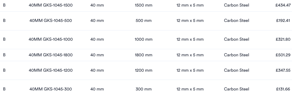

None of the hollow shafts are able to survive the peak impact force without yielding, and only solid steel shafts with a 40mm OD or greater will survive (regardless of the hub length).
A solid steel shaft that is 240mm long and 40mm diameter weights approximately 2.4kg. That’s pretty hefty and is beginning to raise alarm bells as I’m aiming to keep the overall mass of this build below 15kg. To make matters worse, using a keyed steel shaft may end up being too cost prohibitive:

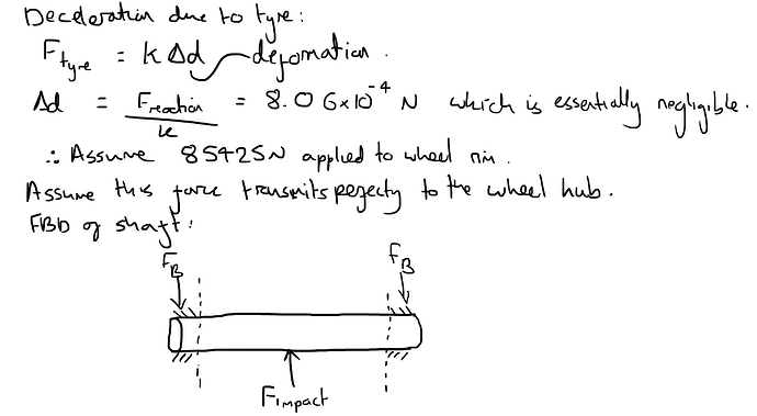

But it probably doesn’t matter since I think you also missed the mark on axle strength. Are you still analyzing it like a bending beam with a load at the center and pinned supports at the ends? If so, I don’t think that it’s a good representation. Your rear wheel hubs bolt onto the rim, and therefore have significant bending stiffness. If the length of axle between the frame rails is stacked up with these hubs, then (1) the load will be distributed, not just applied at the center and (2) the axle will be insulated from bending stress by the hub’s higher bending stiffness. If you stack most of the axle, it will primarily experience shear stress between the hubs and the frame rails.
Chromoly, (or any other similar medium-strength steel) has a tensile strength of ~400MPa. The rule of thumb for steel is that the shear strength is half the tensile, and let’s throw in a safety factor of 2 for good measure. So the allowable shear stress is 100MPa.
Your overkill 20g impact scenario has a load of 26500N in double shear, so the axle needs 132mm2 of cross section, or a 13mm diameter steel rod.
This passes the smell test since my old hardtail bike used 5mm diameter x 120mm axles. If they were under bending stress they would have been destroyed instantly, but the wheel hubs stacked the whole axles, so they only experienced shear, and therefore lasted for years taking nasty impacts.
