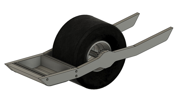

The crossbars between rails will be aluminium extrusions. This gives me a nice cheap and easy solution for mounting the footpad on top as well as mounting a 3D printed enclosure to house the electronics.
This is a really rough mock up of the aformentioned printed enclosure:
There will be a gasket around the top edge and the footpad will also act as a lid for the enclosure.
I like the way this is going. I’m debating making both of the lengths of extrusion 2020 to give me more room inside for the electronics but we’ll see. Ideally I’d like to keep that 2040 extrusion close to the wheel to counter any torsion in the frame.

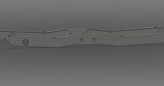

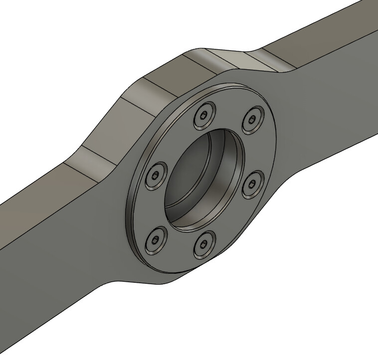

Biggest concern right now is routing cables front to back. I think I’ll probably copy @lock approach. I know I said I would route them through the rail, but I’ve decided to replace the bearing retention circlip with a plate to simplify machining for my friend who will be making the rails:

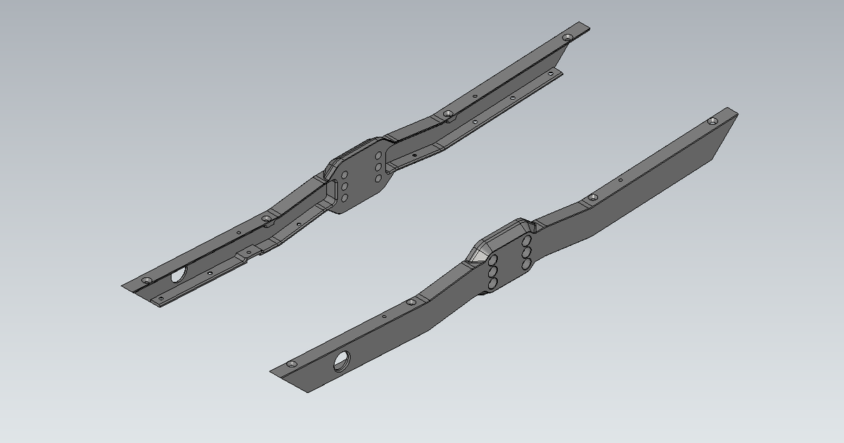

Also the keen eyed among you will notice I’ve changed the shape of the rails a little. Nothing major, mostly aesthetic:

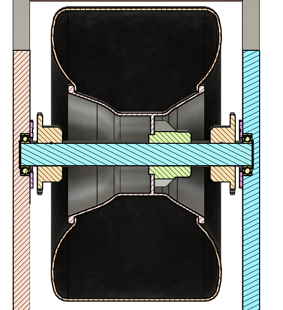

I’ve also made the axle longer. After modelling the tyre with dimensions more accurate to what I have to hand, it’s now 220mm long to give plenty more chain clearance, making the total width of the board 234mm which is just where I’d like it to be.

I bet over the course of this many times you have considered making one/both of the rails super thicc and hiding the chain drive inside the rail sorta (huge cnc cost if 1 part rails and not sheet metal fab or other)
Yeah I have considered many options for making XR rails wider while somehow needing minimal mods to bumpers, footpads etc stuff that is annoying to make also readily available. Normally this would just be to fit 20S2P huge battery (gt-box) packs on “XR platform” Only need an extra 5mm-10mm max or so in width. That extra width in this case would help a ton with getting the chain away from the tire sidewall.
I see your custom rails so far don’t really have footpad and bumper holes market yet. Do you want CAD models of other WTF style XR rails? you could get the hole pattern and try using some of it.
After writing I did see this topic you did cover. I imagine putting the cross bars in the right place would allow XR footpads to be used. If you end up with flexible footpads on this thing you may have a metal plate over this area so that might be something to consider any advantages you could find in it.
