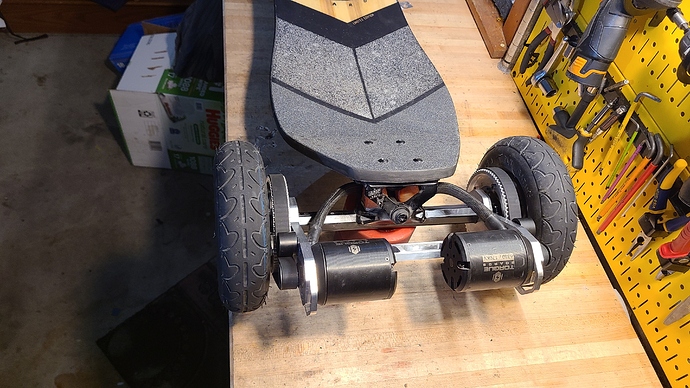

Ok…
So going back to belts…
There were no actual issues with the chain set up.
Worked fine.
But for whatever reason the vibe of the chain did not seem right for this board so the noise and look started bugging me.
So again… No real issue I just wanted belts on this board.
The original issue was the belt skipping on the 12 tooth pulleys so to go back to belts I needed mounts with idlers.
So I went with the IdeaTB v7.8 with the fixed crossbars.
Again @IDEA gorgeous work.
Also using IdeaTB 72 tooth pulleys which is what was on here before the chain.
The IdeaTB mounts are a little bit longer than the EBS ones.
The EBS mounts performed really well and never budged. They have 4 set screws vs just 2 and a larger contact patch on the axle.
So they are really nice but no room for an idler.
The IdeaTB mounts assembled easily and I think they look pretty nice.
So I am happy with the look of the board.
But I still need to take it out to see how the belt and idlers will perform.
I am curious How efficiency will change if at all.
Chain was better for a few runs and then ended up at 30wh/mile like the belts were.

So as per usual a couple hiccups.
Yet another board that is too low.
What would Jesus do?
Do I slap some giant risers on here?
Do I move the trucks to the inner holes?
Do I shit can the whole idea?
Do I do a whole different build around these bearings?
Fuck a duck.
Jesus would get adjustable baseplates :rofl: but dude so cool though :star_struck: @kook :arrow_up::arrow_up::arrow_up:
Dat’s a LowBoy Raph!!!
:eye: :eye: :dash:
Do you have any riser/rubber pad? That’s low, but that’s the Haero’s specialty. Inner holes should raise it up a bit, but I thinks you’ll need more. Would be nice if the enclosure was at the same height as the hanger…
Yeah.
I think what I will try next is both moving it in and adding another of the regular MBS riser. I have one riser now on the outer position.
I wonder if that will be enough…
