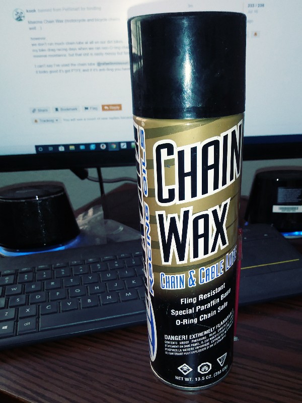

If they are freshly lubricated give them a few rides before they sound louder and chainier. Mine are always nice and quiet before t’s dry. Is that WD40 bike lube? Might have to try it.
Looks good.
It is this stuff…
I don’t do bikes… So have little experience in chains and such so it was a random impulse buy on Amazon…
https://smile.amazon.com/WD-40-Bike-Lubricante-condiciones-desengrasante/dp/B0183G40AI/ref=pd_bap_m_rp_1/138-1327284-4907717?_encoding=UTF8&pd_rd_i=B0183G40AI&pd_rd_r=e39c6947-9f89-4708-a8fa-f85f87708565&pd_rd_w=IUcPQ&pd_rd_wg=ENgYy&pf_rd_p=880cb9e9-f924-40f4-af2e-67d364af6cfc&pf_rd_r=MAG3G9Q0ZVTT5KMDEJ4N&psc=1&refRID=MAG3G9Q0ZVTT5KMDEJ4N
Do yourself a favour and get proper MC chain lube from Ipone or anti-fling chain paste from Motul.
@kook
What’s your go-to chain lube?
Maxima Chain Wax (motorcycle and bicycle chains… and I use it to lube sk8 bearings, and cables as well…)
however;
we don’t run much chain lube at all on our dirt bikes… but we run O-ring chains… back in my bike drag racing days when we ran non-O ring chains we ran straight WD-40 for minimal resistance, but that shit is nasty messy but fast
I can’t say I’ve used the chain lube @rafaelinmissouri posted, but I looked at its specs and it looks good it’s got PTFE and if it’s anti-fling you have a winner…

So my lube is ok right?

Yeah… Your lube looks fine and dandy… See if you like it…
