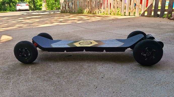

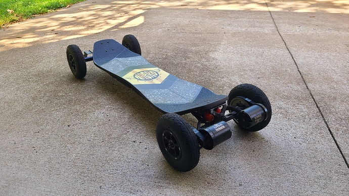

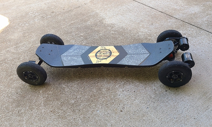

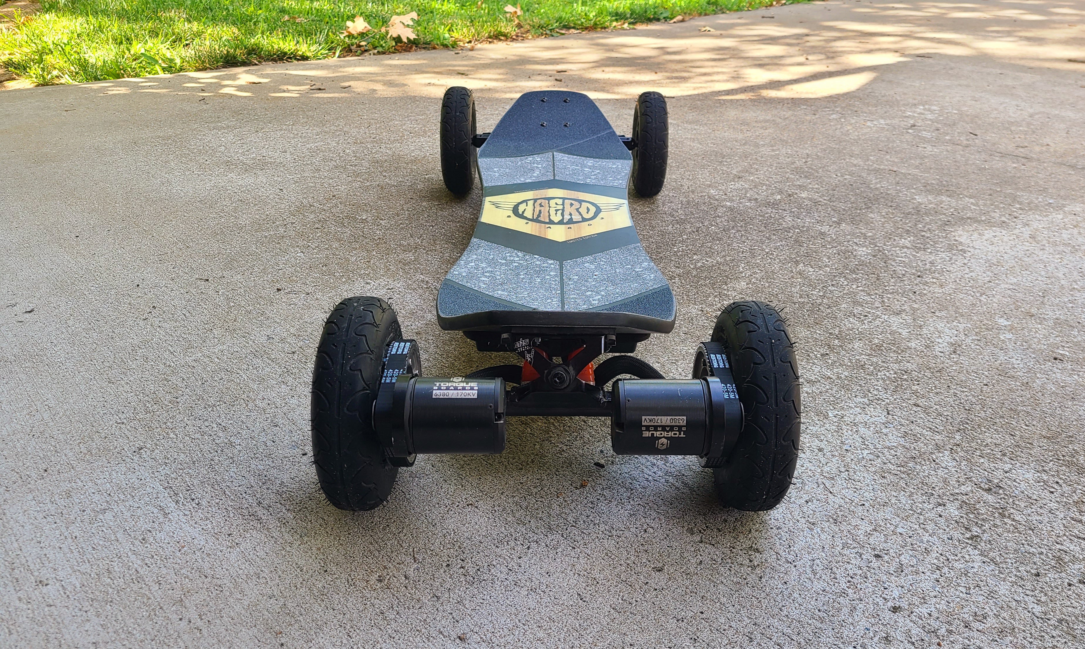

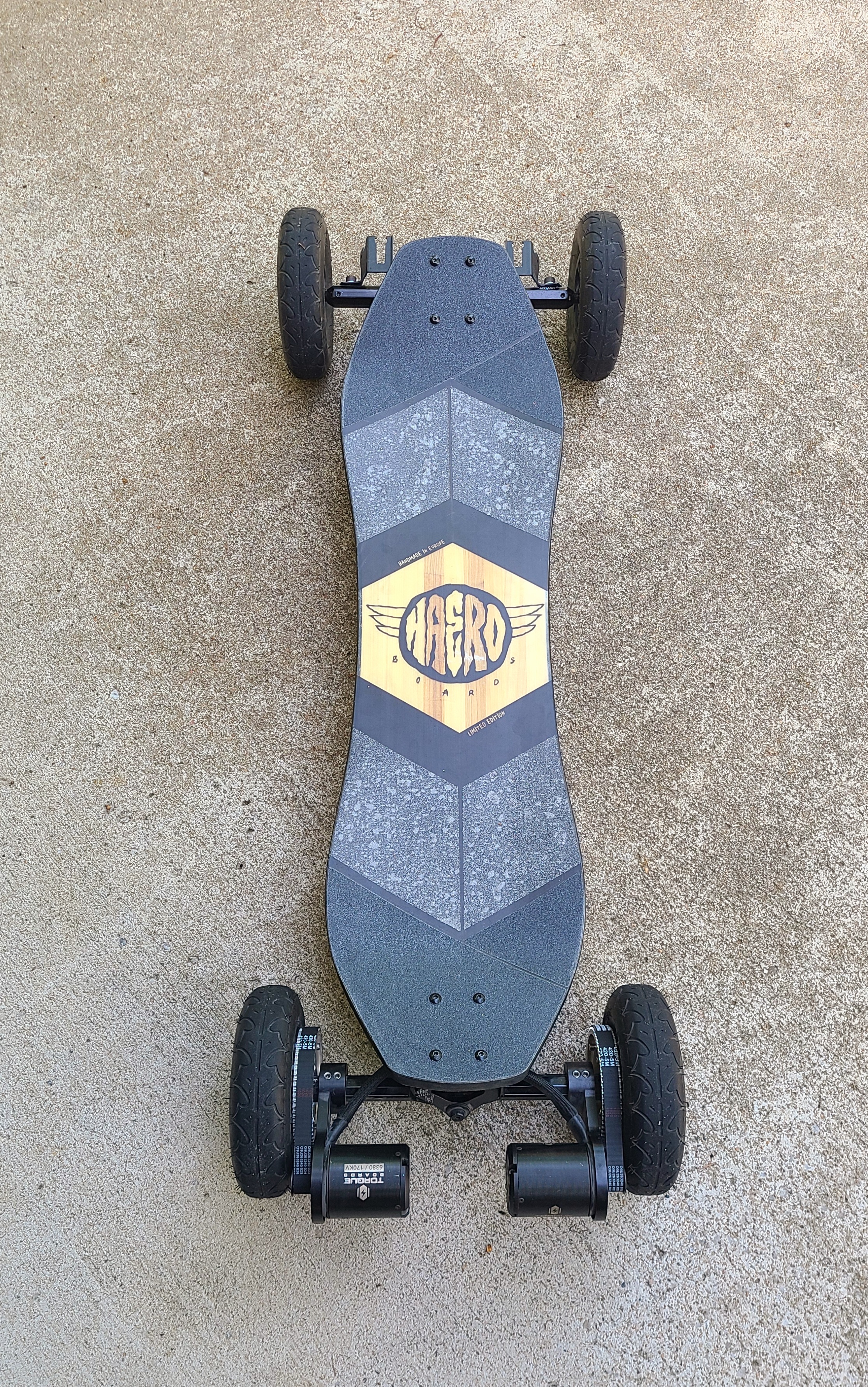

So I thought I would do something a bit different with the Haero and got some little tires to go on there.
https://metro-board.com/e-skate-shop/155-mm-at-tires-tubes-set-of-4-metroboardx/
They look pretty cool right.
I had the highest possible gearing going with the Kendas.
12/72
And I liked it. A bit of belt skipping here and there. But overall pretty good.
Still horrible range at 17 miles or so with really just 14 good ones…
Soooo I thought the smaller tires would do better on range even if I geared down…
So I went 15/72 with the 155s.
Which still resulted in a lower top speed.
But gearing went from 6 to 4.8…
