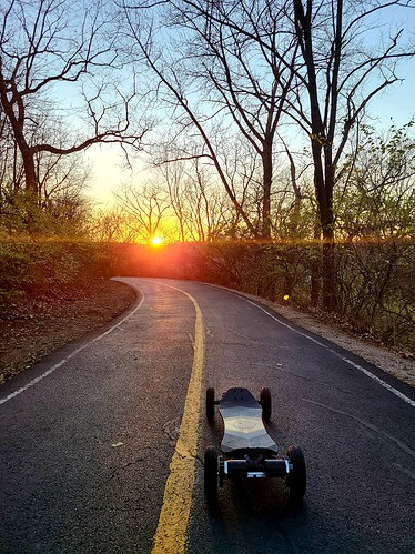

It is raining today so I can’t go actually carve outside. But it looks promising
And I think it actually looks better with these wheels with the trucks in the inner position.

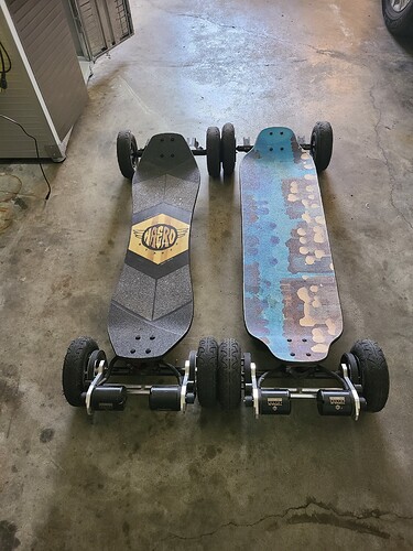

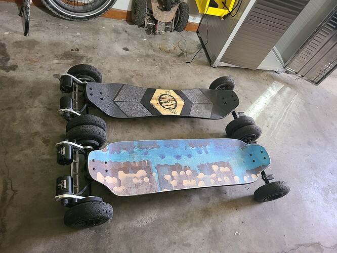

Do you have both the Haero and Khymera on hand? I would love to see pictures of them side by side.
I just got a Llama from Dave.
I’m flipping over to the evolves to test range this week on a board. But in general my range was ok with them.
I just placed an order for both yesterday and will be letting go whichever I don’t use. So just the waiting game. They both said they were in stock. I’ll dm you some comparison to prevent some derail :joy:

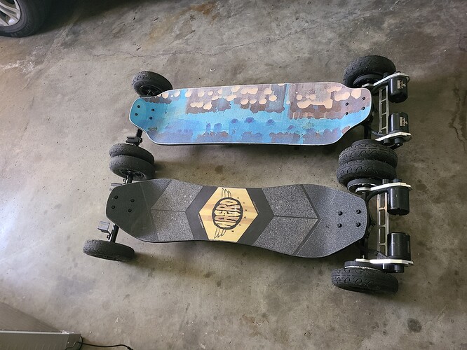

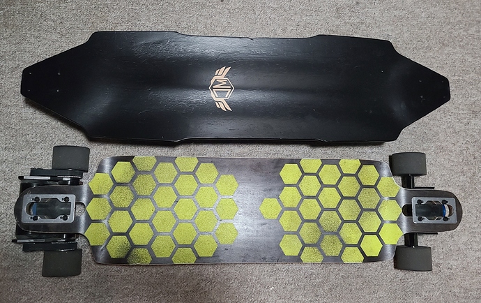

My Haero.
My super sweet and beloved street carver.
It was my favorite set up to ride.
Only bummer was the limited range at 13-15 miles.
I loved everything about this set up.
The power. The cushyness. And most of all the carving…
So much fun.

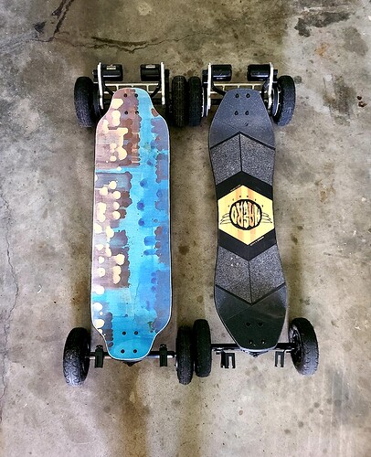

My love for the Haero made me want to make something like it but with more range.
So in comes the Flux.
The Flux was awesome like the Haero, but I could now go 25 miles instead of 12…
So needless to say the Flux started getting all the action. Especially with Winter in the mix limiting riding time.
I would still try to give the Haero love. But it was less and less.
So I started plotting putting a double stack battery on the Haero and was waiting on a good one to come out and was pumped to upgrade the Haero.
But something crazy happened the other day.
I took the Haero out and I have gotten so used to the Flux that the Haero freaked me out because I could turn it so much more easily. I was pushing the back pedals too much and freaking turning weird…
Actually had to turn around and grab a different board to ride.
Freaky…
So I put red shock blocks on the back of the Haero.
Orange in front still.
And took it out.
It wasn’t sketchy.
But the vibe is not there.
The Flux killed the Vibe of the Haero.
I like the giant boat feeling of the Flux is my jam.
I gotta work harder to turn it but I am digging that.
So now I think I’m going to tear the Haero down and put some bindings on it and make it an emtb I can actually lift off the ground.
