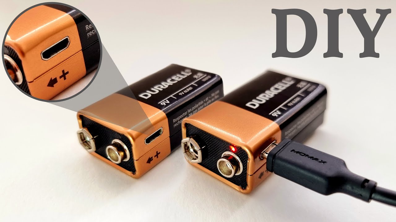

You all need to see this stop motion battery circuit after 2 min in
That’s was pretty cool.
I was today years old when i learned how a 9v battery looks from the inside.

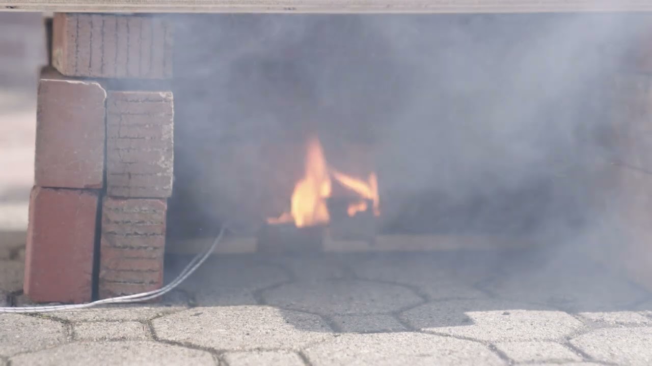

For your enjoyment.
Nice, i have 70 of those aiming at my balls!
Damn, what did you do to them?
Placed a cartridge heater at the center. This was a proof of concept, leading to a much larger test.
