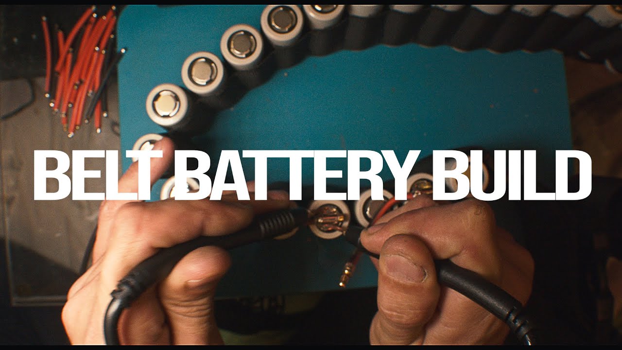

@Battery_Mooch need your review
@Fosterqc, it’s a clever idea but I think it has a couple of issues…
  • Never solder cells, they will get damaged. Maybe not a lot, but also maybe enough to instantly ruin them, we can never know.
  • If he falls then that pack could easily become damaged. I guess he could drop the belt quickly but he’s begging for trouble with such an exposed pack IMO.
  • Fine for DIY, it’s an interesting original-idea project, with the owner assuming all risk but never as a commercial product (if anyone was ever going to try that).
  • Balancing a soldered pack like that would not be fun. I guess he would use alligator clips on the solder bumps? A balancing harness would have helped but I guess that would make the pack even more susceptible to damage.
  • It’s a three-season pack IMO since the cells are a lot more exposed to the elements and would run a lot cooler in Winter, reducing his run time. Inside an enclosure, with the cells closer together and wrapped up, the cells would take much longer to cool off and might never do so once he starts riding.
Big props to the cell manufacturers!
Im amazed that we dont see more fires than we do.

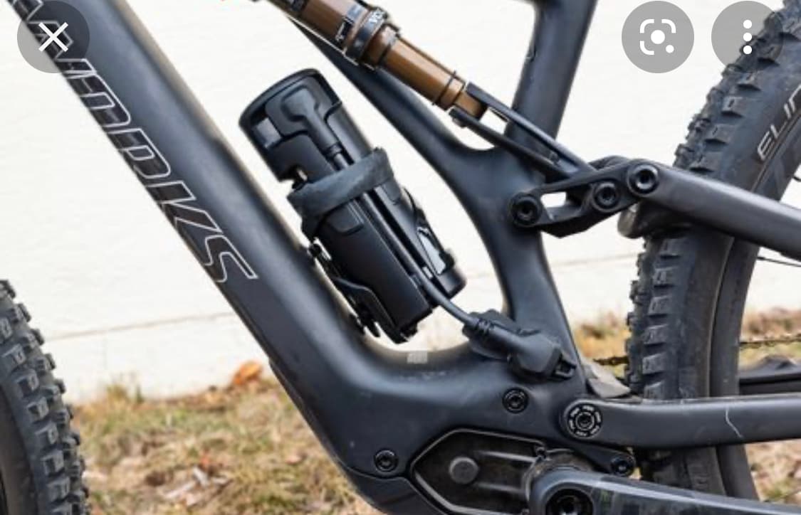

Thank you for your expert comments, What are some battery would you recommend for eBike motor that is 48 V 15 A with good/excellent perf and life cycle?
Depends on the range you want, and the size / weight you have available for the battery.
Base on Levo SL that I have demoed, 480w would yield about 25+ miles 3000 ft elev. this my usual ride.
Most ebike battery spec for approx 500 cycles.
You mean 480Wh I’m assuming. I’m not exactly sure what voltage level 48V motors are meant for, but I’ll assume 12s, which will be a bit above that. I don’t think any cell will give you that much capacity to make a 12s2p work, so you’ll have to go with a 12s3p with 21700 cells, or a 12s4p with 18650 cells. At 3p and a 15A load, that’ll be 5A per cell, which most battery cells can easily provide. So you can either go with whatever is cheapest, or if you want max range, then something like a samsung 50S or Vapcell G50 will be best.
You can take a look at these charts to see what capacity you can expect form different cells at that power level:
(There might be a language barrier here though. If you actually meant that your motor is 480W, then that means nothing. What’s important is how much power you draw per mile, so that you can figure out what total battery capacity you require. Then, based on the total capacity and the 15A you expect to draw, pick a cell that is either cheapest / provides the most capacity at that current level)
Sorry my typo, it’s 480Wh. Levo SL ebike has 320whr inside the tube plus an extended 160whr piggy on when needed.
Thank you much for the info! It’s a big help.
