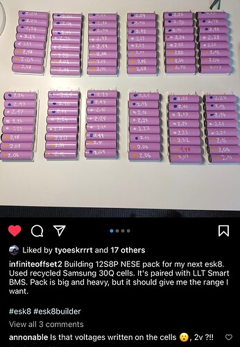

Just finished up this battery for @Boardnamics Flux build! If you’re going to Esk8con, catch him gettin the miles on this 12s8p P42a.
I bought those for my next pack, should be able to tell you soon how they perform (in 10P).
Is he on this forum?
@infiniteoffset2
Are those cell voltages? That’s not good…
Right?! I feel obligated to try to stop him.
I really hope he doesn’t parallel cells that are at different voltages. Please mention something about this.
